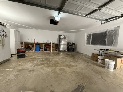

Finally I have my own garage to do as I please with!! First was getting 240v outlets installed and various other 110v outlets around. The garage was bare framing when we moved in, I did a bunch of framing and insulation and drywall work and I now have what feels like my very own shop!! Super fuxking cool!
It doubles as my cutless shipping and inventory area so kind of a lot going on but it’s a pretty good size so we can make it work!

Underselling the amount of work you put into that place. Garage came out super nice!
What tig welder did you end up getting? Guess I can’t wear the mig em all shirt anymore.
Haha thanks man yeah it was a ton of fuckin work. Took like a month.
It’s a syncrowave 210! I’m not gonna use it on the explorer much. I got it to make a few cutless products I have in mind
