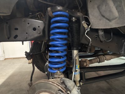

I am determined to keep this 2” drop bracket kit alive hahah. These are essentially a replica of the factory ford stx brackets and avoids doing a c&t. I am not against a c&t, but I am against spending money if I can make my own shit work for free. So I made a new boxing template and got that in as well as some weld washers as I wasn’t 100% stoked on the bolt fitment. I can’t imagine this mount having another issue.
Rear shocks are also a lil bit used… still work and have tons of resistance and wanting to rebound the shaft out when trying to compress them. Rancho rs9000 for the win

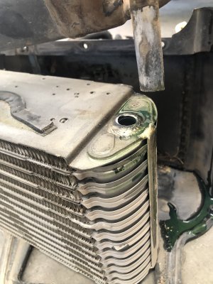

Oh trust me. I’ve just dumped like $3k into my truck just doing maintenance repairs. Initially I took my truck into the repair shop just to have them fix my AC. Then they gave me a laundry list of things my truck needed fixing, totaling $5,500. Fuck that. So I had them fix my AC and I started ordering parts. I’m about half way through the list and I just replaced my radiator. Test drove it and leaks. I couldn’t figure out where the leak was coming from so I took it back in. $1,200 later , I have a new water pump and timing belt.
And all I wanted was some cold air during the last part of summer. Ha!

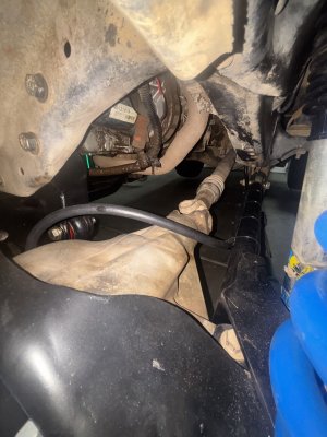

The hoopty is back together with Energy suspension poly pivot bushings, mounted the brake lines since it always flopped loosely. You’d think I’d do custom lines or atleast stainless soft line, but nah. Ran a new vent line up the radius arm to above the frame rail to hopefully keep water out. Both diffs fluid changed, brakes too. It also got the rustoleum sponsored clean up, and by sponsored I mean purchased. Crazy how much better things drive when they are not blown out like an only fans model.

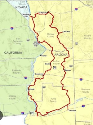

I am running a solid part of the Arizona Peace Trail next month from Wikieup to Salome, so it’s pretty much as ready as can be. Now I need to start getting the tools and what not ready.

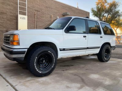

Been through a few of them in my day. This one is my absolute favorite though.

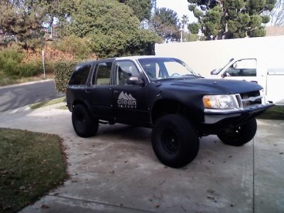

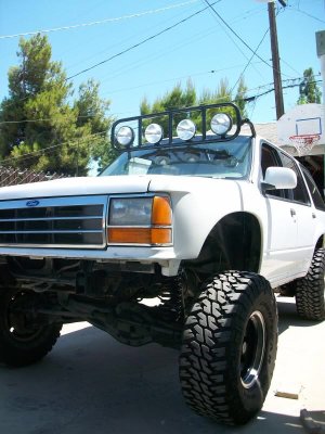

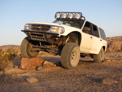

My first car was an explorer, so the love has always been there. 93 4x4 i had built from stock over the years, which evolved like everything. I might be wrong but @NODNARB did my 4.5 over ttb on coilbuckets, and I think it was his first ever?IMG_2582.jpeg

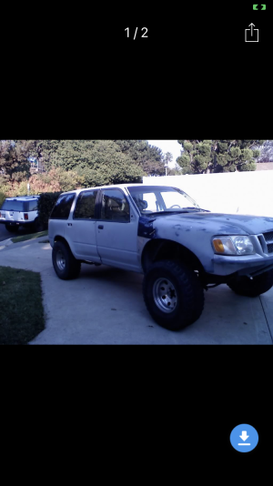

2wd, McNeil built with with equal length beams. Picked it up as a total basket case, rattle canned it and put some wheels and tires on it and made it fairly cool looking.
