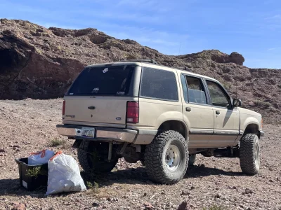

I lied, I didn’t give it a once over yet. Instead I took it out again this morning to clean the desert. When I was out this weekend I came across straight bullshit at a spot and I couldn’t stop thinking about it. I went back out again this morning to clean it up. I only had so many bags and so much space, but I was able to pull 6 bags of trash. Kinda wanna make a truck bed trailer to pull out to these places to clean.
