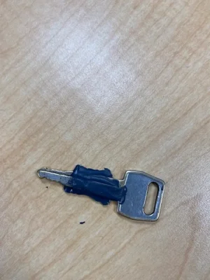

I did break the only key off in the ignition while out at the event. Had to drive it around with a screw driver to start it for a day. Took me like 45 min to get it out the other night.
Put some JB weld on here and then mushed it between two pieces of tape. Going to try and get a few copies made today during my lunch.
Got a new key made. They made the key too long so it doesn't work on the doors but it works for the ignition. I'll call it a win for right now.

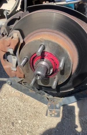

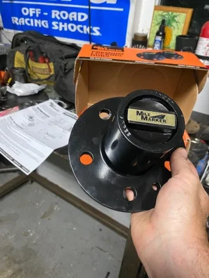

Next on the list is to order a new Hub. I pulled it off the other night and she gone.
Looks like Warn had discontinued the hubs so I've ordered up some Mile Marker hubs. It's a good time to pull the bearings, clean, and repack or replace them.

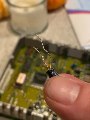

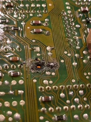

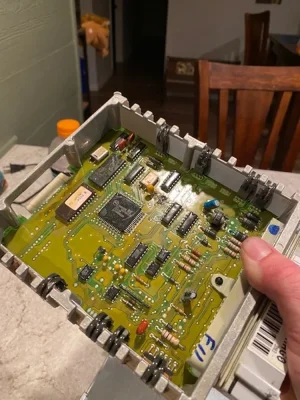

Next on the list is the Computer again. I ordered a replacement computer online but I think something is wrong with it OR the Security system fried something on it. It'll run fine and not throw a code until it goes into Closed loop. Once that happens it turns itself off but leaves the fuel pump on and running having it make a weird noise.
On the original Computer I tried to replace a few Capacitors. I got one done but the second one I can't get the solder to stick. Maybe I screwed up the board? I'm pretty terrible with a soldering iron haha
I need to get this thing smogged soon... Probably just going to buy another replacement computer and hope that gets me going.

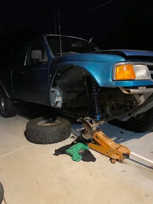

Last Friday I got some new parts in and went to work after my daughter went to sleep.

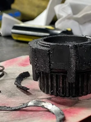

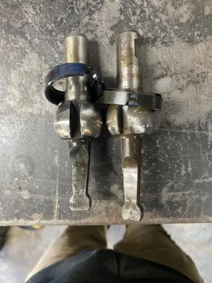

I ordered a new Computer (again) and I ordered some Mile Market hubs because Warn stopped production. After pulling apart the broken hub I noticed it was missing some parts that at the time I had assumed were broken into small pieces of metal. Went to my old D35 bin of parts and found what I needed for the Passenger side.

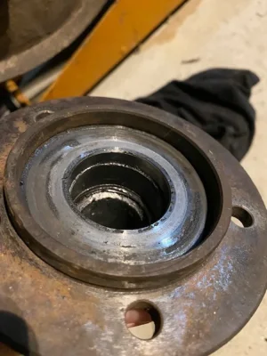

After spending about 1 hour cleaning up the bearings in gas to get all and any metal out of the bearings, running the hub on the lathe to get the old inner bearing race out (welded in there) installing the new bearings, and a quick nut and bolt. She was ready to rip for Saturday on Halloween weekend in Ocotillo... Or so I thought.
The next morning I figured I'd better look at the drivers side before heading back out. This turned out to be a wise decision... this side was missing parts as well. It was missing the retaining washer and c clip that holds the axle in place.
I had the C-clip but I did not have the retaining washer. So I found a washer that had the ride OD and went to work on the lathe. Opened up the ID to fit and we were back in business. This took way longer then it should have with a 2 year old trying to help.

When I was putting the wheel bearings back on the night before I had a slight feeling that I had over tightened the bearing a tad bit... After 10-15 miles or driving I pulled over to feel the hub's on both sides to see if I had. The passenger side was slightly warmer then the drivers but not really hot to the touch so I pressed on.
By the time I got to Ocotillo and was able to drive consistently at about 70 I pulled off one more time before hitting dirt to check out again... The passenger side was FOR SURE hot to the touch.
Shit.
Pull out the tools, jacked up the tire and went after readjusting the bearings again. Took about 15 min.

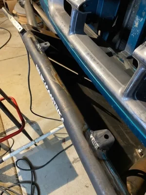

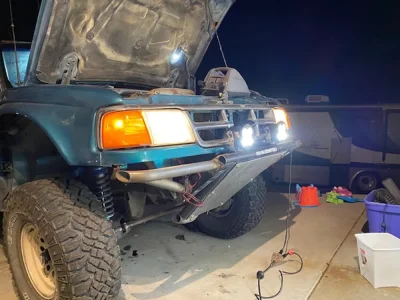

A few nights ago I had bugger welded on some tabs for lights. Luckily I've had these XL pro's in the Garage for about 4 years. Figured they'd work out better if they were on a vehicle. I ended up just wiring them into the factory Fog Lights. There is already a switch in the dash and wiring ran to the front bumper. The only thing I don't really like is that you have to have the headlights on to run them but for ease of install it was way worth it.

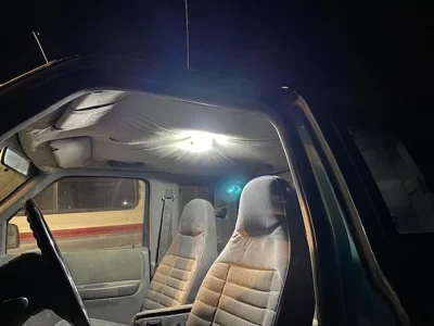

I also had a bag of LED lights from my Camper Build. Luckily they are the same type of lights that were all over the Ranger so I started replacing all of them I could. 3rd brake light and bed lights, License Plate light, Interior & finally the under the hood light.

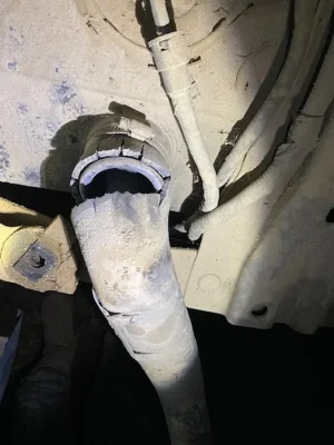

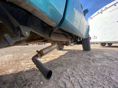

Exhaust fell off.
Had a fun little rip to Ocoitllo without the kiddo to hang out with some friends - @Motiracer38 & @Cleandezert

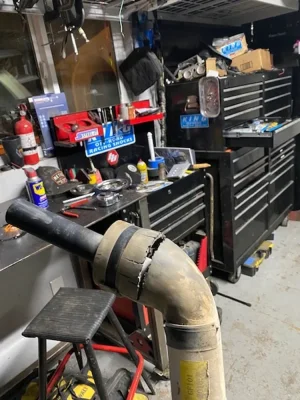

When I had pulled into Brian's Camp someone drove by letting me know the exhaust had fallen off. I replied with: "is that bad". They didn't laugh or get the joke. I guess most people would be more worried about the situation then myself because I just kept driving around until I found Brian's spot haha.
I whipped out a knife, cut a slit into the rubber that had originally failed and added a hose clamp. May be a forever fix. We'll see.

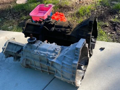

Some notes on the Transmission swap:
2004 M5OD-R1HD Transmission from an SOHC Motor to 4.0L motor - Basically a Direct swap. Didn't notice any difference in performance from the lower gear ratio's through first and third...
Gear M5OD-R1 | M5OD-R1HD
1st
- 3.72 | 3.40
2nd - 2.20 | 2.05
3rd -1.50 | 1.31
4th - 1.00 | 1.00
5th(OD) - 0.79 | 0.79
Reverse - 3.40 | 3.40
There is a sensor on the side of the motor (speed sensor I was told by @the_fablab_ ) that does not plug in. I'm assuming this is a governor of sorts? You can see it in the above picture on the dirty old transmission. It's the sensor with a wire that crosses over the passenger side.
There is an extra bolt hole that is not needed when bolting the Trans back up to a 4.0L Ford Motor

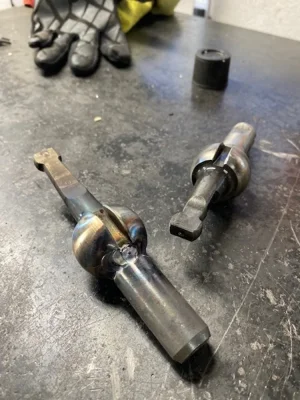

If you don't have the shifter... (like I didn't) then you'll have to modify the Shifter on the M5OD-R1HD to work with the M5OD-R1 shifter. Needs to be cut and re-welded on at 90 degrees.
Why can't you just swap the two shifters? Well because the 2004 shifter is about 1/4" longer that goes into the transmission.
You can see the length of shifter difference in the below pic and difference in the top part of each shifter.
Cut and turned 90* and then welded her back in place.

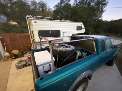

Now it's time to really make this a Prelander with a GFC Tent!

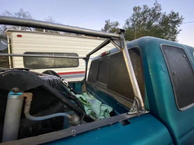

I didn't have any metal at the house on Sunday to really do much else than measure. My wife went out and picked it up this morning (Monday) for me at IMS. What a trooper.
Going to try and fab up something that is relatively strong with tubing that that is probably overkill. The additional weight can only help the rear springs at this point and I'd really like to not see this fancy tent fly off haha.
