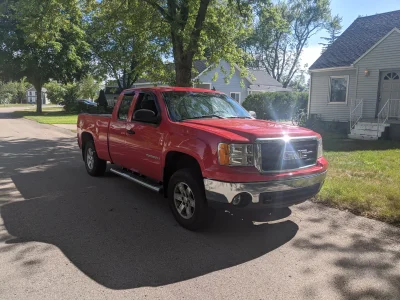

Roci (Short for Rocinante) is my 2007 GMC Sierra that I have owned since October 2015. When I bought her, my plans were originally a daily driver and tow rig for whatever toy/project I was planning on getting or had.
One of my favorite TV shows is The Expanse. Their ship is called the Rocinante(Roci), and she is a legitimate salvaged MCRN Corvette (The legitimate salvage has a relation to my Roci as you see at the end).

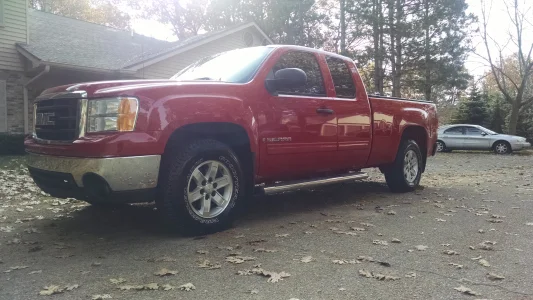

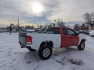

Here she is when I got here, and she remained largely in this state until the Summer of 2020.

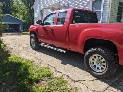

With almost 200K mile on her in the summer of 2020, I decided that it was time to refresh the front Suspension with new Upper and lower controls, a Rack and pinion a set of Bilstein 6112 front Shocks and Springs(set at 2" lift) and a 2" lift in the rear.
About a year later I added a set of Method 301 Wheels and 285/70R17 Falken Wildpeak AT3W.

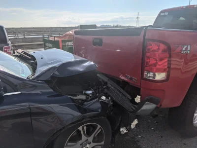

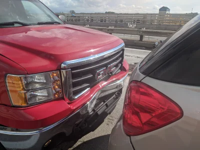

I was heading home from work in October 2021 to pack up to see some college friends in Fort Wayne and do some mountain biking down there to. Less that a mile from my house I rear ended at about 40 mphs...
Roci was still drivable, and I was able to make it home but not go to Fort Wayne. The damage was pretty extensive. $16K worth of damage on a 220K mile truck. My insurance company totaled her, and I brought her back to start the rebuild as a Prerunner....
At this point, I got a new to me DD and started Roci's build and overhaul. I know thatb the hit at there was some frame damage from the hit but there was more hidden...

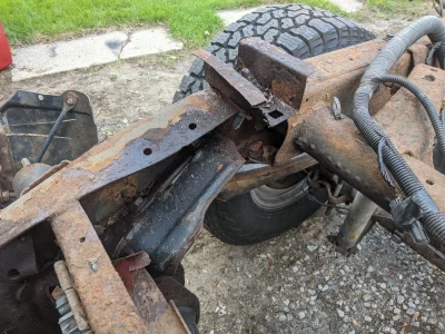

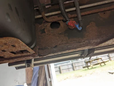

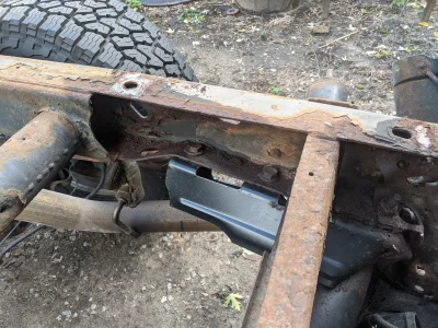

I contacted a local frame shop to fix the frame damage, and I got ripped off and found more damage and rust...

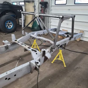

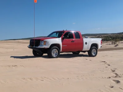

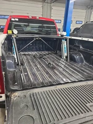

I reached back out to Lenger Racing to see if they were interest in repairing the frame. They found that one of the the frame was shift forward and the frame was still bent. We decided to replace the frame and install a complete Dirt Kings rear kit with King 3.0x16 bypass shocks, a Bed Cage, Deaver U182 and Shackle and Hanger.

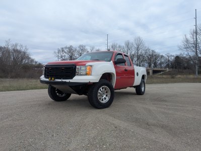

And here Roci is all complete!

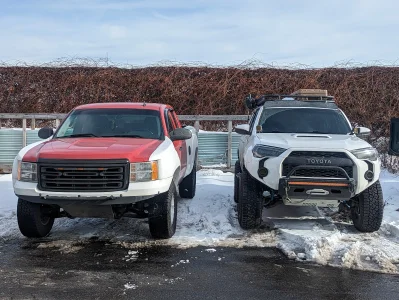

Roci next to my old Boss's Prelander 4Runner.

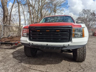

I was able to get a set of Baja Designs Squadron Sports from one of my coworkers that was on a return plate that He brought. I also added cheapo set of amber chase lights and a VHF radio after I won a ticket to a Raptor Run at the Spring 2024 Dune Clean up.
Overall, this is the current shape Roci is in. I have a set of King Bolt-in 2.5 coil-overs with compression adjusters( freshly rebuilt by Lenger Racing) and Icon Upper controls that I will be installing before the start of the 2025 dune season. I blew the Bilsteins at some point last year and I really started to be limited by the front suspension.

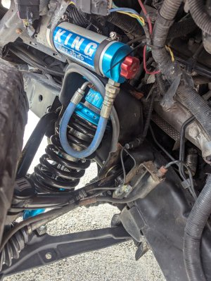

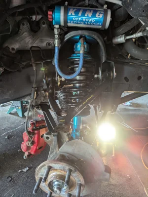

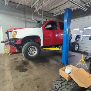

I pick up my newly rebuilt shocks from Lenger after their spa day, and they look much better! The front of Roci was always lower ever with the Bilstein set to the 1.77" height, and I want to raise the front a bit too. I measured at the bottom of both of the Lower control Arm pockets to the ground, and it was 12" to the ground. I was hoping for an overall height increase of 0.75" to have an overall height at the lower control pockets of at least 12.75".

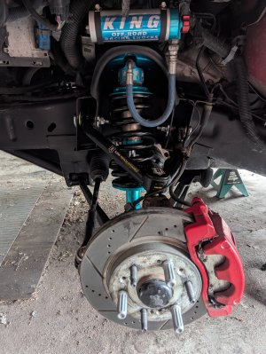

One of my buddies helped me over a few days to get the new UCA and shocks installed. I also knew that the lower ball joints were in bad shape and needed to be replaced, so I ordered some replacement ones. When we were attempting to remove the ball joints, we found out that the old Moog lower control arms did not have replaceable ball joints, so new lower control arms were ordered, and then we installed them.
I spent a fair bit of time looking for info on how to remove the UCA Bump stops on the frame, but could only find a few videos with some people cutting them out with a Sawzall. I used a grinder with a cutoff wheel to cut out the stops and then a flapper wheel to make the cut look pretty.
Here is the front nearly done.

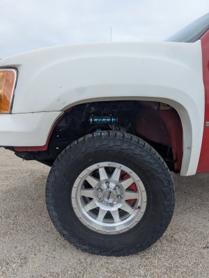

The Remove Reversior peaking out from behind the tire.
All installed and on the ground!
After everything was installed, I measured from the bottom of both of the Lower control Arm pockets to the ground, and the overall height was 14"! I gained a 2" in height, and the truck is much better looking and is nearly leveled now.
I went out for a quick test drive, and the new Kings felt smoother with less jarring over sharp, quick bumps on the local roads. Roci rolls a bit more due to the front sway bar being removed.
