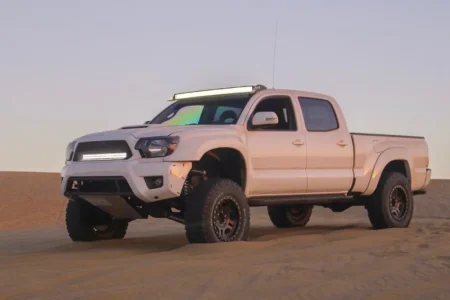

How it currently looks (January 2023) :
Mileage as of (July 2023): 115,xxx
MPG’s with current upgrades: 10-11MPG Towing • 14-15mpg City • 17-18mpg Highway
Supercharger: 13-14mpg City • 15-16mph Highway
Off-road: 10ish at WOT.

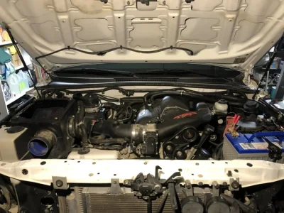

  • Volant CAI with dry filter & filter splash cover
  • Borla Cat back exhaust (Chopped just before the axle )
  • 2012+ air injector pump filter Mod
  • Tacomaworld @mightytacoman Cam Gears installed by Tacomaworld @greenEFSI
  • TRD Supercharger (bought used in 2022 @107k miles)
  • URD 2.85” stealth s/c pulley
  • CSF FJ radiator w/ shroud
  • 160° Mishimoto thermostat
  • NGK LFER7BHX Ruthenium Spark Plugs
  • Chiayi Racing Red Bullet VVT-I solenoids

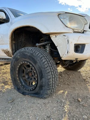

Some of the recent bad lines:
8741A90F-60A6-4234-88EC-6E6B78F1AC21.jpeg CFBAA4FB-D0C2-42F2-8707-64F8EAB52A67.jpeg
Read on to find out more!
So from the pictures I gather that.... Fast motor, big send, Broke a wheel/tire, and back living to living in your mansion haha.

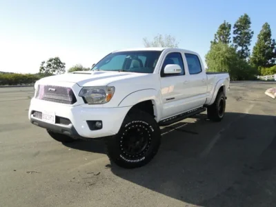

  • FOX 2.0 Performance suspension
  • BFG Ko2 285's
  • Pro Comp 17"

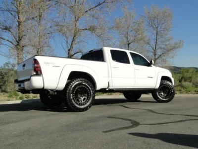

Well, the tires rubbed so I decided on a 4" lift spindle from Amazon and a 2" Wheelers Add-a-leaf. Dropped the coil over pre-load down to 0".
This was the cleanest and best bang for buck the truck ever was. More fun dumb hooniganing with friends and not a single day spent in the shop or with broken parts for about 3 years.

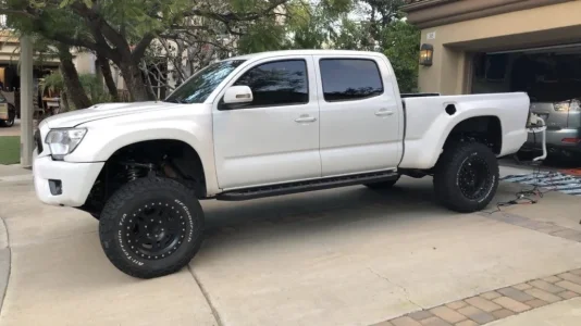

Stage 2: "Finished" > Bolt on LT = Trophy truck

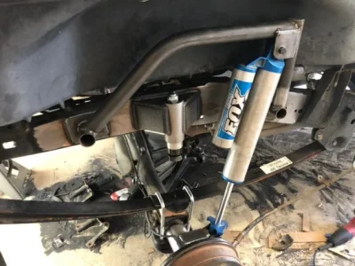

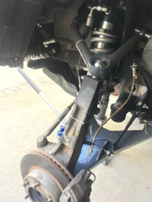

Spring 2018. The OEM control arm bushings were wasted. I worked at a Toyota dealership and the parts guys said they could get me a discount on some cool aftermarket stuff from a shop called Camburg in Huntington Beach.
Picked up their standard 3.5" LT kit for the Tacomas and paired them with the FOX coilovers. Scott who worked there at the time suggested the heimed UCA's and FOXs. Buy once cry once right? Plus, after this, I'd be done. It was complete. Built.

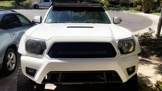

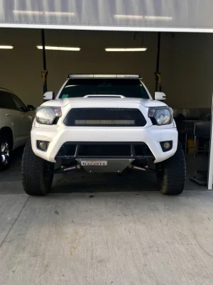

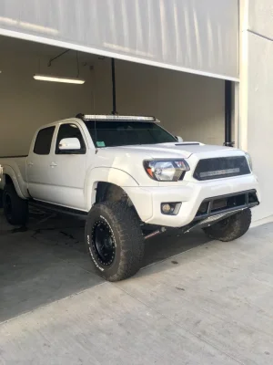

By this time I'd painted the headlight internal bezels black and the one offroad buddy I had said that I HAD to get a roof light bar.

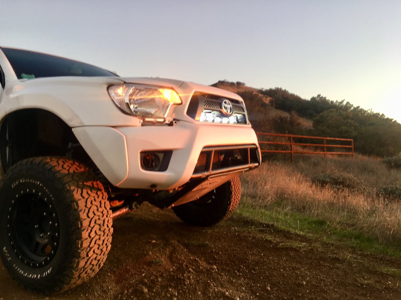

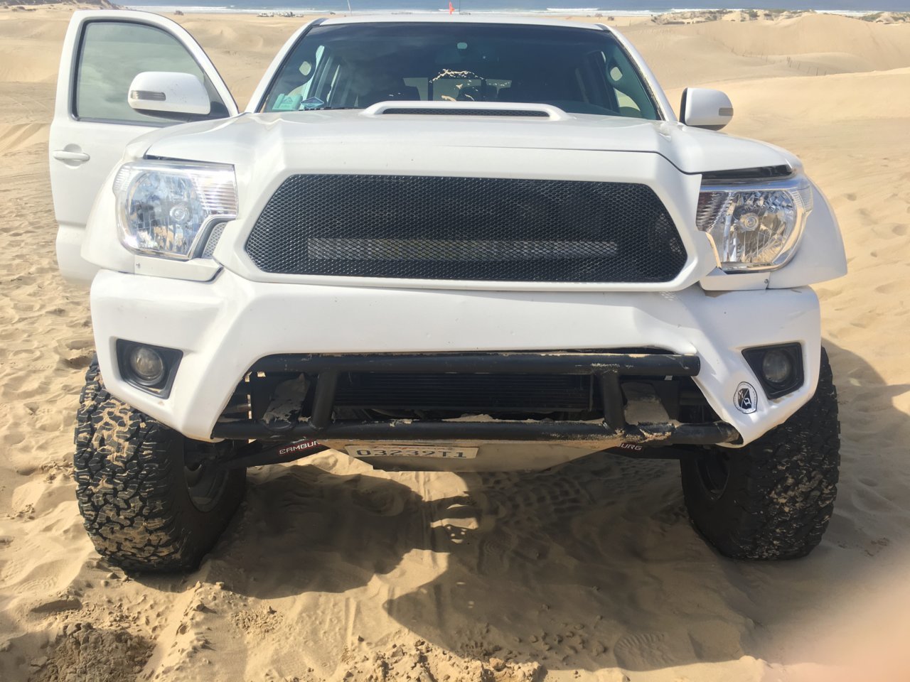

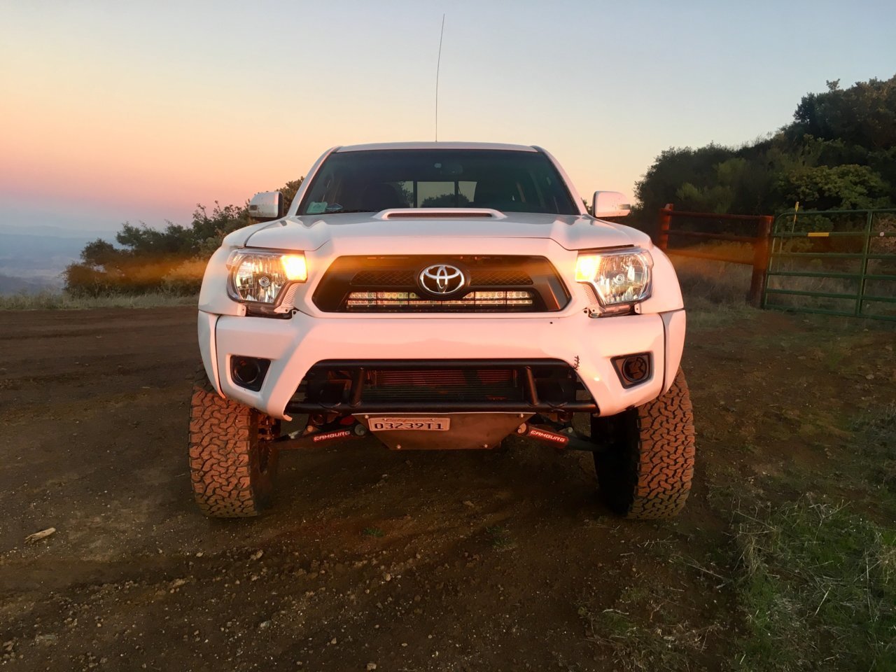

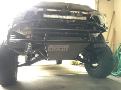

Thought it looked kinda weird with the OEM bumper so I ordered one of the favorite things about this truck to this day.
Anthony at DTF Fab provided his "Type C" bumper. A good compromise between protection, looks, and keeping the truck looking respectable.

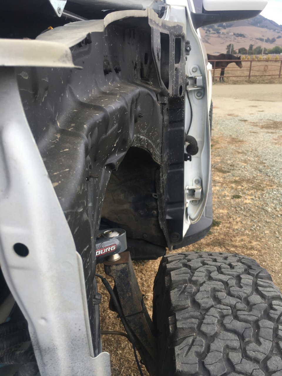

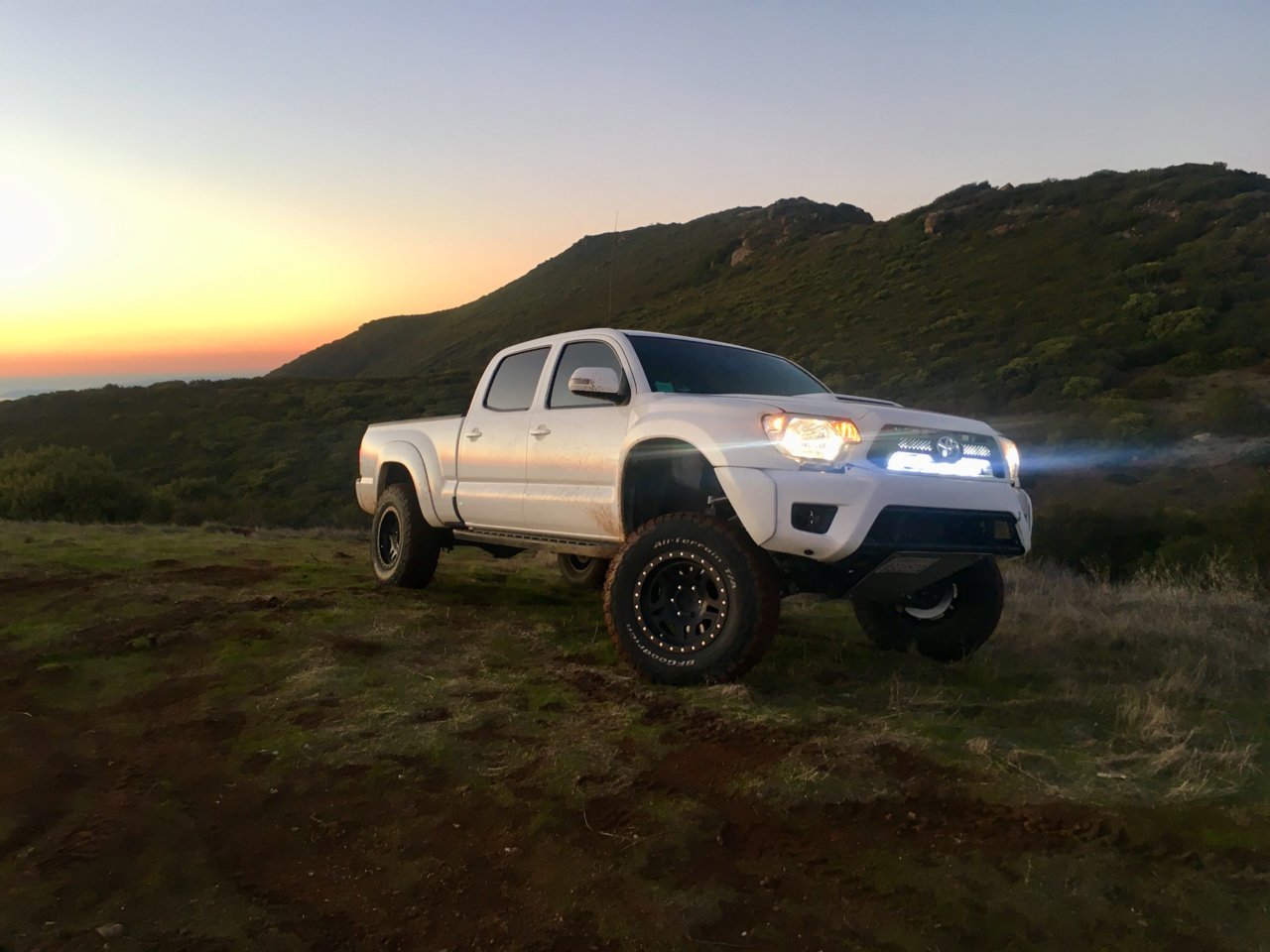

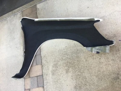

I'd not a clue that I'd practically blow the fenders off the first time I went offroad driving with it.
Got some ADV 4" front glass, painted the core support with satin black spray paint, as well as Raptor Liner'd the undersides of the fenders for hopefully some protection.

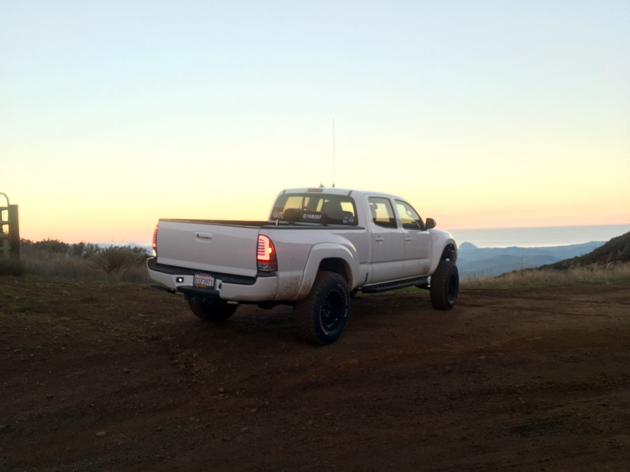

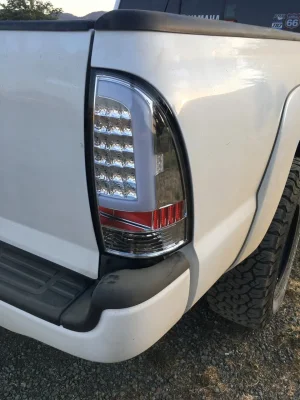

Also threw on some Amazon tail lights because the OEM rear was cracked, and I have a thing for clear(ish) tails.

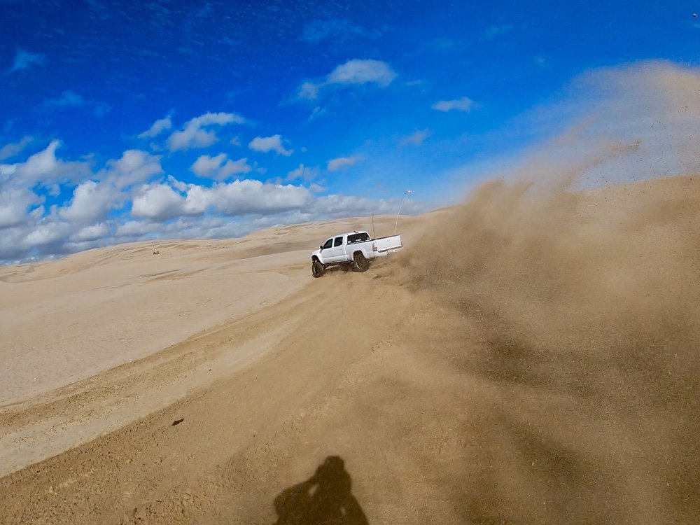

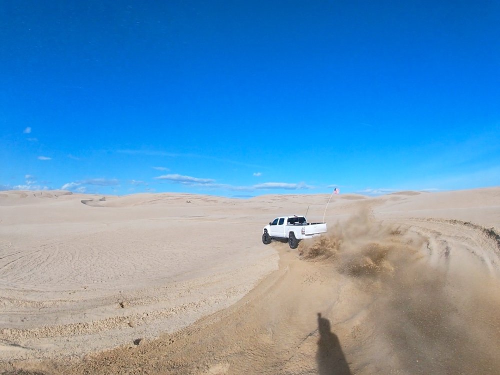

Late 2018 saw a bunch of small trips to Pismo dunes!
Big adjustment to learning to drive in real dune sand.
Found the happy spots at
  • 8-10psi in the rear
  • 10-12psi in the front
  • Keeping it in 1st, 2nd, and a little of 3rd gear.
  • Stop AT THE TOP of dunes and point down hill
  • Keep my momentum up !
  • The auto ECU controlled "LSD" did alright for what it is

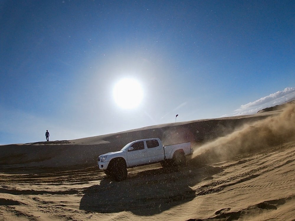

Also met a few guys from the MobArmor crew, they showed me the ropes.
(hint, this is the first bad line)

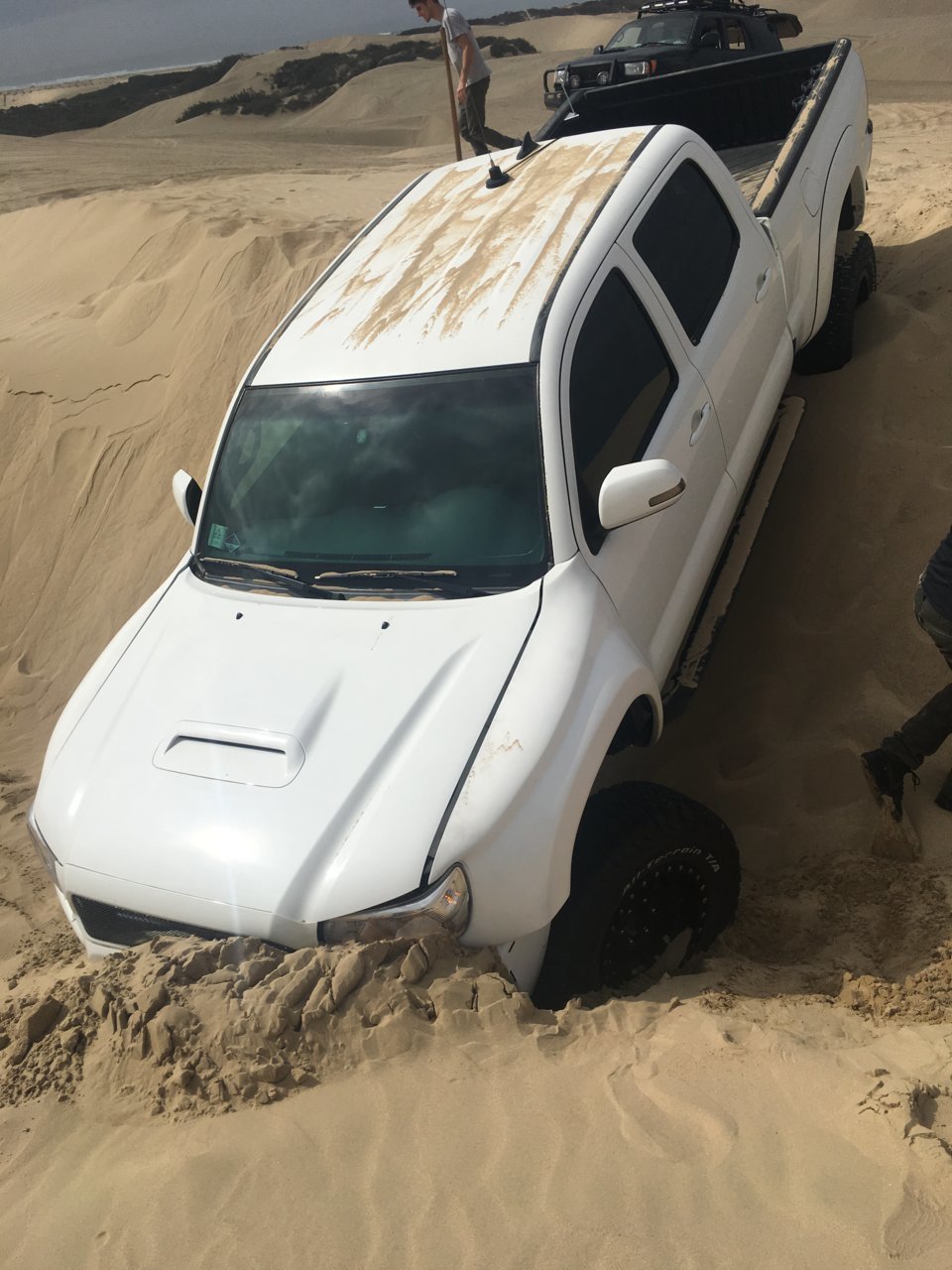

Was cruising around the dune, trying to find a cool berm to blast... BAM there was a witch-eye and I dove right into it. Fortunately, only going about 20mph.

Nice bumper ;)
Didn't know you were on the central coast now.
Hit me up if you need any work on the truck 🤘
It was actually a short stint... :( about a year... But I miss the area tons!
Your bumper saved my truck for sure in the dunes! 100%

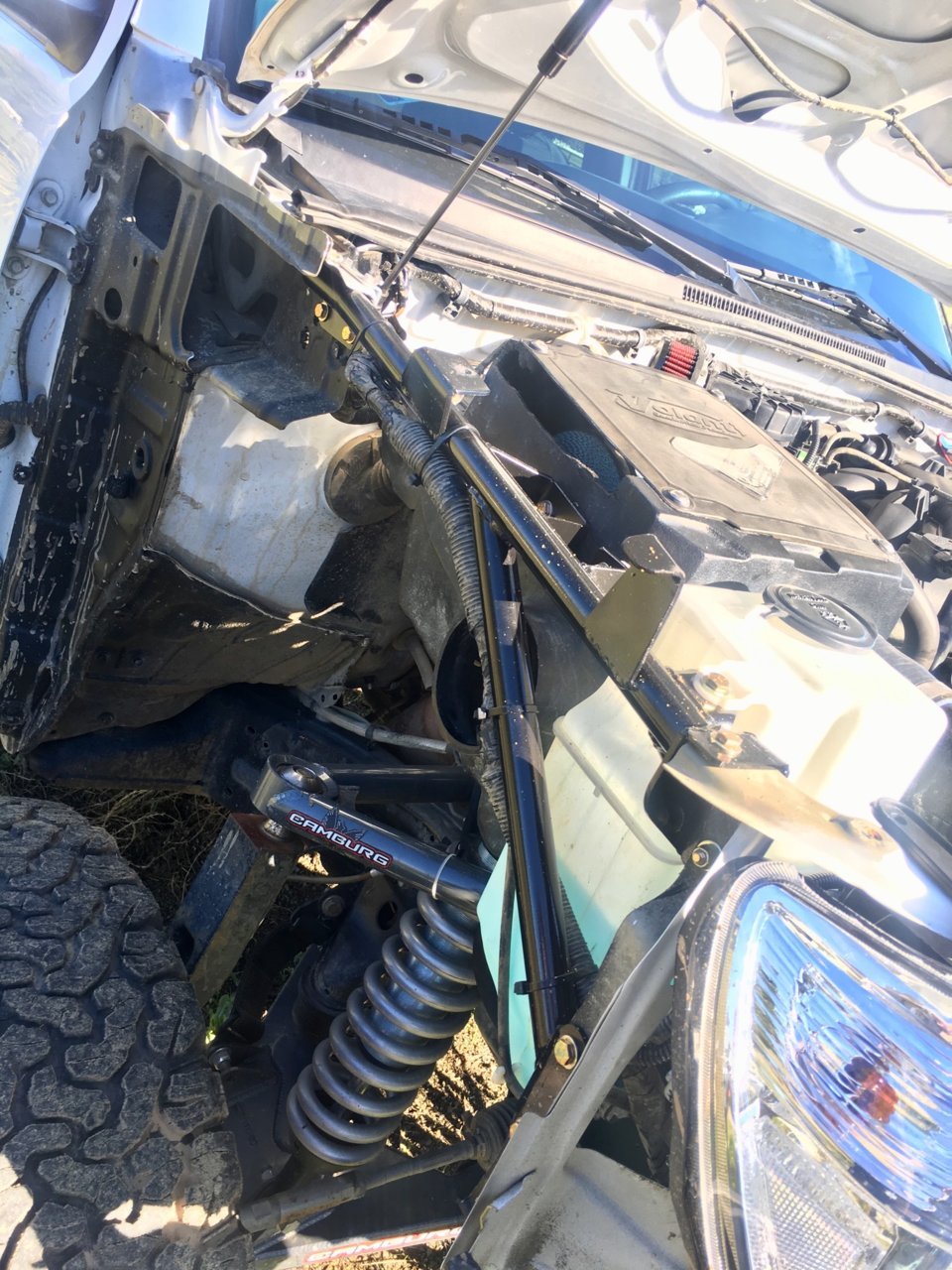

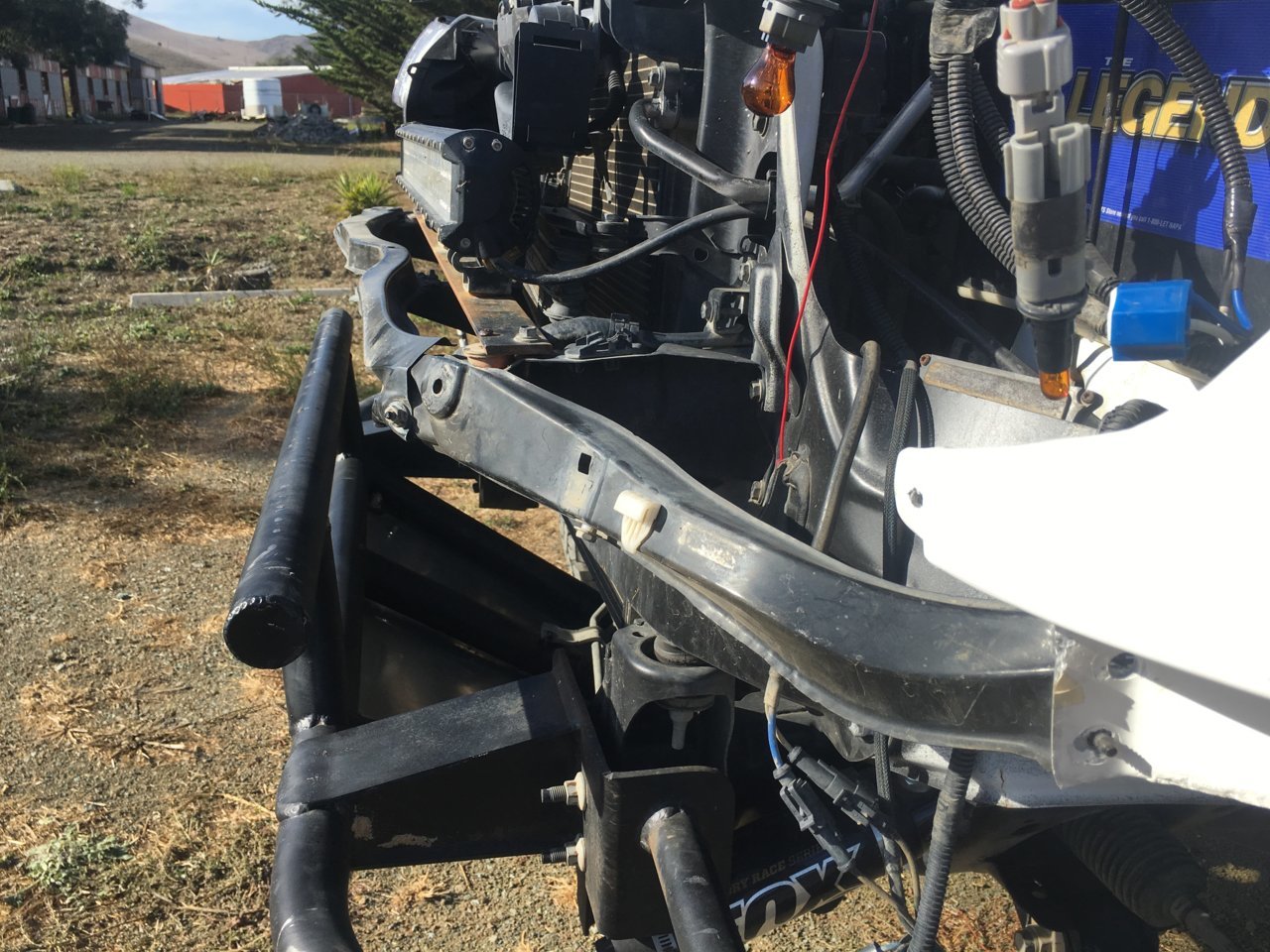

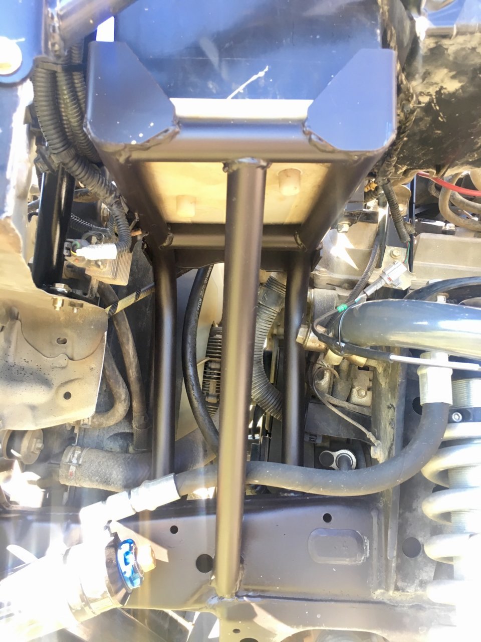

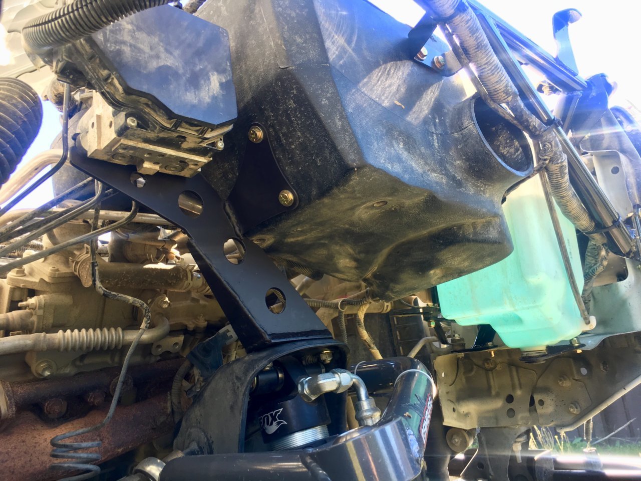

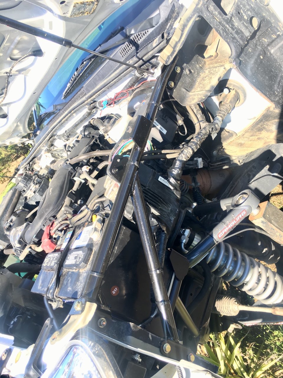

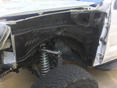

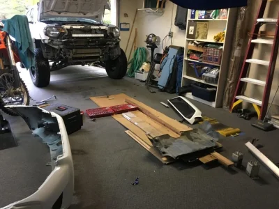

Had a cool dude named Nick Valentine (NV Fab) build me some tube inner fenders, along with straightening the core support as best he could. Remounted all components in Oem location.
Pleased with the work, price, and responsiveness of his shop, would 100% recommend him to anyone in SLO county.
Damaged pictures from Pismo 10/9/18:
Rebuilt photos:
With Oem stuff, the UCA’s were slamming into the sheet metal inner fenders, now there is PLENTY of room for those and larger tires...

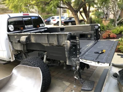

Grabbed some ADV bedsides on the Black Friday sale and threw those on.
I found the bedsides to be easier than the fronts by far on these trucks.

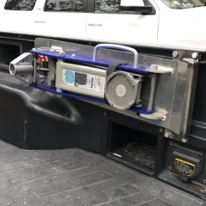

In the picture above, you can see where I have my Smittybuilt 5cfm compressor mounted on to an expedition portal mount where the factory larger bed pocket goes.
Easy install, and has also worked flawlessly for a number of years now. Its got some rust on it from being exposed to some tire and road grime, but still works to fill the 35" tires I currently have.

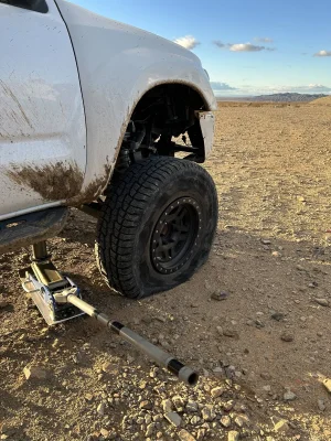

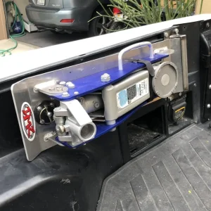

I also grabbed a Harbor Freight 1.5T jack along with DMZ Fab skid plate and mounts.
Prior to this I had no way to get a wheel off the ground out in the dirt.
I used this setup until this summer actually, about three years and a few different scenarios.
I swapped a Pro-eagle jack pad onto the jack and got the taller extension. It went up to about 27" on hard ground, which was good for most cases.
