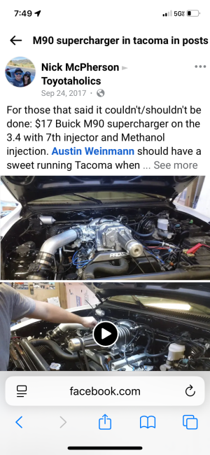

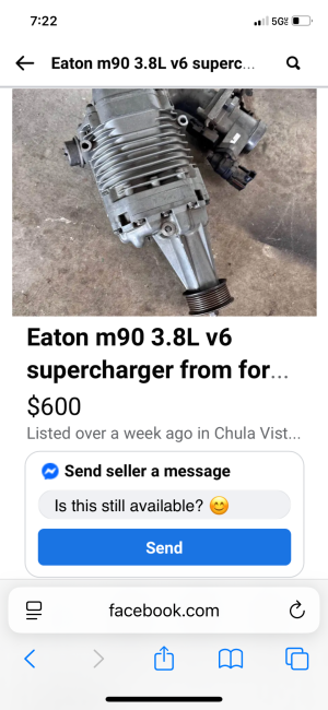

I’ve heard this supercharger works on the 3.4 and I’d have to find the company that makes the adapter plate for mounting. Don’t quote me though I’m not an engine guy but there was some posts about this as an affordable option.

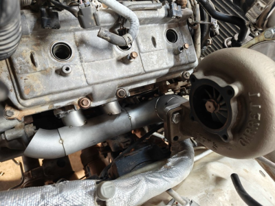

Another option:
https://www.tacomaworld.com/threads...arm-turbocharged.786969/page-29#post-30696099
Performance / turboing / tuning the 5vz has been pretty popular on the TW 1st gen forum over the past 10 years I've been on the threads. I'm not doing things that would make my truck unable to jump into any smog station to pass, but if I didn't care, I'd go this route. I'm tempted still to buy a standalone just for the SC and use my backup harness to use with my stock ecu each smog check session.
Another option:

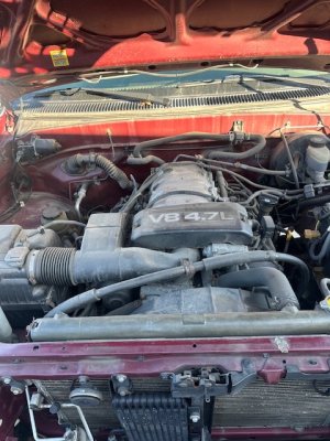

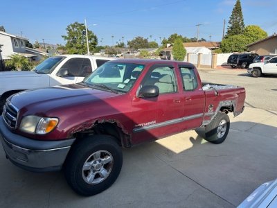

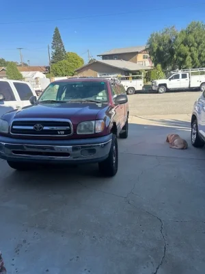

I found this very Rusty 2000 Tundra in Santa Monica for $2k and was sure it was going to sell immediately. Seller told me it was sold and he was holding it for a buyer. I kept shopping and saw another add for it from the same seller. Seller told me his buyer flaked and he needed it gone. Told him I could be there in a few hours, he said come get it.
Drove to Santa Monica from Ventura. It was just as rusty as I expected. Motor and trans operate like they should, albeit loud with the open exhaust. Someone loved this thing at some point. Found tons of service records in the OG owners manual, even with the fancy Toyota stamp.
Plan is to pull the drivetrain and interior bits I need, get whatever money I can from it then scrap the rest. I’ll clean up and maintenance the motor (timing belt, seals, gaskets etc).
Once that is all done, I’ll swap it in and do an engine cage at the same time. Progress will come and go as I get garage time.

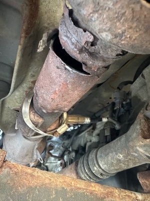

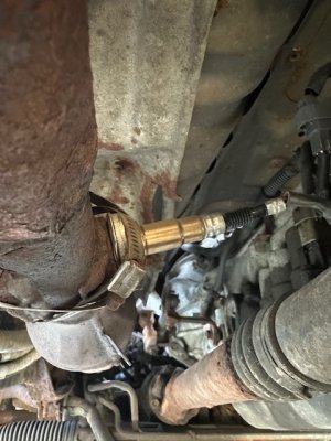

I’m sure I will struggle to get it right, but it will be worth it in the end.IMG_4901.webpIMG_4900.webpIMG_4899.webpIMG_4898.webpIMG_4897.webp

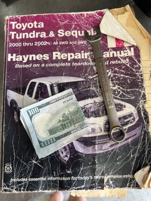

Rusty shitbox part out had started. $500 for the camper shell, found a 14mm wrench and a service manual. Let’s see if I can recover all my money?!
