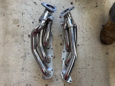

^^ There is a guy with one of these swaps done and claims he has the butterfly valve controlled electronically like the VVTi does from the factory. He uses a Nitrous trigger and sets the rpm parameters. The theory is that the vacuum keeps the butterfly in long runner mode through out the rpm band. Great for low and mid range, but not so good for top end power or gas mileage on the hwy. Mine has been working well with just the vacuum hooked up, RCF Throttle Body, 270cc inj, Thorley headers and Y pipe with no cats. But I'm also only getting 13 ish per gallon average. I also have a URD MAF calibrator that I need to experiment with some more.

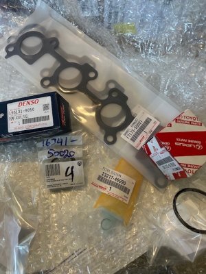

Ordered a bunch of Toyota/Denso stuff from Dubai https://partsouq.com/ they are popular with the Land Cruiser crowd for inexpensive factory parts. Parts arrived 7 days after my order. Looks to be all legit Toyota/Denso stuff. Even with $25 in shipping, it was still 40% cheaper. I will definitely order from them again if I need factory parts.
Cool, Im gonna look into that switch. Partsouq is pretty good. They had an order shipped to me in 3 days.

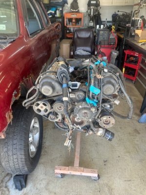

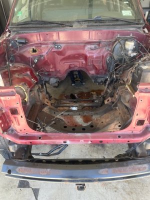

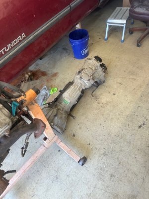

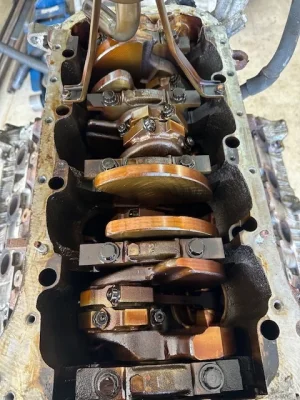

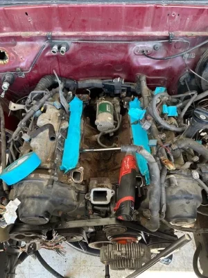

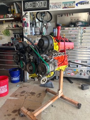

Still plugging away. Acquired $40 worth of vintage HF goodness. Motor is 90% ready to come out. Intake valves look great and no surprises on the tone end of the motor. Note to anyone pulling a Tundra V8. Pulling the intake will make the top two bell housing bolts WAY easier. We live and learn right. Parts are rolling in and so ready to get this rusty old truck out of my garage.
Check the starter solenoid connector on the harness while you have the intake off. They get baked and the tabs break off. You can get replacements from ballenger motorsports for like $5. Better to replace it now than have it pop off later.
Also check to see if the knock sensor connectors and wiring are good.

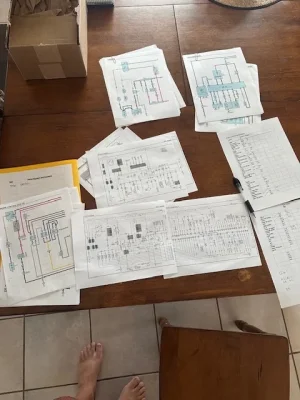

Question for the collective…
The Tundra ecu has 2 fuel pump triggers that operate independent fuel pump relays. One, power leg runs through a resistor to slow the fuel pump under certain engine conditions.
The Tacoma has only one fuel pump relay and runs the fuel pump full speed at all times, like most cars.
Both trucks have very similar return style fuel system.
I’m planning on just running the tundra fuel pump at full speed all the time to make wiring more simple.
Am I missing something? Maybe add diodes to the two trigger wires when I tie them together so they don’t back feed into the ecu?
My LS400 1UZ had two triggers that would add resistance and reduce voltage. I wired it to full kill and haven't noticed any difference. Not OBD2 though so YMMV
I pulled the resistor, jumpered the relay that swaps between it and the full kill mode, and am running an external high current wire/relay for the bigger pump in my truck. The ecu doesn't seem to notice but I also have not started it yet.

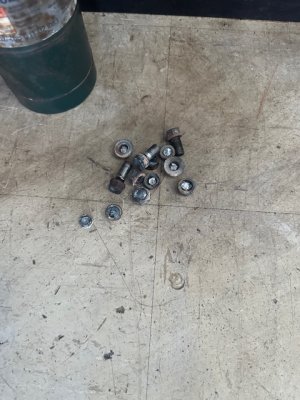

Learning the way of removing broken and seized bolts from a super crusty east coast engine.

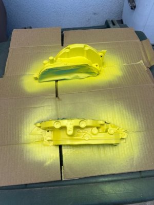

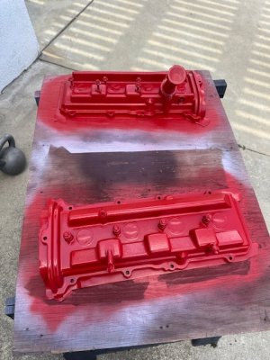

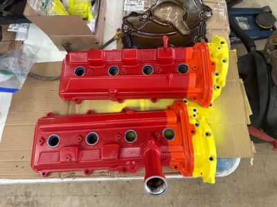

Also have the valve covers some paint with a little TRD flair. Colors don’t match exactly, but still way better than super crusty aluminum.

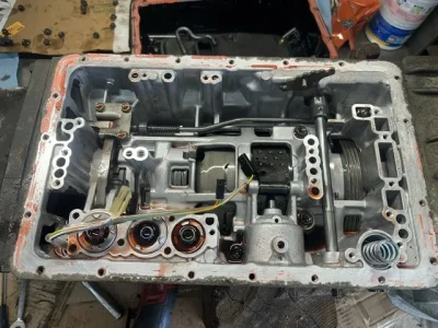

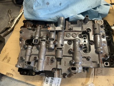

Got the motor back together and stated the transmission. Going to install a shift kit and new filter. Inside of the transmission looks great. Fluid was decent and not burned. Filter was clean and nothing on the pan magnets. I’ll have to swap my pan and cooler fitting from my V6 trans, but that easy once it’s installed.IMG_5417.webpIMG_5421.webpIMG_5422.webp
