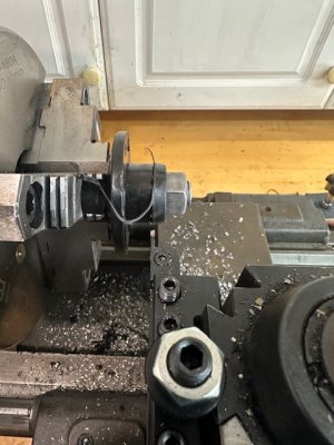

I love McMaster and definitely looked at those and similar ones. I didn’t order them for a few reasons… I’m cheap, I don’t need 25/50 of them, I had the 1” solid stock left over from a previous project, and all the tools needed to create my own.i won't begrudge anyone for making their own bits, but what about the off-the-shelf solution did you not like & were solving with these?

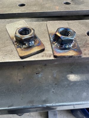

I probably should have done this. Time has been an issue, like always, because I leave for a trip this Thursday and had to get the truck back together. Seats are in, added cage to cab plates in several places, fixed a ton of cracks in the cab, and sealed up some holes. New seats are minion approved. He has graduated from a back/butt booster to just a butt booster.Welding to Toyota sheetmetal is the worst, the paint is almost as thick as the metal! It does help to use thinner wire instead of your standard .030. I bought a 2lb spool of .023 wire when I did all my tie ins and it made much cleaner welds when the power was turned way down.
Did some new seat mounts on the passenger side and added some much needed sound deadening on the floor. Added a mount for a LED whip light for KOH too.Dude, it’s awesome having power feeds and accurate dials. Definitely a big learning curve with speeds and feeds.Dude, you’re gonna have so much fun with that lathe!
