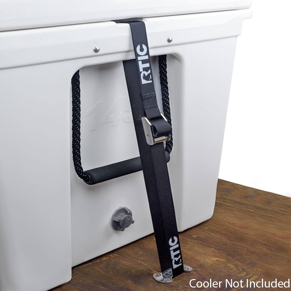

Got a new cooler to mount behind the cab for the upcoming trip. Planning on a simple angle iron tray and using the rope handles to hold it down. I want to be able to removed it easily, but have access to the lid without removing anything.
How’s everyone else mounting them?
Mine has tie down slits above the handles that you can see when you open the lid that fits a 1in strap through. So nice to be able to open without unstrapping. Maybe get crafty with some rope through the hinges and the lock plate in the front?
+1 i just use the RTIC straps through the loops near the handle ropes.
They're cheap & on amazon.
amazon link
