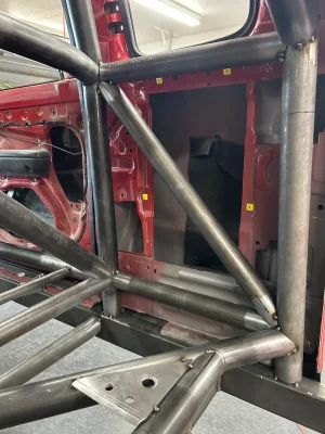

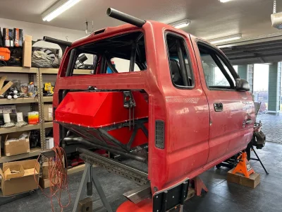

Local Legend Not much left Tacoma left... 4500 koh build

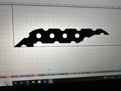

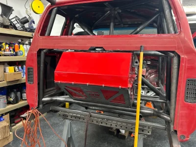

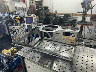

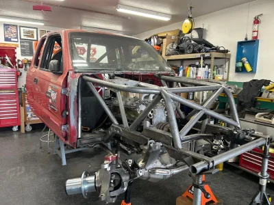

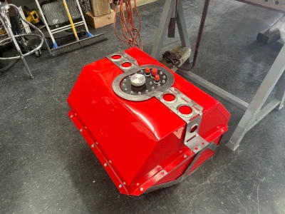

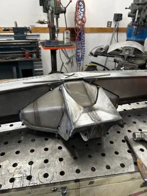

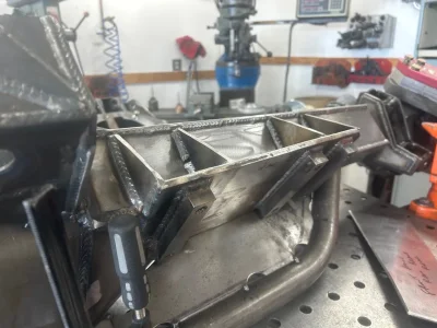

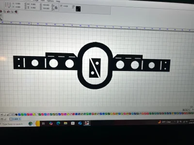

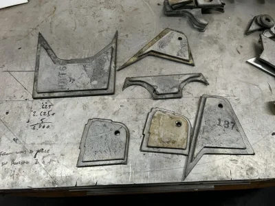

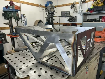

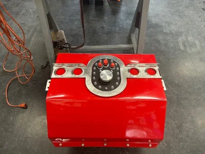

I also worked on the fuel cell and am extremely stoked on how it came out. Drew it all in 2d cad and cut it all correctly the first time and with no screw ups from the cnc. Never would have thought I would be able to make something like this.IMG_9051.webpIMG_9052.webpIMG_9081.webpIMG_9083.webpIMG_9084.webpIMG_9086.webpIMG_9091.webpIMG_9093.webpIMG_9097.webpIMG_9110.webp

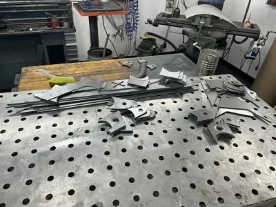

Tons of parts on order and should start coming in next week or the week after. Just been focused up on finishing some stuff I left half done.

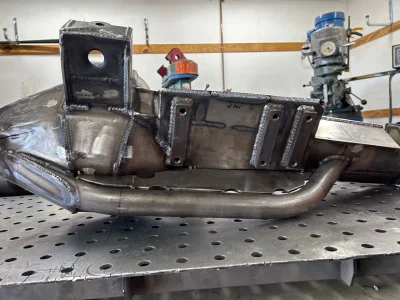

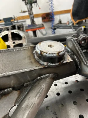

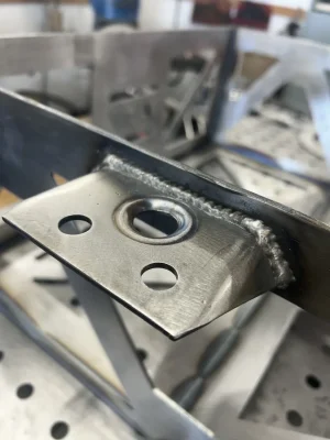

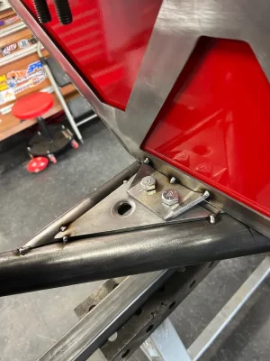

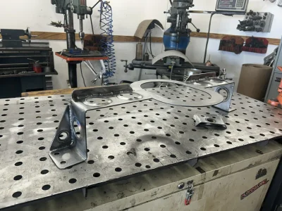

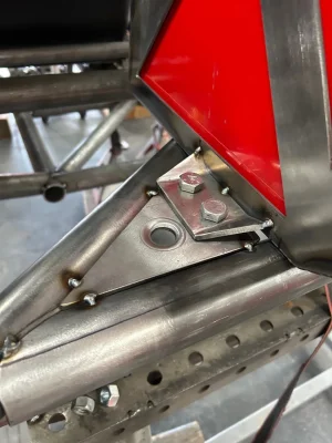

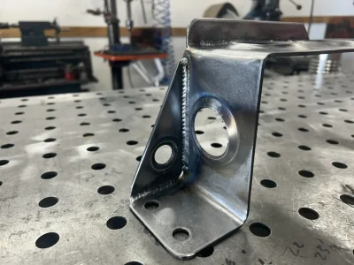

Fuel cell tabs. May do something off the top but I’ll wait to see if they’re needed.IMG_9141.webpIMG_9142.webpIMG_9143.webp

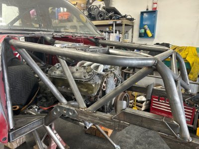

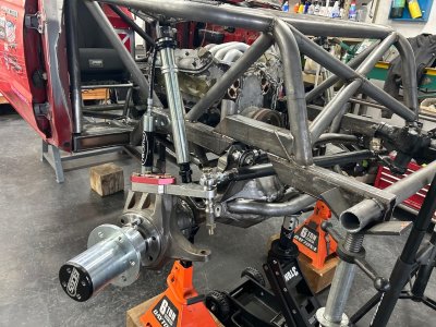

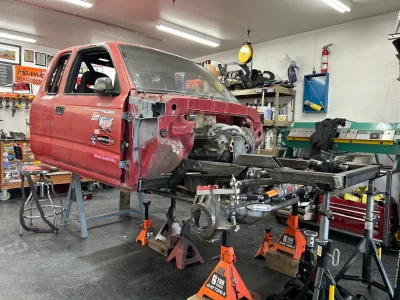

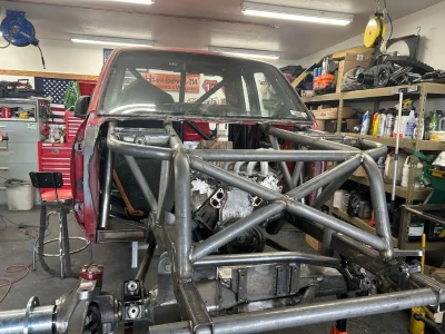

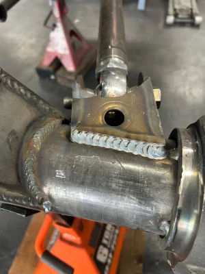

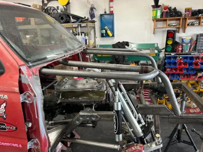

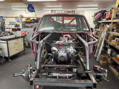

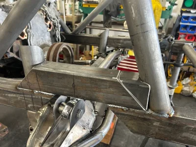

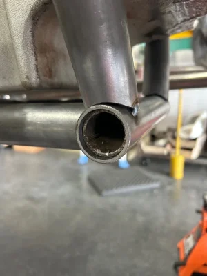

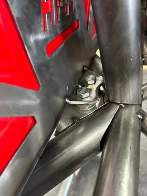

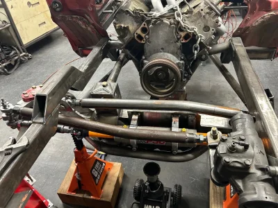

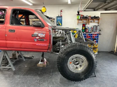

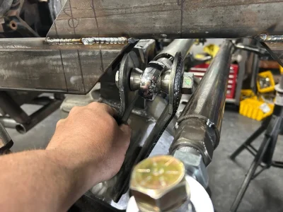

Screwed with the front suspension some. I rebent the panhard with a single bend and moved the frame side mount back some. And added a small bend to the draglink to clear the ram.IMG_9154.webp

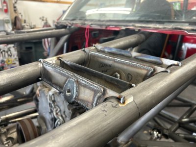

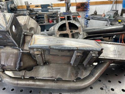

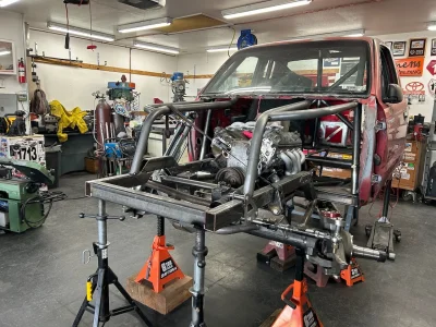

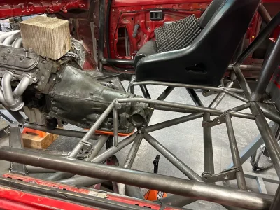

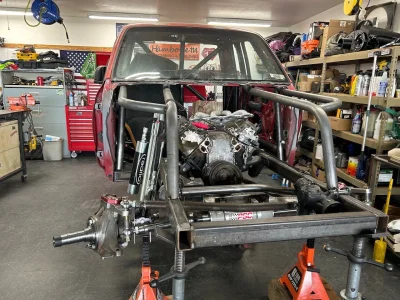

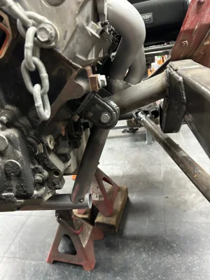

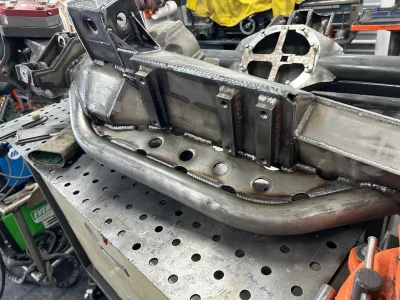

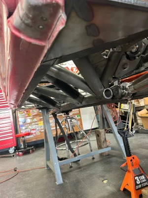

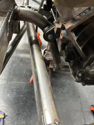

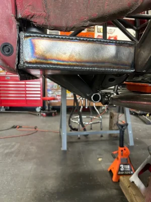

Engine skid plate. I ended up taking the sub frame apart and sleeved all the main tubes with some 1.75. Engine skid plate was out of 1.75 so sleeved with 1.5.IMG_9150.webpIMG_9151.webpIMG_9152.webpIMG_9159.webp

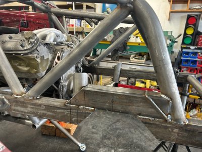

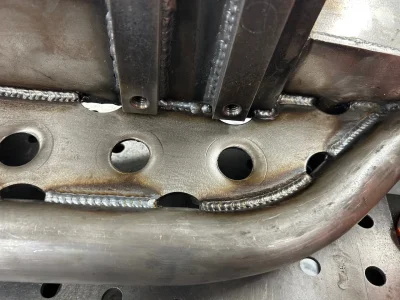

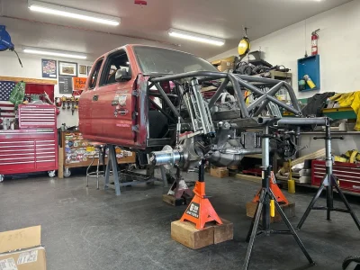

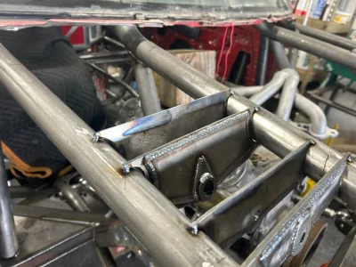

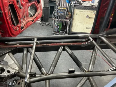

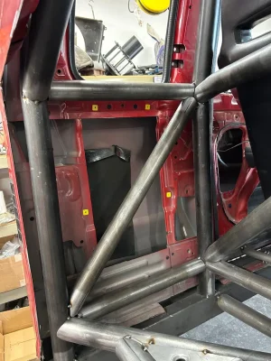

And finally finished the subframe to frame tubes. Tube work is getting easier. When I started this the two end tubes took me all day to make. I made the 5 tubes between the original two on both driver and passenger in just a few hours today. Feel like there’s good clearance.IMG_9163.webpIMG_9164.webpIMG_9167.webpIMG_9168.webpIMG_9170.webpIMG_9171.webp

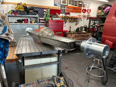

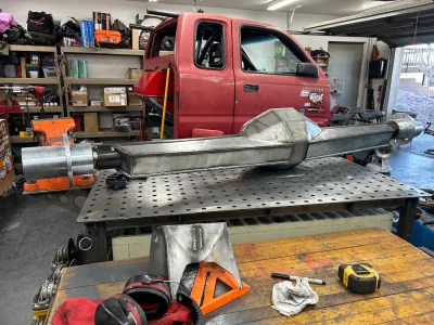

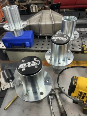

Rear housing showed up and I got a ton of brackets and stuff for it cut and welded. Rest of the bearings and races showed up for the hubs minus one seal so put them together and just waiting on the brake stuff.

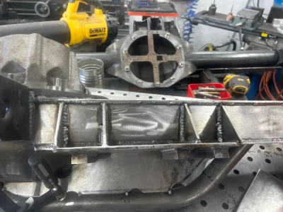

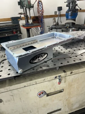

Housing will use equal length shafts. Oil pan from kevko also showed up and pretty happy with it.IMG_9212.webpIMG_9215.webpIMG_9216.webpIMG_9225.webpIMG_9236.webpIMG_9248.webpIMG_9246.webpIMG_9251.webpIMG_9252.webpIMG_9242.webp

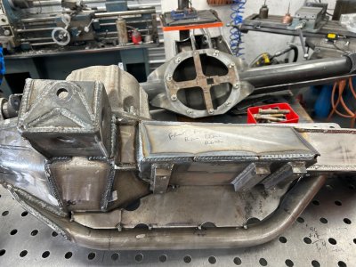

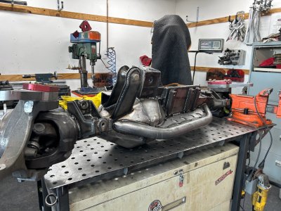

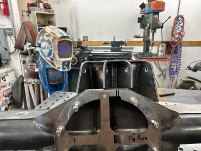

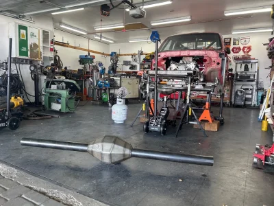

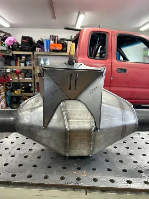

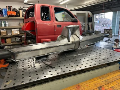

Housing cut to length. I went back and forth and equal length shafts or a centered pinion but ultimately decided equal length. Shortened the short side of the truss to match. It creates a shear point in the tube but I need clearance for the brakes so once all that’s on I’ll make a small extension. Spindles need some more chamfer and a few plug welds and they’ll be ready to go in forever. I liked the upper link mount but I only cut it out of 3/16 and got it a little hot welding so cut another one with some overlay plates which I’ll get welded up this week. Not sure if I should do a top truss as well or just the backbone.

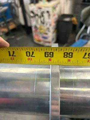

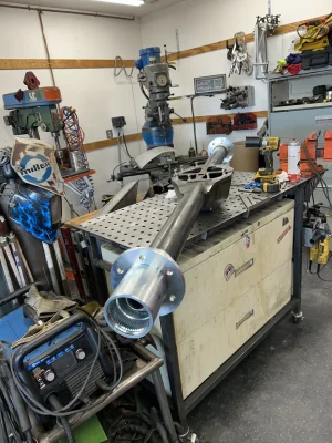

Goal was 68 7/8 for wms for the rear since the front is 69 and think I nailed it. Axle shafts ended up around 38.5.IMG_9258.webpIMG_9257.webpIMG_9262.webpIMG_9263.webpIMG_9268.webpIMG_9269.webpIMG_9267.webpIMG_9272.webp

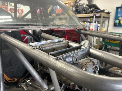

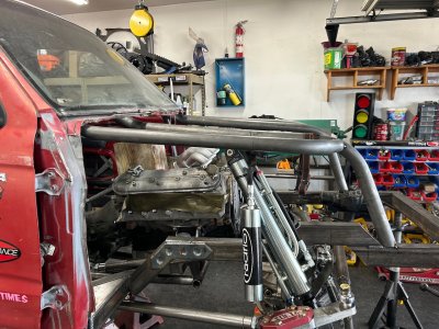

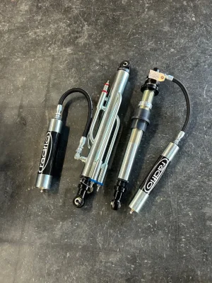

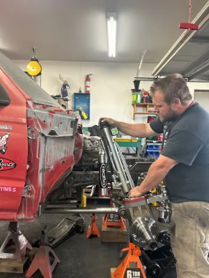

And on the topic of shocks, I reached out to radflo and they stepped up to help me out big time. Looking forward to working with them and getting the car to work really well. Plan is to run the front shocks angled back about 20 degrees and in some after talking to @broken4_racing. I wanted to do 25 degrees but I think that’ll cause issues later on for my setup and packaging.

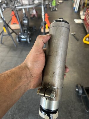

2.5x14 4tube remote resis bypasses and 2.0x14 remote resi coilover.

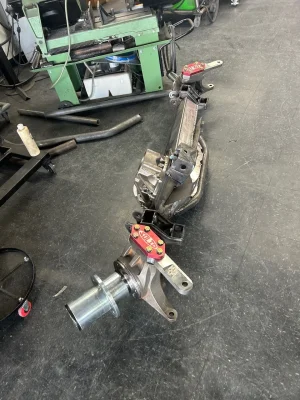

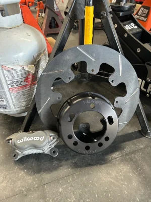

One box of braniks goodies also showed up. Using their kingpin brake setupIMG_9281.jpegIMG_9294.jpegIMG_9295.jpegIMG_9297.jpegIMG_9316.jpeg

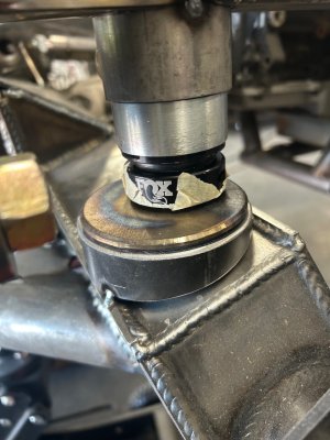

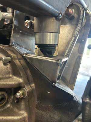

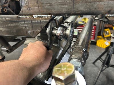

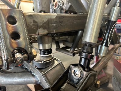

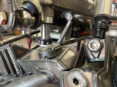

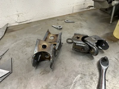

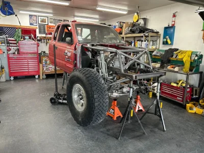

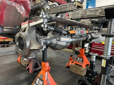

5 long days of putting in work with my dad and we got a ton done I feel. The front is cycled and pretty much done and ready to be welded. I got the front lower shock mounts welded and tacd back on and working on the final version of the front upper shock mounts. My dad was able to knock out most the brace tubes and notch the frame for bumpstops. We cycled it a bunch and I can lift the axle up and down by hand through the travel so no binding so far. Once i finish the upper shock mounts ill pull the axle and start finish welding it and bracing everything. Last things to do on the front once i get the uppers made is bump stop pads and get the cans tacd in place. We also plotted out how to start the rear as well but I want to get the front done to a point so i can put it on its own weight and turn it around.IMG_9348.webpIMG_9350.webpIMG_9356.webpIMG_9359.webpIMG_9362.webpIMG_9358.webpIMG_9363.webpIMG_9365.webpIMG_9366.webp

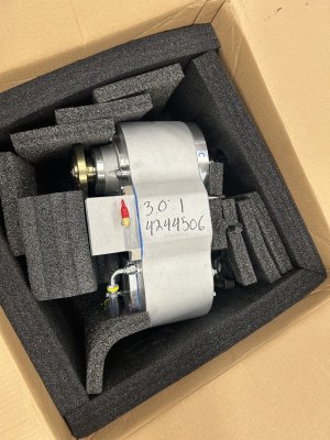

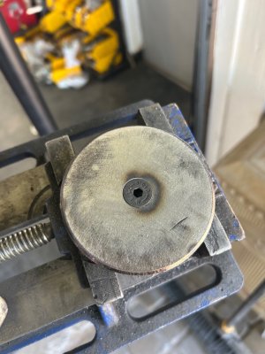

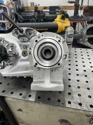

Atlas showed up with the adapter. Adapter bottom needs trimmed to clear the subframe so I’ll throw it in the mill and take some off.IMG_9395.webpIMG_9396.webp

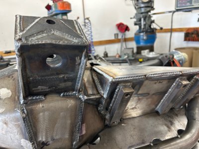

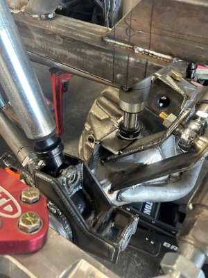

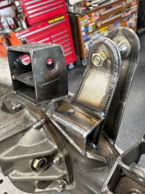

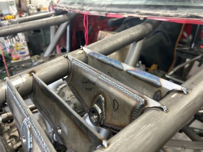

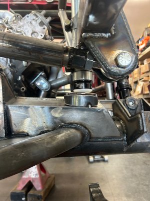

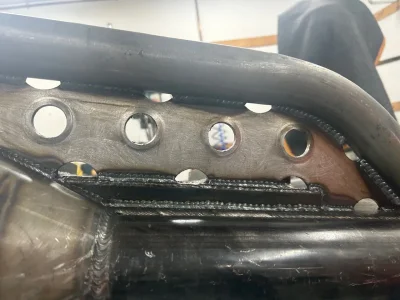

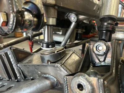

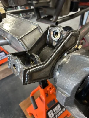

Little bit of time today. Got the shock mounts done. Not really a fan of how I did them because of how complicated the mounts turned out to be but they’re done. I then started welding out the front and pulled the axle to fully weld it. Not the best welder when it comes to tube but maybe by the end I’ll be decent.IMG_9416.webpIMG_9418.webpIMG_9419.webpIMG_9420.webpIMG_9421.webpIMG_9422.webpIMG_9423.webpIMG_9424.webpIMG_9425.webpIMG_9426.webp
More axle welding. It’s back under the car to get the panhard hard tacd since I erased my marks by accident.

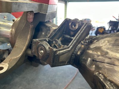

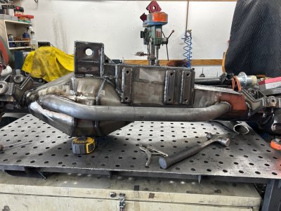

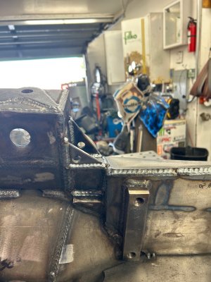

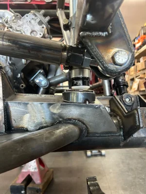

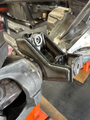

Redid the front tube as it was pretty close to the ram bolts and clamps and worried about it getting smashed. And made it flow into the housing which looks way better. Besides the panhard and bump pads, front axle is doneIMG_9488.webpIMG_9491.webpIMG_9493.webpIMG_9503.webpIMG_9505.webpIMG_9508.webpIMG_9509.webpIMG_9511.webpIMG_9512.webpIMG_9495.webp

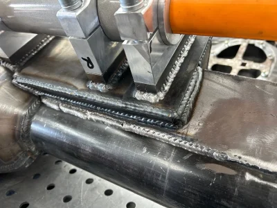

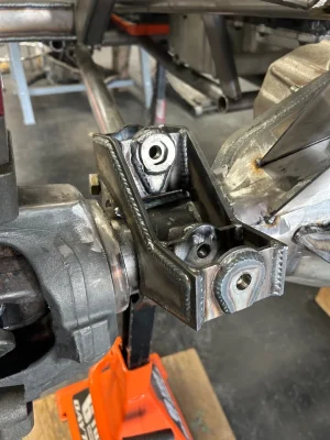

Bump pads are in. Panhard is welded. Few more plates for support and front axle will be done. Getting close to turning it around and starting on the rear. Driver side is a piece of the axle housing so 3.5x.25 and then has a piece of 2x.25 in the middle welded to the cap.IMG_9522.webpIMG_9525.webpIMG_9529.webpIMG_9533.webpIMG_9534.webpIMG_9536.webpIMG_9540.webpIMG_9539.webpIMG_9545.webpIMG_9546.webpIMG_9547.webp
