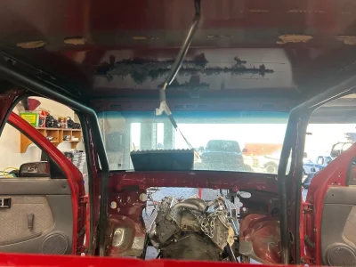

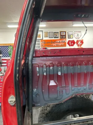

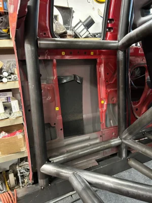

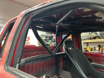

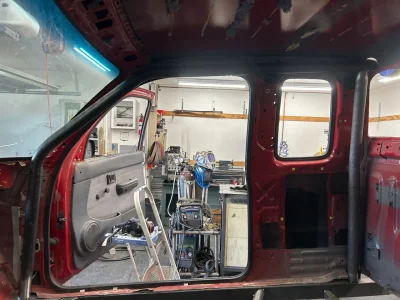

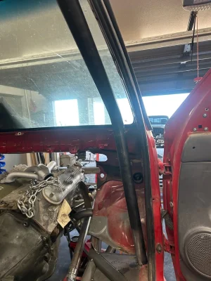

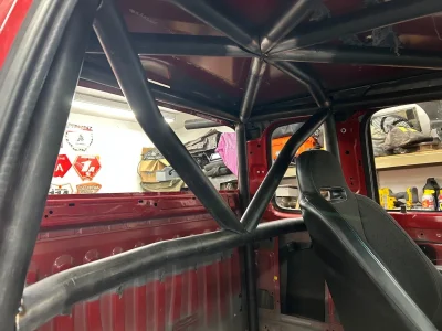

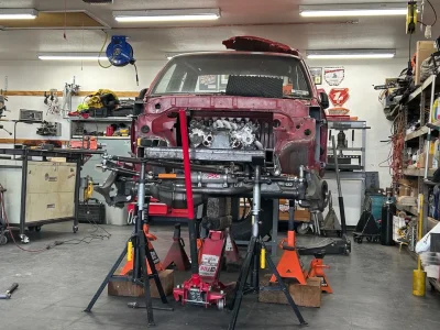

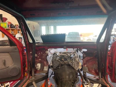

looks lke if you bend the top of the a-pillar some more it might tuck a little tighter/better
If he did that he'd have to raise the whole tube up, which would bring the lower windshield bend too high and probably hit the windshield. I'd leave it. It's a little low for getting in the truck, but makes for more room above your head when seated. My truck is set up similarly.
I’m afriad of wasting more tube if I over bend etc. I wish it was a little higher and it may end up slightly higher but it’s just about tucked into the body where I cut all the supports out so should leave plenty of head room. I added a c pillar and pushed up on the main tube and that helped some as well.

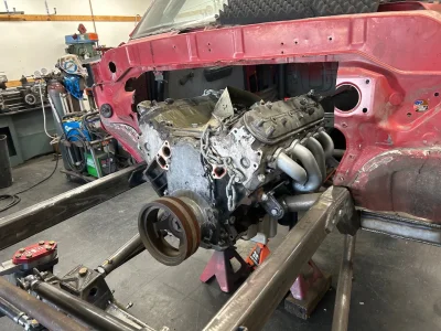

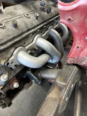

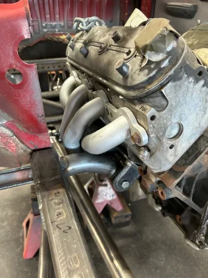

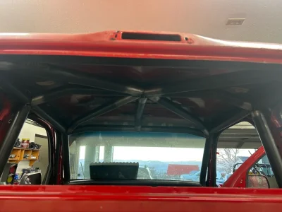

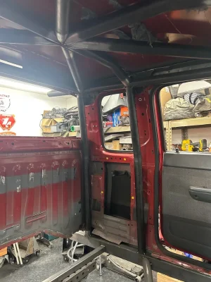

I did some stuff for a buddy and some house projects so only got the c pillar done today and now I’m out of tubing. I’ll pick up some more this week after work and continue on the cage next week. Also slapped the headers on just cause and the driver clears but passenger v band gets into the motor mount. May have to find a different set. IMG_8710.webpIMG_8711.webpIMG_8716.webpIMG_8712.webpIMG_8713.webpIMG_8714.webp

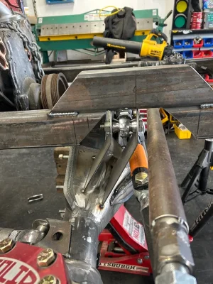

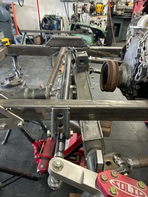

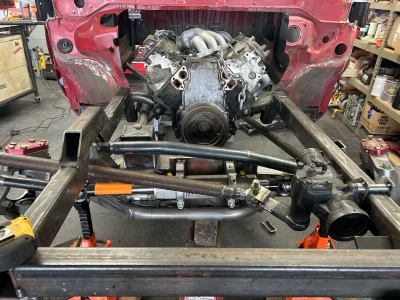

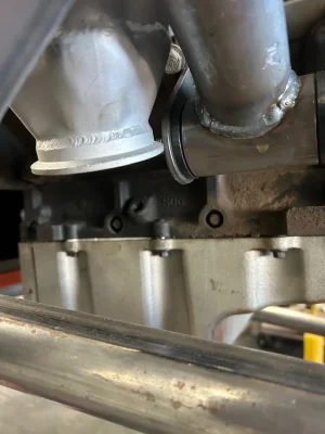

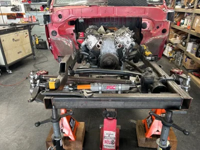

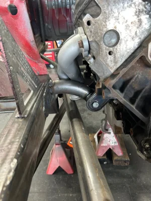

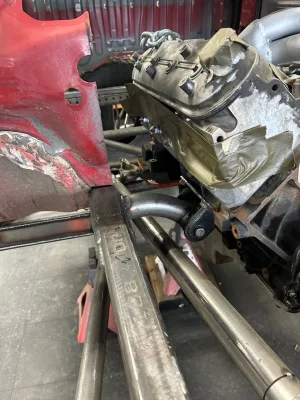

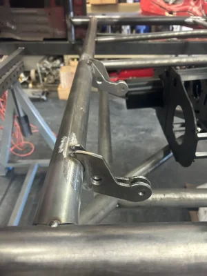

Was just going to have a lazy day but reading forums and looking at pictures decided to go out and mess with the panhard for a little bit. I’ve been putting off adding bends to the panhard and ended up adding (2) 12 degree bends on either side where the ram ends as at full bump the panhard hits the ram. I then notched the passenger side from for the panhard bracket to go into and draglink to go into. Regret putting it off as it worked well and now everything clears. 12 degrees may have been a little much and I can probably get away with 6-10 which I’ll try later. But this will allow me to lower the axle side panhard some as well so it’s not a giant lever. The draglink just barely gets into the bolts on the ram so I either need to move the steering box forward a 1/4-1/2 inch or add a bend. Not sure adding a bend will solve my issue but I may try it just to see.
And the upper link ends up getting into the headers so I’ll have to do something about that.

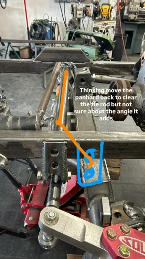

What’s everyone’s thoughts on offsetting the frame side panhard mount back as right now my limiting factor is the frame side panhard heim is hitting the tie rod.IMG_8724.webpIMG_8725.webpIMG_8732.webpIMG_8733.webpIMG_8734.webpIMG_8735.webpIMG_8736.webpIMG_8738.webp2AC2E13B-203C-46D1-97C2-296513D1F10F.webp

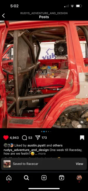

Picked up more dom and got the c pillar knocked out and made a dash bar. Posted some pictures on Instagram and had a guy message me asking what happened if I swapped the a pillars side to side to minimize the gap between the sheet metal. I ended up doing it and made a big difference. Good chance I got them mixed up when I had them out last so I swapped them and made a big difference. Ended up tacking them back in after swapping them but need to make a new dash bar.

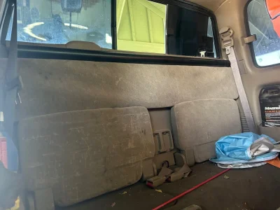

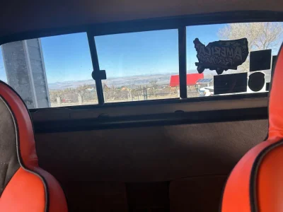

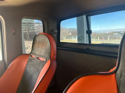

I also got a set of prp seats my parents got me for Christmas a few years ago installed in the other crawler. Think they turned out good. Just waiting on harnesses. The harness bar is against the rear wall under the window.
First picture is before. 2nd picture is after.IMG_8770.webpIMG_8772.webpIMG_8773.webpIMG_8775.webpIMG_8765.webpIMG_8767.webpIMG_8768.webpIMG_8763.webpIMG_8751.webp

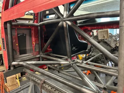

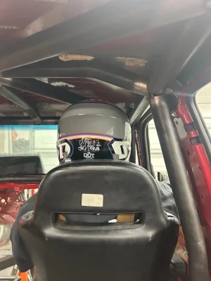

I think every tube on my roof is bent but being tall I needed every inch I could get. The pillars look good, the only way I have found to get them tighter is to tie into the top of a dash bar. There's probably a few pictures in my build thread if you're curious. The panhard on my Sequoia ended up with more bends than yours and only time will tell if it'll hold up. Tight packaging to maximize up travel for sure.

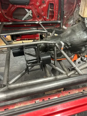

Spent the last 2 days messing with the cage. Wasn’t planning to add as many bends to the roof bars but it was needed to get the headroom and still be able to see. Still need to do one more bar down the middle in the back and the intrusion bars but I’ll wait till I screw up something and have some waste.

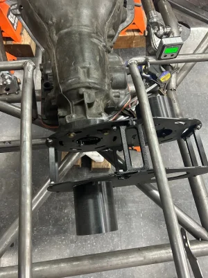

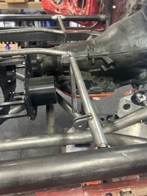

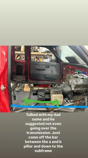

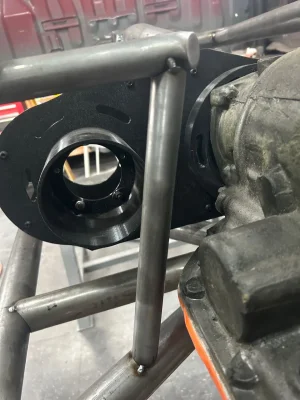

Next I want to get the seats mounted so I can do the b pillar. Plan is to run a bar between the an and b pillar and then run some tubes towards the trans but stop them short with some supports off the subframe. The trans needs to come out of the door so trying to make it easy ish to get out. Was originally going run tubes over the trans and atlas but my dad suggested just stopping them short.

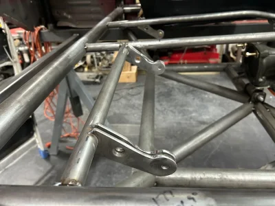

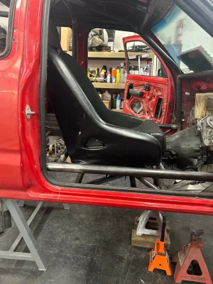

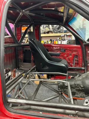

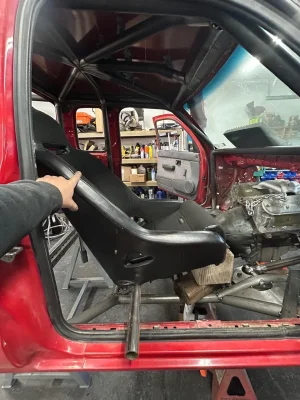

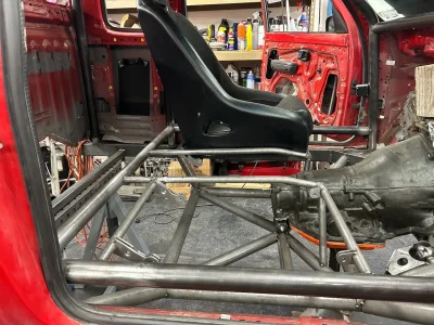

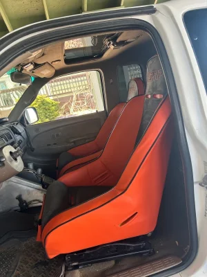

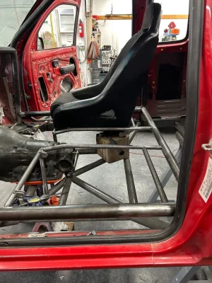

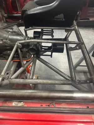

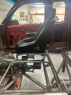

Seat mounts have been kicking my ass. Sadly this took me two days and still not done. Trying to find something functional, looks good and allows my head to clear the cage has been a challenge but think I finally got it. Literally as low as they can go with the atlas. Should have maybe lowered the subframe some more but it’s done.IMG_8935.webpIMG_8938.webpIMG_8941.webpIMG_8942.webpIMG_8943.webpIMG_8945.webpIMG_8947.webpIMG_8950.webpIMG_8952.webpIMG_8954.webpIMG_8959.webp
Got the driver seat mounts in and adjusted the passenger a little more. Started making the harness bar till the hole saw stripped out on the arbor of the notcher so called it a night. Short day but happy to have the seats hopefully done.IMG_8961.webpIMG_8962.webpIMG_8963.webpIMG_8964.webpIMG_8965.webp
Redid the seat mounts after a suggestion on irate
Alright redid the seat mounts again. Got them a little lower by another inch or so and moved the one bar between the b pillar. So the entire seat mount is out of 1x.120 wall dom and 3/16 tabs. Between the seat cushion settling some (I’ve been told it’ll settle between 2-3”) and the harnesses pulling you into the seat. Should be more than enough room. Not really interested in going to composite Seats for now.IMG_8992.webpIMG_8994.webpIMG_8995.webpIMG_8996.webp

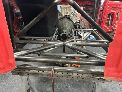

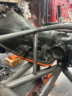

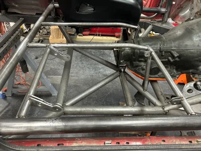

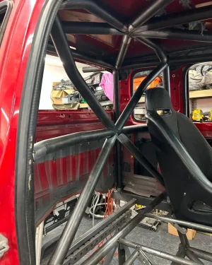

Then messed with starting on the b pillar x. Was able to salvage the original cross bar I made by adding another 15 degree bend on each side. It probably only needed 10-12 degrees but the extra between the seat and bar will make getting to harnesses and any bags I put between easier. I got the top two bars of the x in as well. They look close but are no where near your head. Even if you got whiplash, your head won’t hit the bars because of the head rest. I may order the seats with +2 in height to just get the head rest a little higher. Pretty much copied this Cherokee build for the b pillarIMG_9003.webpIMG_9004.webpIMG_9005.webpIMG_9007.webpIMG_9002.webp

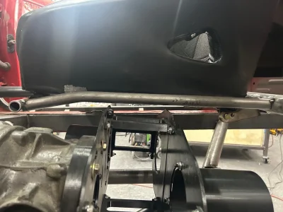

Only made it outside for an hour or two and got the rest of the x knocked out. Pretty happy. Took measurements to make a file for the fuel cell to get That mounted next.2EAA5A4F-736B-4C64-98EC-6A6C86638C0F.webp

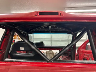

Got most the passenger compartment cage done minus the intrusion bars and door bars. Pretty happy with it.
I ran out of tubing so the bracing between b and c pillar still needs done as well. But that’s 3 more short ish tubesIMG_9100.webpIMG_9106.webpIMG_9107.webpIMG_9104.webpIMG_9073.webp
