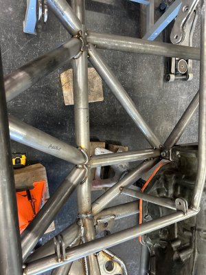

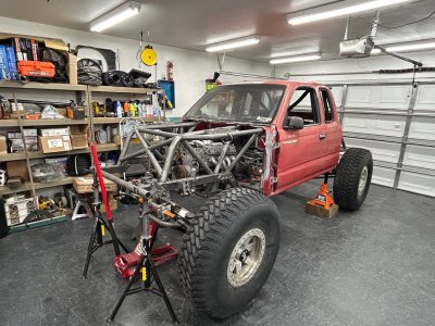

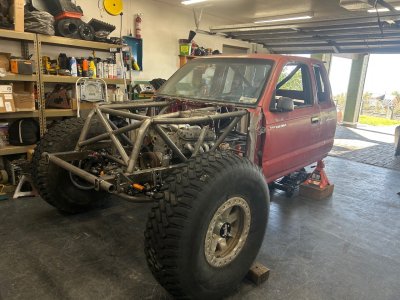

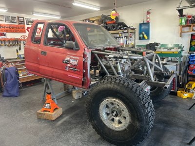

Not much left Tacoma left... 4500 koh build

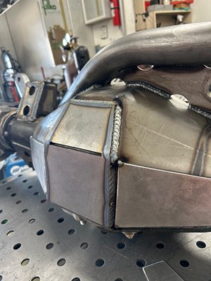

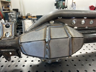

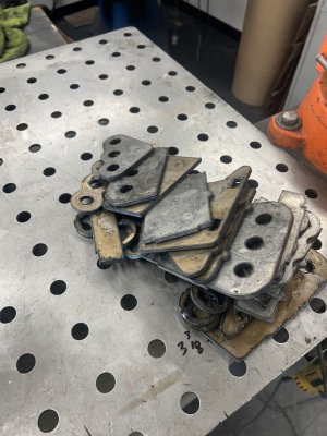

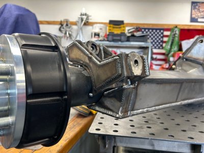

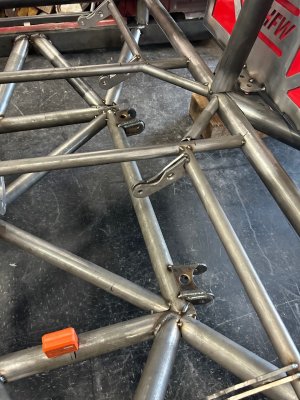

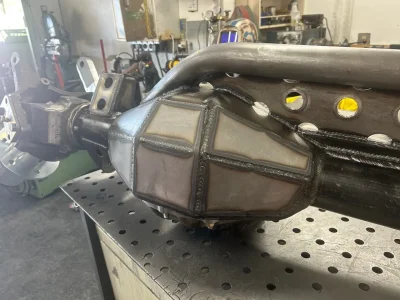

Another day of working on this housing…

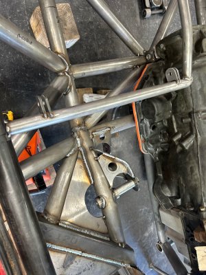

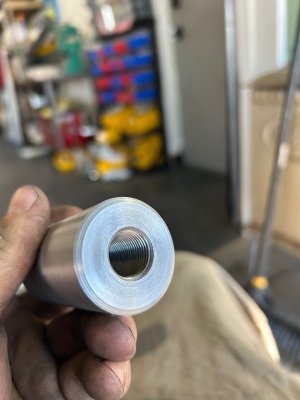

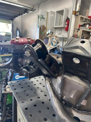

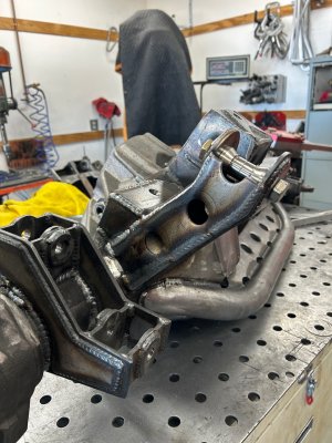

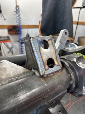

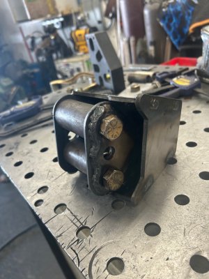

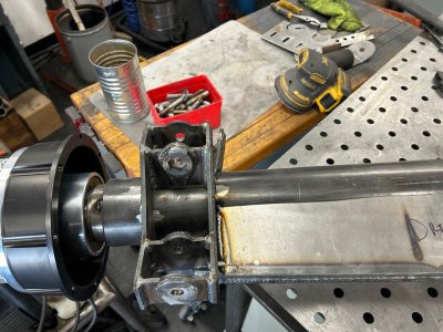

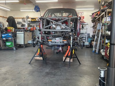

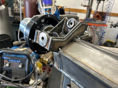

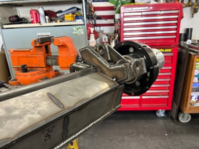

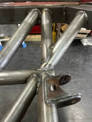

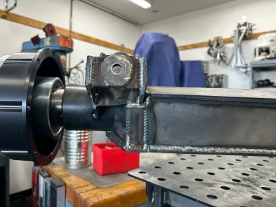

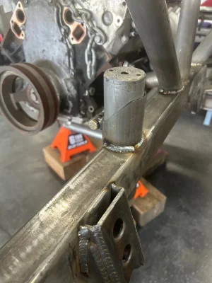

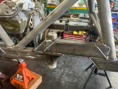

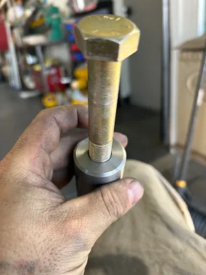

Started welding out the subframe as well and made the slug for the upper link. Originally it was just a sleeve and then a nut on the end but the bolt was so long, the trans had to come out to pull the upper link. So I made another sleeve and tapped it for a 5/8-18 fine thread bolt. I’ll make a bolt on capture nut plate for the bolt head as well and some red loctite and it shouldn’t go anywhere.IMG_9549.jpegIMG_9550.jpegIMG_9552.jpegIMG_9554.jpegIMG_9558.jpegIMG_9556.jpegIMG_9557.jpegIMG_9559.jpegIMG_9560.jpeg

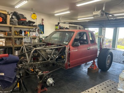

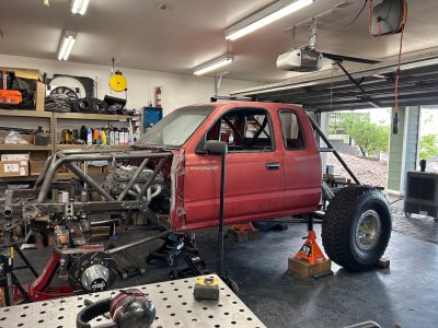

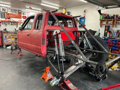

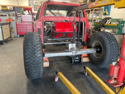

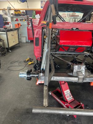

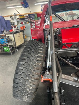

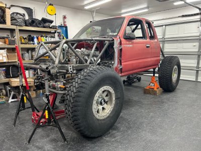

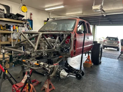

Well got the front axle back in and wheel studs finally showed up. Having all sorts of issues with the brake kit and calipers not fitting so just carried on and went to turn it around it. Got the front tires on and went to put the back saw horse on some carts as they looked the perfect width. When jacking up the saw horse, it broke the tacs and clamps and car crashed to the ground. Only a more broken windshield cab bounced a little bending down sheet metal.

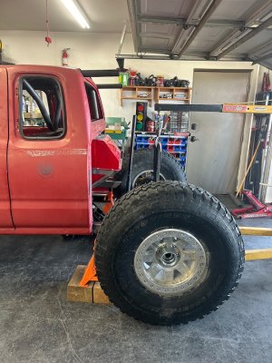

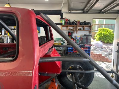

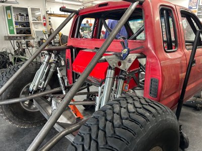

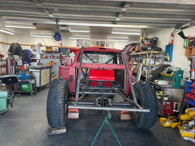

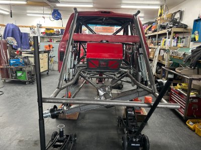

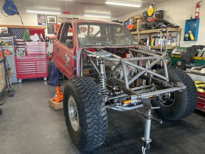

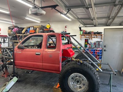

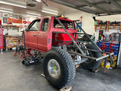

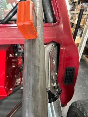

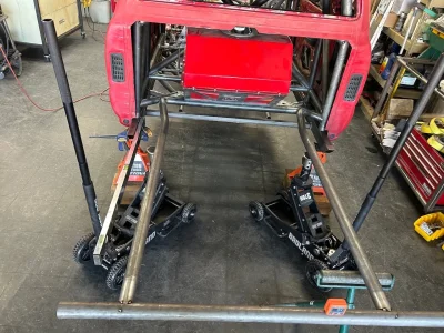

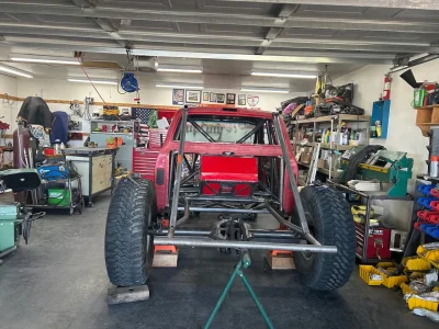

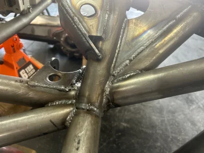

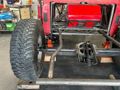

So a few hours of undoing all the front axle again and getting the rear on the cart I got it turned around and put the front at full bump and leveled the frame to start figuring out the back. Got the wheelbase right around 117-118 which I think is where it’ll stay. I got a few tubes in after these pictures but forgot to snap one.IMG_9621.jpegIMG_9624.jpegIMG_9623.jpegIMG_9625.jpegIMG_9627.jpegIMG_9629.jpegIMG_9631.jpegIMG_9630.jpegIMG_9633.jpegIMG_9628.jpeg

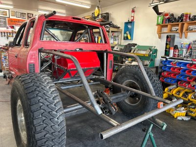

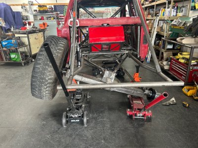

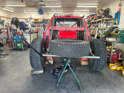

Spent an entire day last week working on the rear and made something I didn’t like. Finally got something I do like though. Onto getting the link mounts in.

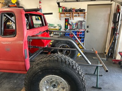

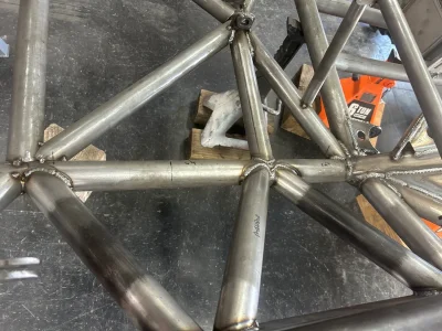

old. Rear frame was to narrow for a 40” spare and the design was just dumb not coming off the top tube coming out of the cab.IMG_9693.jpegIMG_9704.jpegIMG_9705.jpeg

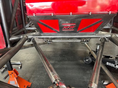

Notched the crossmember for the fuel cell. This gave me another inch of uptravel in the rear which should be 8.5. Not my best notch but considering it was done on my back and I can weld the gaps and cut/grind it clean, I’ll be happy.

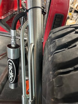

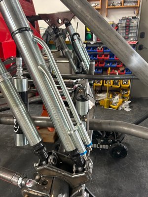

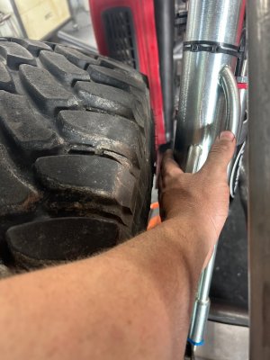

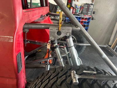

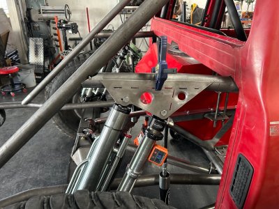

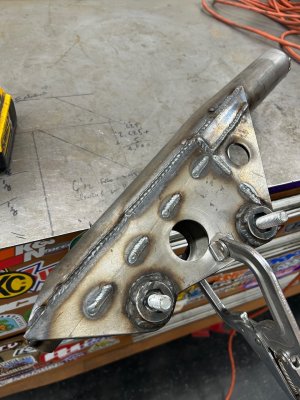

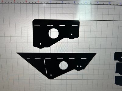

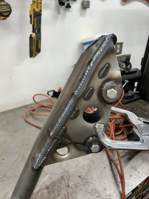

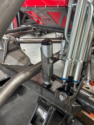

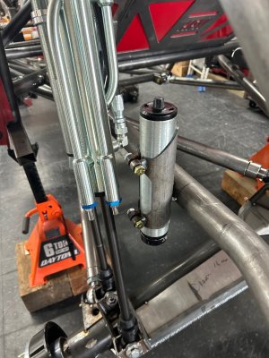

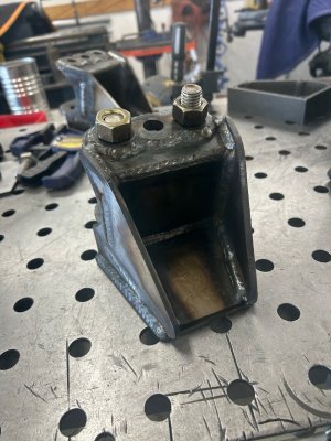

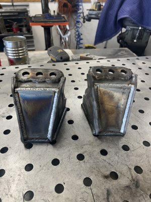

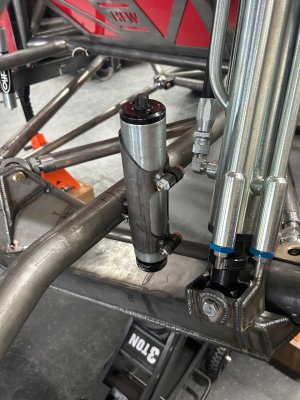

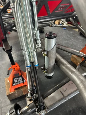

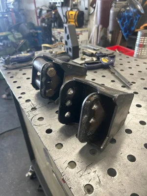

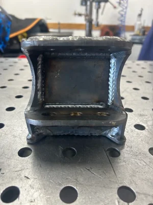

Started on the shock mounts. Version 1 looked weak and small so madeanother that’s a little bigger. Tirealmost kisses the shocks so I’ll bendthe brackets in a 1/2 or so.IMG_9784.jpegIMG_9788.jpegIMG_9791.jpegIMG_9794.jpegIMG_9795.jpegIMG_9796.jpegIMG_9797.jpegIMG_9799.jpegIMG_9800.jpeg

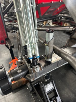

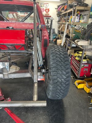

Spent yesterday messing with the rear shocks. I didn’t like how much they were angled in so moved the lower mounts in 2.5” which made a big difference. Spent the rest of the day getting the upper mounts to fit.
Before
After

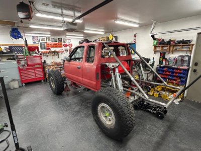

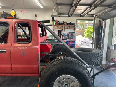

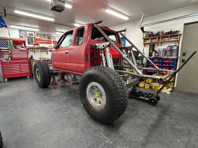

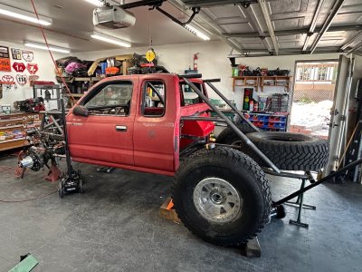

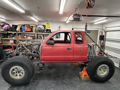

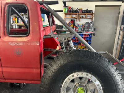

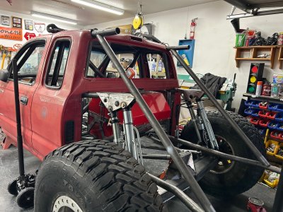

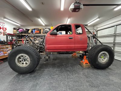

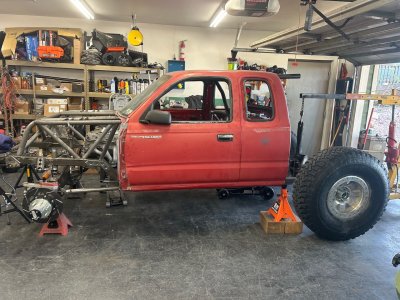

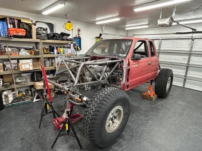

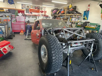

Spent today putting the truck at ride height so I can cycle the rear. Threw a tire on the front and extremely happy with the overall look etc. 116.5 ish wheelbase. 22.5 to the bottom of the subframe. 27” to the bottom of the body seam under the doors. 7.5” of uptravel in the front and 8.5” in the rear. Overall I think it has a great look and stance.IMG_9825.jpegIMG_9826.jpegIMG_9827.jpegIMG_9830.jpegIMG_9829.jpegIMG_9828.jpeg

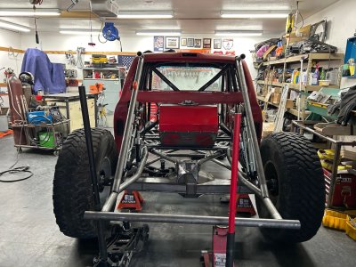

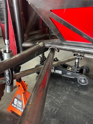

Wasn’t feeling great the last 2 weeks but finally got a few days in the garage. Got most the rear frame welded and a lot of the cage that I could easily get to. Then started on the sheet metal. Trying to get the cab enclosed so I can pull the cab and finish welding the cage
