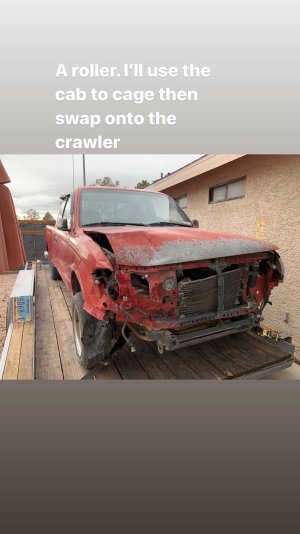

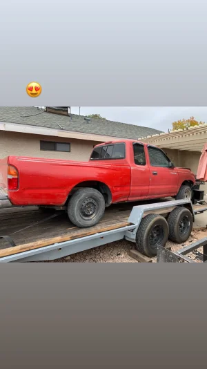

I picked up a wrecked 5 lug 3.4 95 Tacoma a few years ago. Original plan was to strip it, build a cage in it and swap the cage to my current white truck.

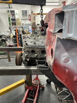

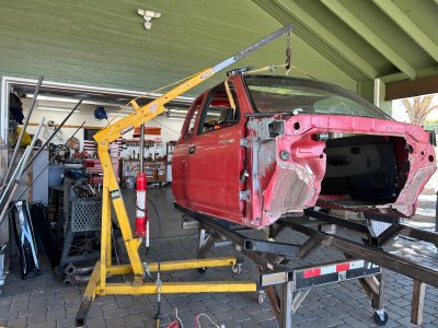

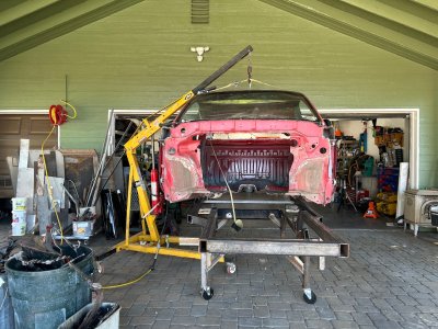

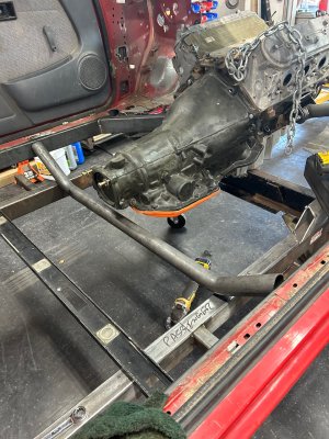

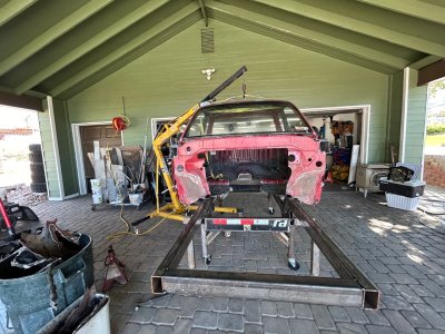

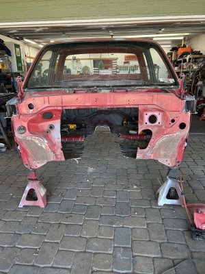

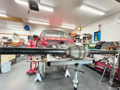

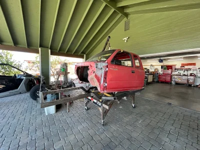

IMG_6812.jpegIMG_6847.jpegIMG_6853.jpegIMG_6854.jpegI quickly stripped the interior and trans (motor was missing) after I got it (December 2021) We moved to our new house early the next year and it sat till the following winter when I pulled the cab and started a cage. It got pushed back outside onto the frame when the red double cab project came up and I started on the new frame middle of August 2024.

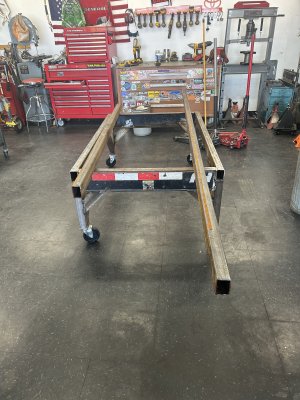

Table I made to move the frame around

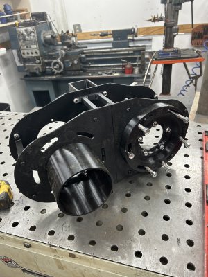

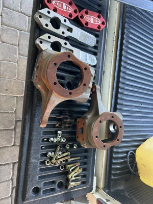

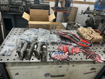

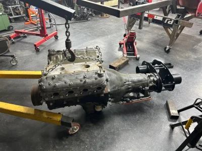

I slowly collected parts. Picked up two stock 5.3s that needed some work from one of the sketchiest marketplace deals I’ve ever done. A cam, new lifters, a gasket kit and more for the motor, a core of a th350, a foam th350, 3D printed atlas, knuckles and a bunch of other stuff.IMG_6898.jpeg5B4E853C-A176-4D78-B82F-19914B3C03E6.jpegIMG_6823.jpegIMG_6905.jpeg

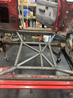

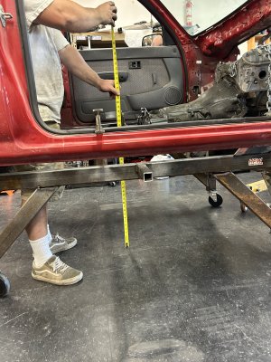

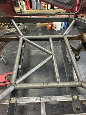

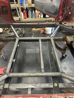

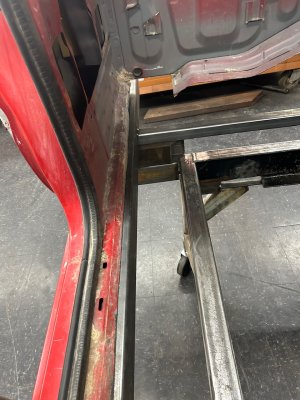

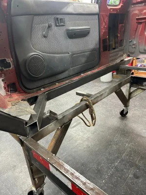

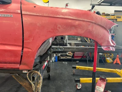

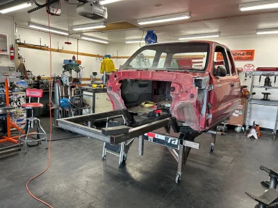

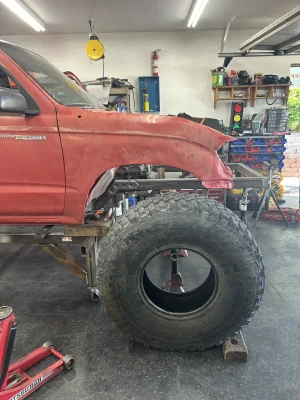

I then got to cutting. The plan is just a Tacoma shell on a “chassis” essentially. The floor is cut out and a subframe will be made. The front section of frame rail are 2x3x.188 and the section under the body is 2x3x.120 wall. Most the cage will be 2 in dom wirh 1.75 dom gussets .
I started small but things escalated quicklyIMG_6861.jpegIMG_6864.jpegIMG_6866.jpegIMG_6867.jpegIMG_6873.jpeg

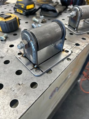

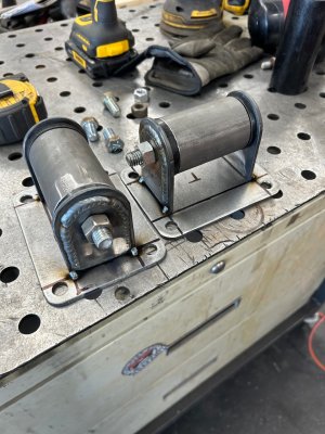

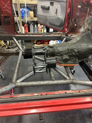

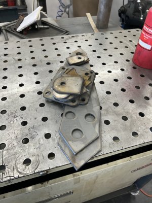

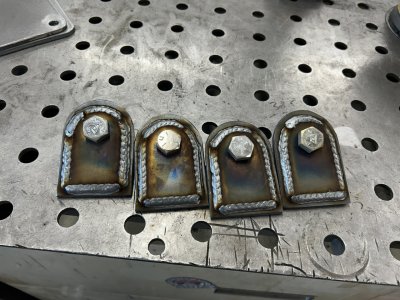

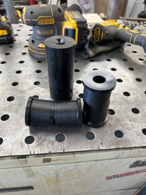

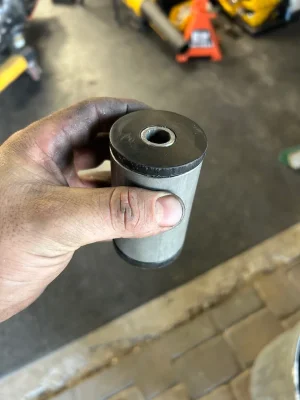

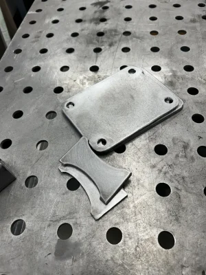

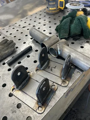

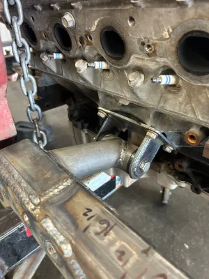

And then made some motor mounts. Turned the bushings down from delrin and sleeved with 3/4 dom for a half in bolt. Most things will be cut out of 3/16 and then plated with 1/8 for strength. I find working with 3/16 is easier over 1/4 and my cnc plasma table cuts 3/16 way better.IMG_6914.jpegIMG_6916.jpegIMG_6917.jpegIMG_6918.jpegIMG_6921.jpegIMG_6923.jpegIMG_6922.jpeg

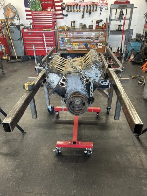

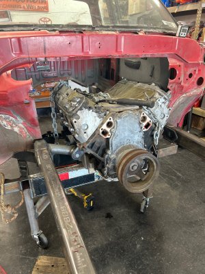

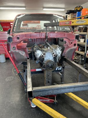

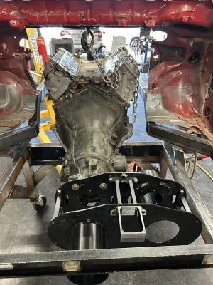

this is pre Labor Day weekend. I got themotor where I’m happy and about to start making the motor mount tubes.IMG_6936.jpegIMG_6939.jpegIMG_6935.jpegIMG_6933.jpegIMG_6924.jpeg

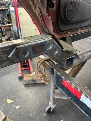

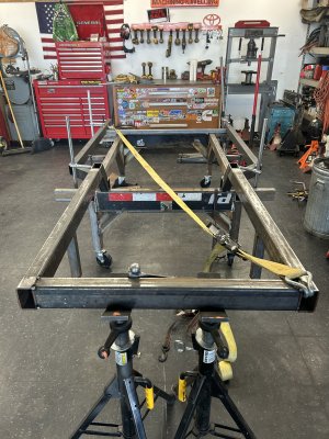

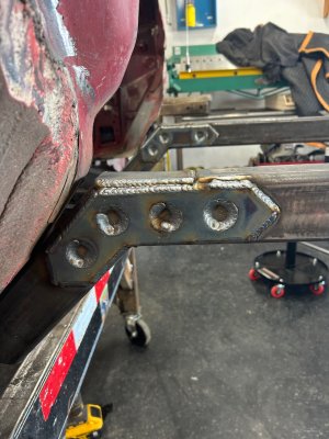

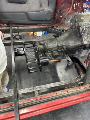

Needed to get the frame strong enough to support the motor to start working on everything else. So got it welded and the top section plated and the motor mounts in and welded. I don’t normally like to fully weld anything till I’m done but I need all this strong enough to support everything without crushing me. If I need to move it later, I’ll just embrace the suck and go to town with the grinder. I also started to try and figure out how I want to do the subframe and link mounts.IMG_6963.jpegIMG_6965.jpegIMG_6967.jpegIMG_6973.jpegIMG_6974.jpegIMG_6977.jpegIMG_6978.jpeg

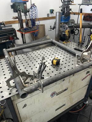

Fireball tools. Those are the “regular” size ones and aluminum. I got them a few years ago and they keep everything super square. I’d like to get a set of minions from him as well and his magnetic shims.
Awesome thank you im checking out his website now
