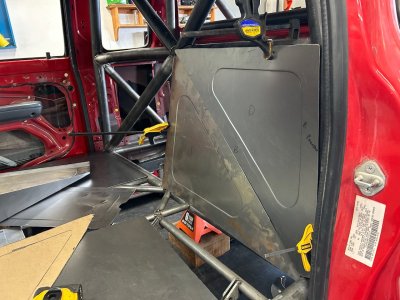

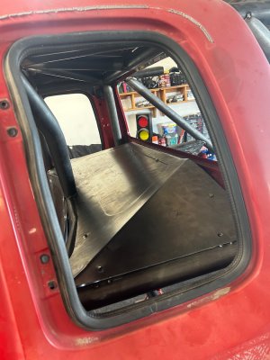

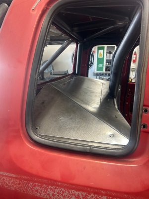

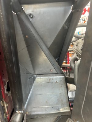

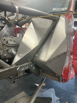

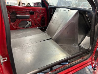

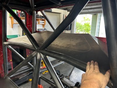

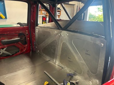

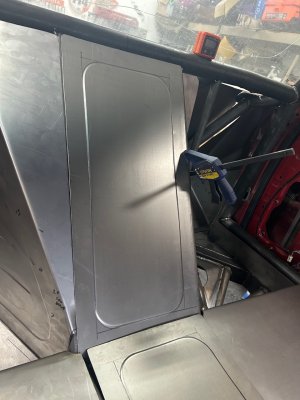

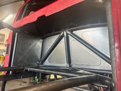

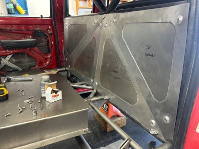

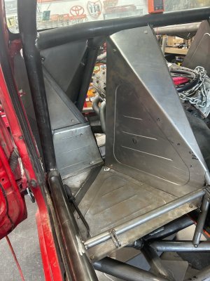

And got the firewall done behind the seats. I think I have all the panels cut and bead rolled. Only other ones I know for sure I want to do is in the top of the b pillar but I want to bead rolled and cut the middle out to add mesh to keep rocks out of the radiator.IMG_0021.jpegIMG_0022.jpegIMG_0025.jpegIMG_0027.jpegIMG_0028.jpegIMG_0029.jpeg

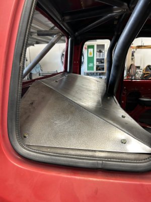

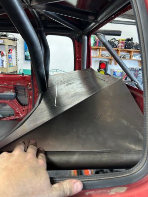

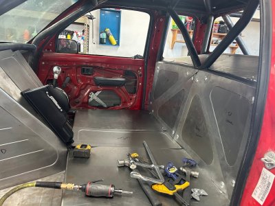

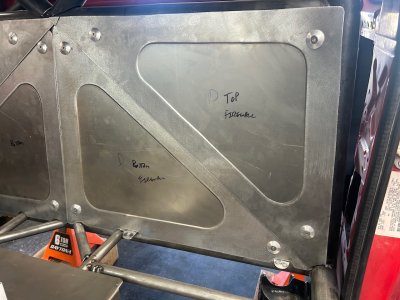

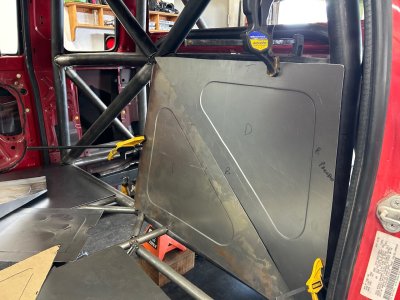

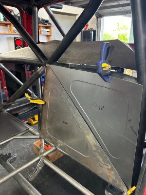

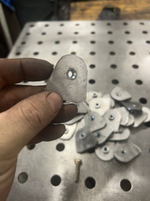

Made some tabs out of 1/8 with 1/4-20 stainless press in nutserts. Called for a 3/8 hole which I did but some push out so I put a tac on them. Starting tabbing out the panels which is a lot of work but got most the driver side panels done. I made 24 tabs and only have 5 or 6 left. Pretty happy with the lookIMG_0032.jpegIMG_0035.jpegIMG_0036.jpegIMG_0037.jpeg

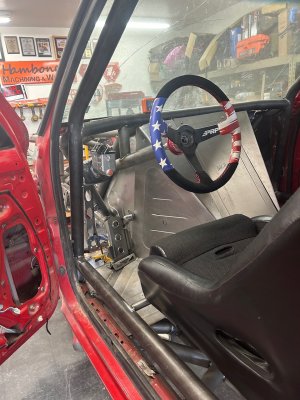

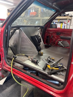

And got the firewall done behind the seats. I think I have all the panels cut and bead rolled. Only other ones I know for sure I want to do is in the top of the b pillar but I want to bead rolled and cut the middle out to add mesh to keep rocks out of the radiator.IMG_0021.jpegIMG_0022.jpegIMG_0025.jpegIMG_0026.jpegIMG_0027.jpegIMG_0028.jpeg

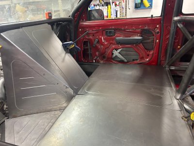

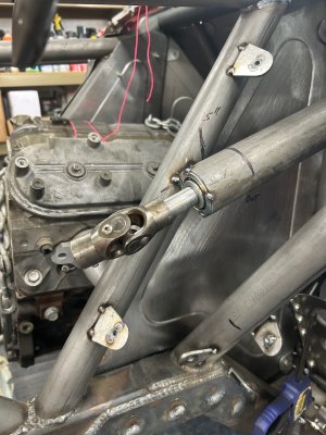

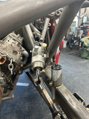

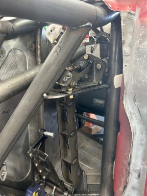

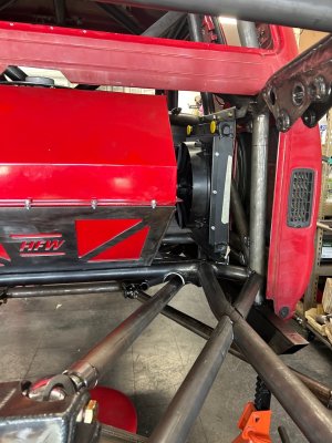

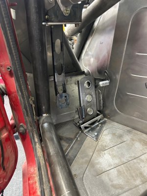

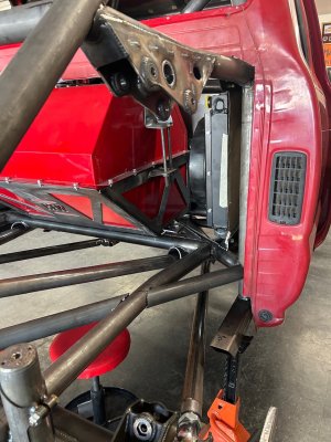

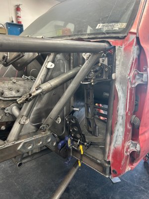

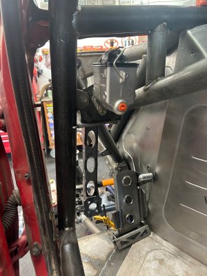

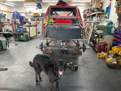

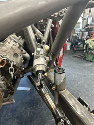

My dad’s here for a few days and we are getting things done. Steering is in minus one link between 2 u joints. Also got the brake pedal mounted. Few more tubes in the rear. Didn’t like the summit radiator I got so holding off on mounting that while I wait for a griffin one to show up. Got the power steering cooler mounted in the front as well.IMG_0072.jpegIMG_0073.jpegIMG_0074.jpegIMG_0075.jpegIMG_0076.jpegIMG_0077.jpegIMG_0078.jpegIMG_0079.jpeg

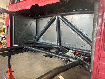

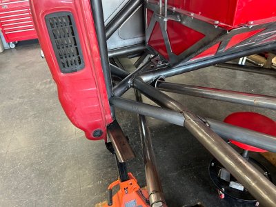

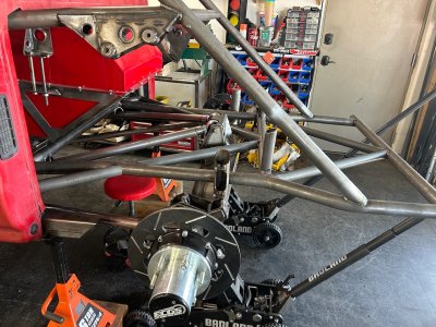

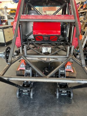

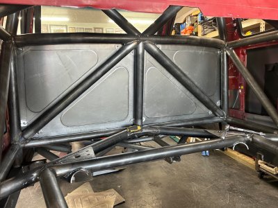

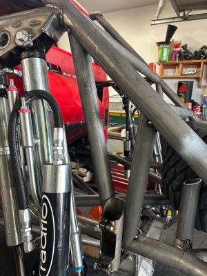

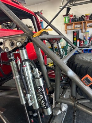

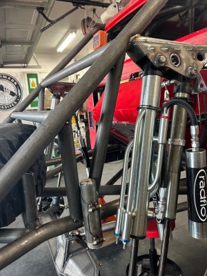

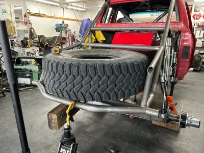

got more stuff done before my dad left. We got the trans cooler in. He got a bunch of tube in the rear and I got the gas pedal in and fit a few tubes in the subframe to brace the upper rear links. Minus an upper tube for the radiator and a lower tube over the tire, and some gussets in the front engine cage, between the roof bar and a pillar, and between the rear upper shock mounts, I think the tube work is done. The tubes sticking up off the rear near where rhe axle bumps are to keep the tire from sliding forward. There’s one set of dead tubes where the rear axle bumps but didn’t have much of a choice. Axle bumps so high it screwed up my plans to run them to the center under the fuel cell.

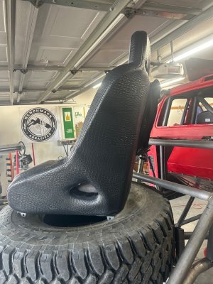

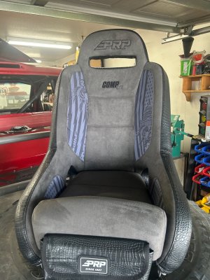

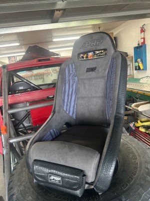

Overall happy with all the work. The air filter is way bigger than I expected so it’ll mount between the seats. Just need to find some 4” tube that’s reasonably priced. Ill end up making a dash that comes towards me as everything is to far to reach switch panel wise.

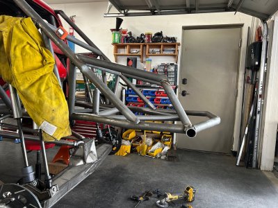

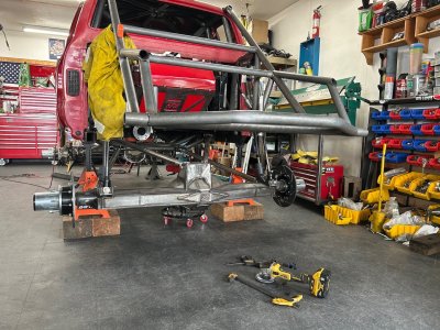

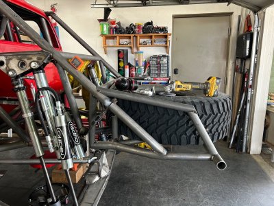

Think I got the last of the tubes in the rear and the rear bumper done. The interwebs told me the bumpstops would rip out of the frame so ran two tubes down that the bump can will weld to the back of.

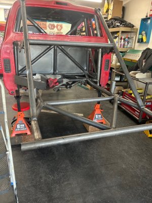

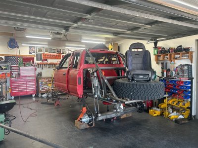

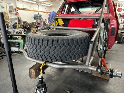

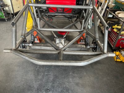

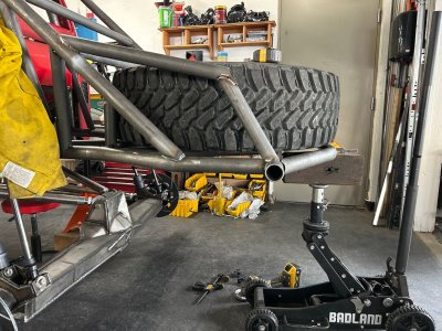

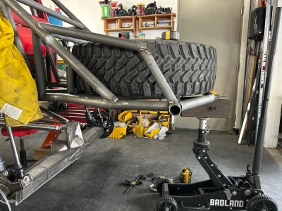

Few other gusset tubes and some side pieces around the tire to give it a more complete look and a rear bumper. A 37 should sit just inside of it. It’s kicked up about 8*IMG_0117.jpegIMG_0120.jpegIMG_0121.jpegIMG_0140.jpegIMG_0143.jpegIMG_0146.jpegIMG_0150.jpegIMG_0153.jpegIMG_0155.jpegIMG_0151.jpeg

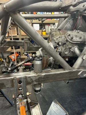

Welded out the rear of the truck the best I could. I’m hoping when the body comes off I can roll it on the sides to do the bottoms instead of laying on my back. Got everything capped and got the radius tube gussets I want in on the back and front and got the ones for in the cab cut but I’ll wait till I weld all that out. And then milled the wilwood calipers ears to center the rotor.

Finished welding the radiator mount. There’s two neighbor hood kids that asked to learn to weld and fabricate so they’ve come over a few days. Told them I’d save the wing for them to practice welding on since it’ll get ground smooth and blended. Finished the rear bumpstops and some other welding including the strike pad for the bumps. They are a little narrow so I’ll add another piece.
