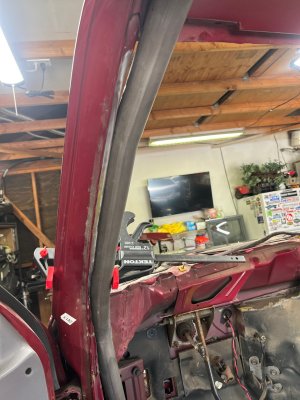

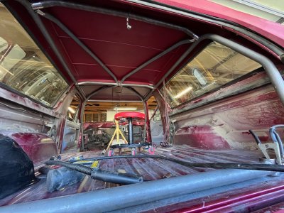

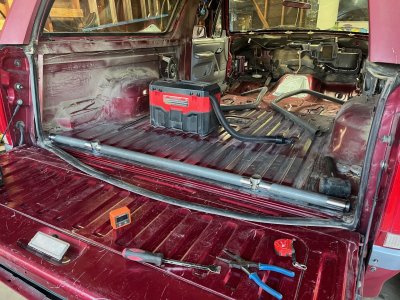

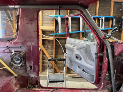

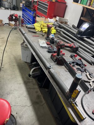

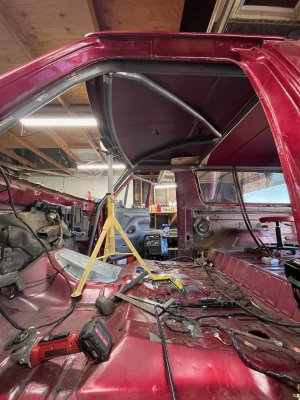

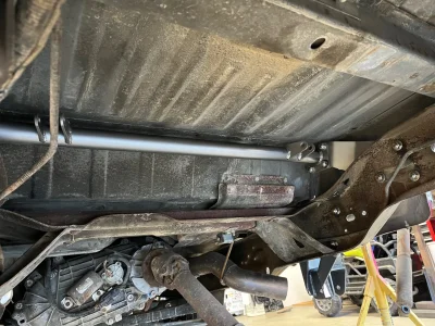

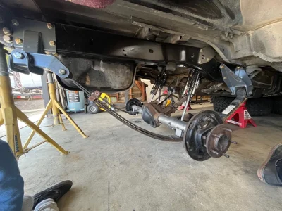

Update time! Basically the front end is done and I've been driving it for a couple weeks.  Been grinding hard on getting everything wrapped up by our new years trip. Bumps and limit straps mounted, odds and ends ect that take forever, Brake lines converted the master cylinder to -3 AN and ran all new stainless brake lines using all -3 fittings and bulkheads (deleted ABS), Final assembly mounting fuse box (not in factory location), intake, resi mounts, coolant expansion tank, bolt the entire front clip back on, paint everything, built a cross member for the radius arm mounts, new grade 9 bolts (shanked) for all the suspension components,  and all new ambulance steering.
