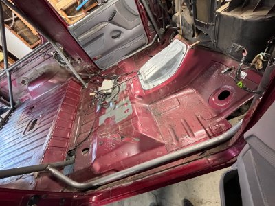

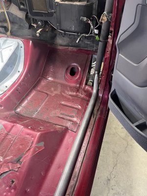

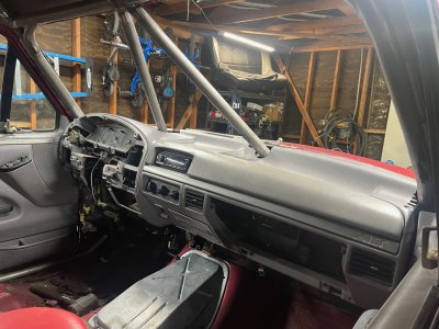

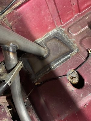

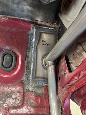

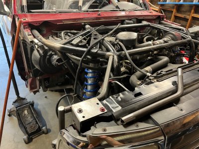

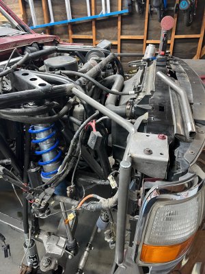

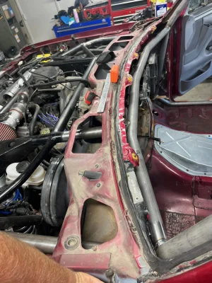

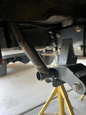

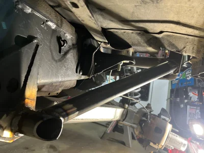

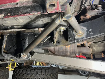

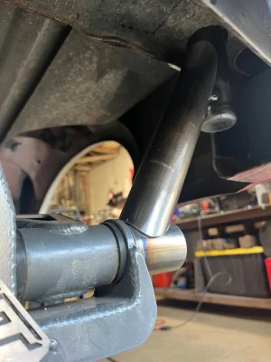

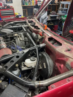

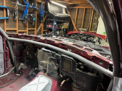

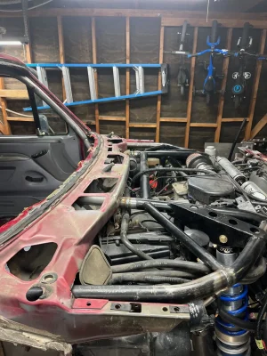

Update: I got the dash tube fitted in and all 4 tie ins from the existing engine cage to the dash tube. This ended up being a royal pain in the ass. The center tubes are sleeve with slugs so those where pretty strait forward. The outer edge tubes ended up getting but welded into the engine cage with a partition plate in the center. ( it was the only way to actually get them into place) I will add additional gusseting around that node. Then got the A pillar to frame tie in's done. The cage kit only come with the small tube going from the A pillar to the side of the frame I added the extra tube going back to the radius arm mounts. The single tube seemed pretty mickey mouse IMO.

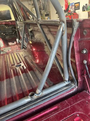

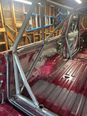

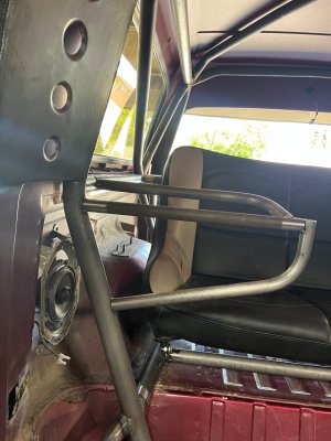

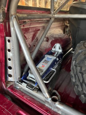

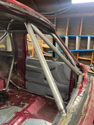

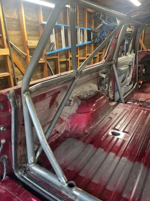

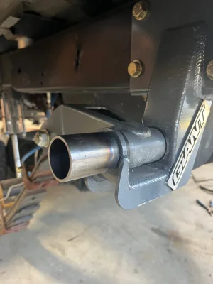

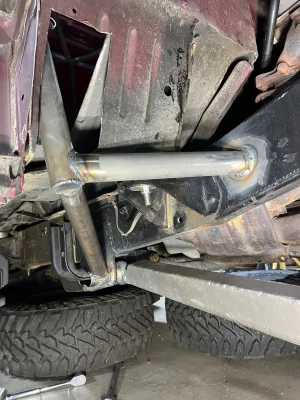

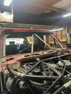

Finished up the dash intrusion tubes aka the "A" in the windshield. Also added an additional tie in for the rear C pillar to the leaf spring hanger. The rear C pillar tube runs across the back and bolts to the 2 rear most body bolts so these outer tubes are just an additional point of contact not included with the kit.

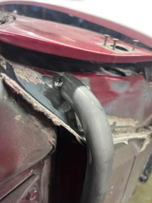

Also side note in the last picture you can see some horrendous mig welds. I cheaped out a bought the amazon special "Blue Demon" Chinese bullshit weld wire and my god it welds awful!!! DO NOT BUY IT. Back to the expensive Lincoln L-56 wire.
Just catching up on your build and digging your cage work. I really need to tie into my engine cage. Looking forward to what you do for the dash.

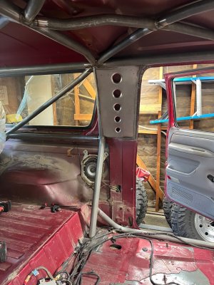

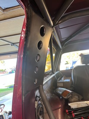

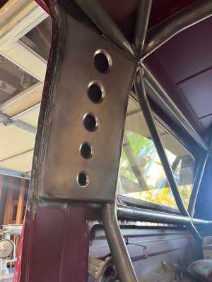

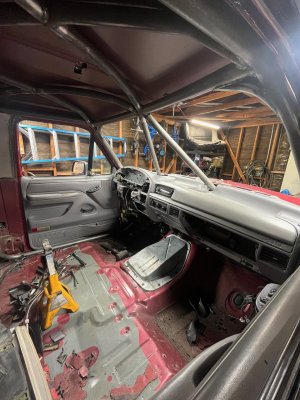

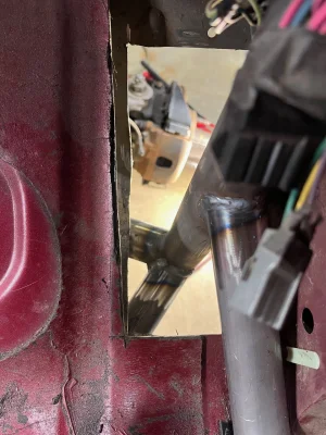

Update: I have patched the holes in the floor using 14 GA cold rolled. Patched the holes behind the dash on the firewall using sound deadener material (its behind the dash and it will work). I got the B pillar tie in plates welded in these come with the kit and are kind of the Harris Built staple to his cages. I like them saves me from building it. I'll be adding additional cab to cage tie in's throughout. Lastly I fit the stock dash into place and boy let me tell you that is one of the worst things I've ever had to do when building a vehicle. It came out like dog shit and I have no hopes it will actually last longer then 1 season!! Hats off to the guys that can fit a dash and not completely butcher the cut outs.
The dash looks great to me. Impressed you got it back in place in one piece. I pulled mine for the cage and to paint it black, but ended up putting it back in place before the cage. Didn't think I could get it in afterwards. It was still a pain. Of course it was only an option because my Solo cage has no dash or intrusion bars.

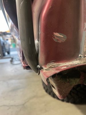

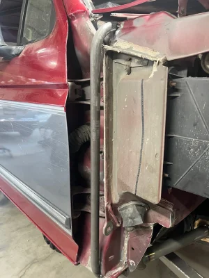

Not surprised. That duct system is huge on these 5th gens. My son and favorite cage welder had the great idea to heat that big ABS duct box with a torch just to get the passenger A pillar bar to clear and basically mold to it. It's tight plus the dash that used to flop around like crazy now is wedged in there and rock solid. Any future dash changes will involve a Sawzall.
A big upside of your gut job is you can lose the fan motor and box in the passenger wheel well. Probably not a problem with 35s but I've kissed the corner with 37s. My ghetto solution that actually worked well is black plumber's ABS cement and a piece of ABS plastic to reshape that corner.
With my current 35's I had to trim the corner of the AC box just slightly. I do plan on going 37's in the near future so you're correct now i'll probably just ditch the entire system all together and patch the firewall.

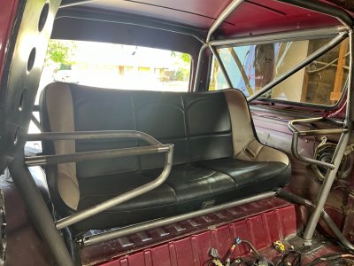

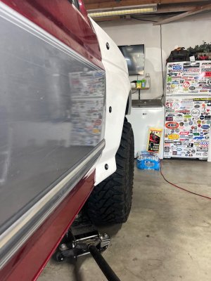

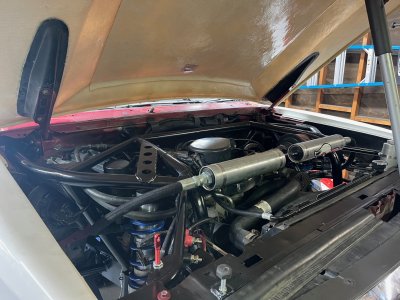

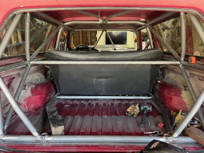

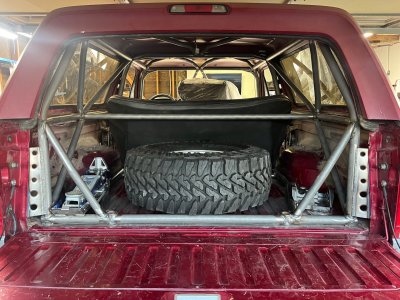

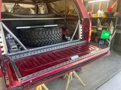

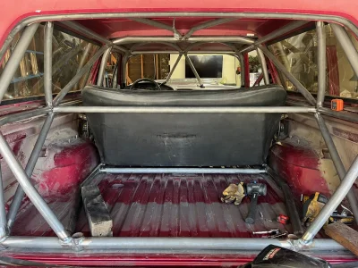

Done quite a bit since the last update. Working on this thing every night of the week for the last few weeks. Mounted the front seats (no pics doh), mounted the rear bench seat, all harness tabs and bars done, replaced the rusted out core support and build tube structure for the core support, Mounted fiberglass hood and fenders, mounted spare tire with strap, battery box and floor jack. Started a storage rack for the back that mounts above the spare tire. Note on the rack, I've always been die hard "angle iron does NOT belong on vehicles" guy but in the time crunch i'm on I broke my own rule. To combat this is drilled a shit load of 3/4" holes to spruce it up a little and give me anchor points around the entire rack to tie things down. The bottom is made with 16 GA perforated sheet. More pics on that once its done.
