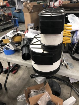

Figured id start a thread about engine filtration. The goal is maybe create a reference that others can look back on based on all your collective experience. I'm no master just like to nerd out on shit.

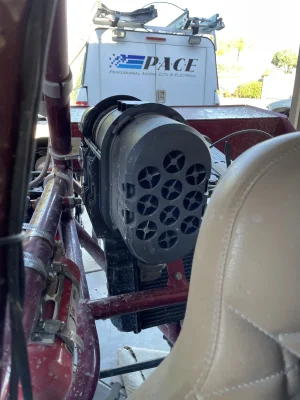

I was doing some research to combat the Moon dust we have out here. Based on what ive read it seems like Donaldson makes some good shit and running something like a PSD12 dual stage filter would match my CFM requirments for a NA 402 LS. Can even run a partical separator style pre filter so help it not pack up quite as much. I havent yet called them to confirm.
What does everyone else run?

I have a Donaldson cartridge filter on the bronco, no dirt miles on it yet so I can’t talk about performance. I’m sure it will do better than the specter cone filter that was on there before though
-it’s big, so if your tight on space already fitting a big cartridge filter might be difficult.

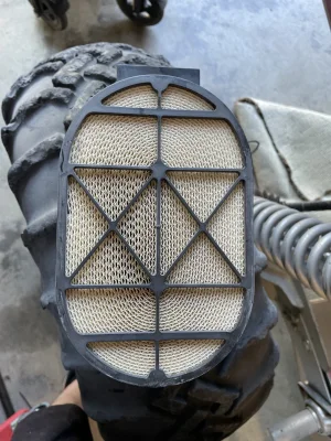

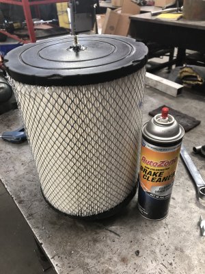

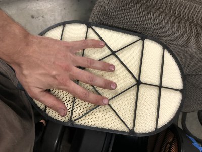

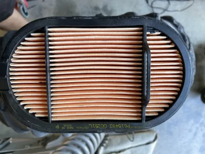

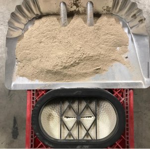

I work with construction equipment and those power core filters are the best that I have seen out there. They barely ever are caked with dirt/dust compared to round paper air filters like the one next to the brake cleaner. It seems like that prechamber box on the left side of the actual plastic filter housing is what gets rid of most of the dirt dissipated and falls out the drain hole on the bottom before it gets to the filter. Just about all construction equipment use paper filters and they live in the dirt.
Foam or k&n type filters are trash in my opinion. They are too porous and some of them rely on oil to catch dirt particles. I use Uni foam filters that are oiled on my dirtbike but Always put an outerwears prefilter (similar to pantyhose)on it to catch as much as it can before the filter.
Paper filters can hold a lot more dirt than people think. They should be tapped out routinely to remove dirt and they are cheap to replace. Some old timers use an air hose to blow paper filters out but this can put small holes in the paper filter media and then allow dirt to flow right into the engine. There is no reason to blow a paper filter out, just replace it and move on.

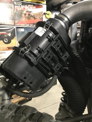

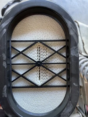

I also converted from oiled foam filter to a Donaldson paper filter. I could only get one run out of the oiled foam filter. The secondary paper filter looks brand new after a weekend of following a pack of cars.
