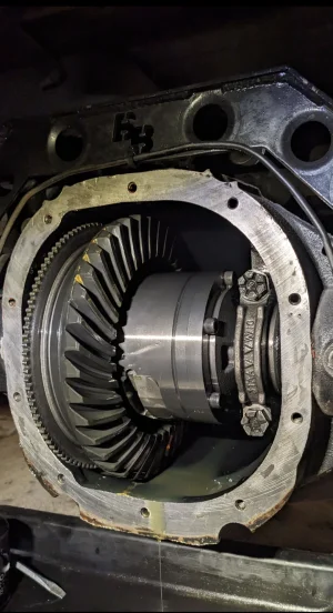

I ran the spartan lunchbox locker for almost 2 years with it only "slipping" twice. Once while going about 45 on razor burn and once when going in reverse under a hard load. Besides that the locker helped take me many places that the open rear end wouldn't have.
In September 2022 i switched over to a detroit locker which has worked flawlessly. It has the same street manners as the spartan and has a loud pop every now and then when loading or unloading from a turn which is normal. It is basically silent when turning compared the the spartans loud ratcheting.
I also switched to 4.88 gears at that same time and it made the truck come alive.

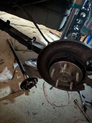

New left rear wheel and axle shaft as seen in previous post. (Might need to get in touch with the man @theycallmeWALLY and get some methods going soon). Bent wheel used as spare now instead of steelie.

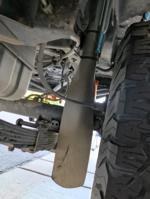

Shock shaft guards for rear bypasses.
