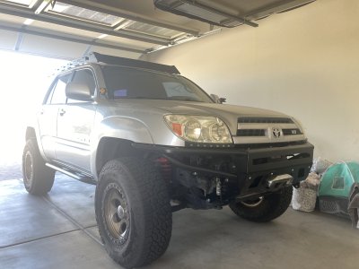

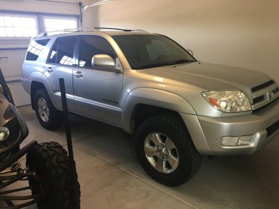

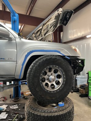

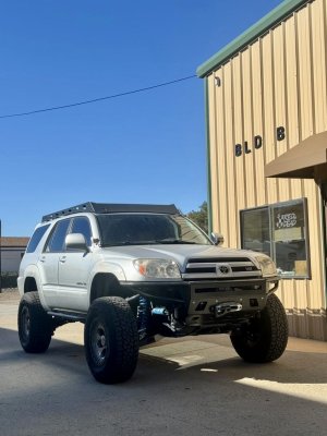

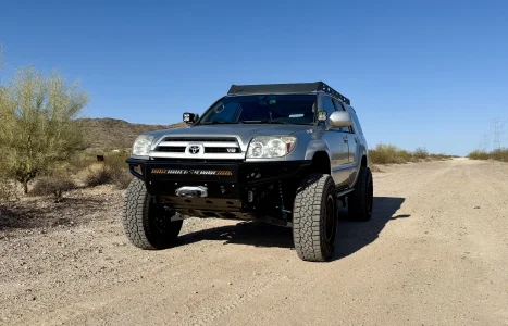

Started with a stock 03 4runner to enter the Toyota world

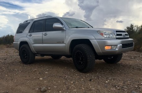

Then did what we all do first and got new wheels

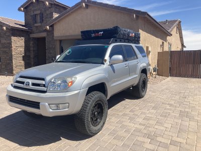

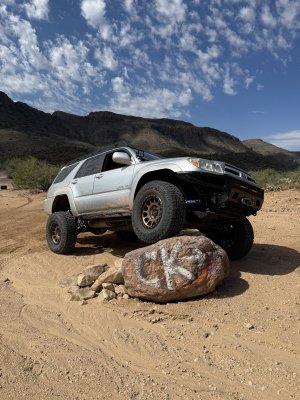

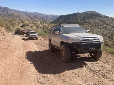

After some time I went the overland build path and got a 2.5 lift with 33” tiresIMG_2624.jpegIMG_4323.jpeg
as of now

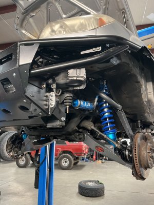

Front:
+4 JD Fab long travel
Jds spindle gusset
JD fabs 934 axles
King 2.5s
Marlin Crawler lower cam gussets
Rear:
Fusion 4x4 fabricated 9”
2.5 Bilstien double bypasses (tundra spec)
Arb air locker
Apache off-road rear links
Other:
ARB single compressor under hood
Rear drawer/tire carrier (work in progress)
456 gears
Ascend Fab front bumper
Badlands 12K winch
Auxbeam switch panel
Method 17” 0offset wheels
285/75r17 wildpeaks (34”ish)
Yeah man there are getting harder to come by! Luckily I found this one that spent its whole life in Az so no rust and only 118k when I (actually my wife) found it!
