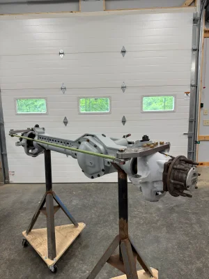

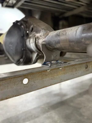

Front Axle: 2015 D60 with MoFab keyed high steer arms, Barnes truss
Rear Axle: Sterling 10.5 with Artec truss

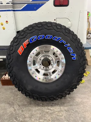

Wheel/Tire: Sidetracked Off Road 17" forged bead locks, 40" KR3

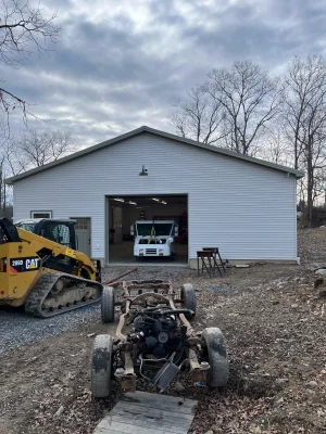

I started by building a simple chassis table out of some channel, and then dove into stripping the LLV. I knew I wanted to challenge myself with a full chassis build, so only the body was saved. I had a 2000 Chevy Suburban for a motor/trans donor. Stripped that, and kept all the misc./wiring, although I'm leaning towards a Holley Terminator or similar. I tore down the axles so I could properly pre/post heat them during the truss install. I rebuilt and repainted the NP205 and mated the ORD Magnum to it.
Current State:
As of this post (1/1/26), the body is on stands. The motor and trans are roughed out onto the chassis table, and the front axle is positioned. I need to cut some of the floor/firewall to drop the body lower, and further back.

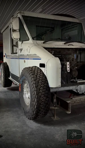

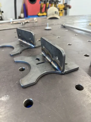

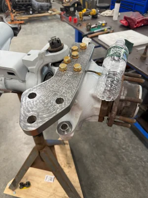

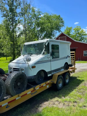

on trailer day 1.webpskidllvshop.webpstripped body.webpwheeltire.webprear truss.webpORD Box.webpD60 w arms.webpmofab arms.webp

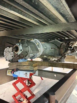

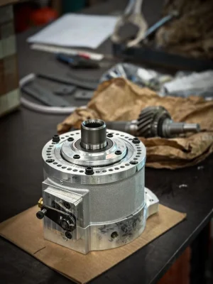

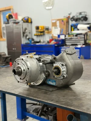

NP205 with ORD Magnum:

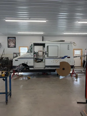

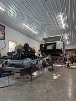

Sliding chassis table under body:

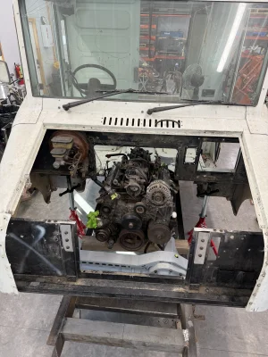

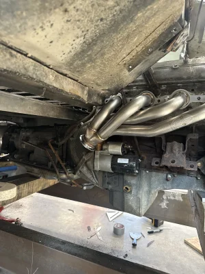

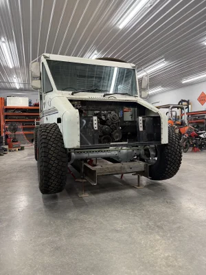

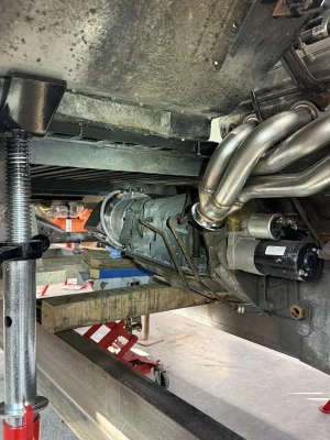

Engine location in relation to front axle:

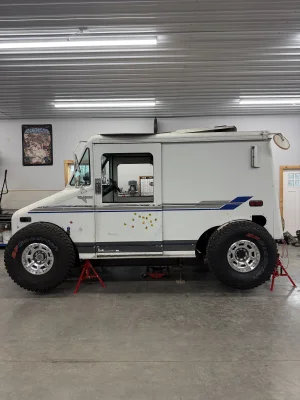

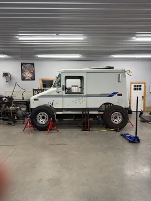

116" Wheelbase for reference:

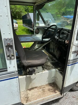

You're right about the deceivingly large amount of space inside. Obviously needs to stay RHD, and I want to retain the swivel driver seat mount. I'll fab brackets so I can swap between the passenger seat and USPS parcel tray that I saved. (feel like having an interior picnic table on a solo weekend trip would be so badass!) For the cargo area I have this idea to use (or fab something similar to) T track on the floor, and build mounts for the rear bench seat and spare. It would allow some modularity. TBD if T track would be strong enough to retain a seat with passengers and a 40" spare in a crash or rollover. But I'll get to that.
Thank you again for the reply and info! Much appreciated.
Can see the interior tray in this photo from the day I brought it home. A LOT of pressure washing, degreaser, and bleach after this was taken.

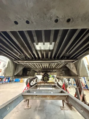

Good angle from the back:

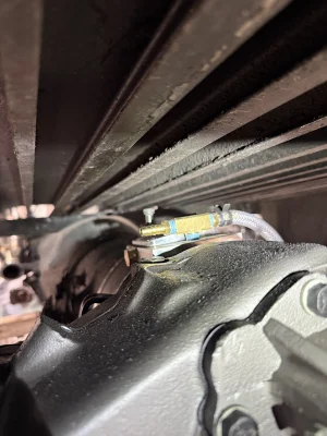

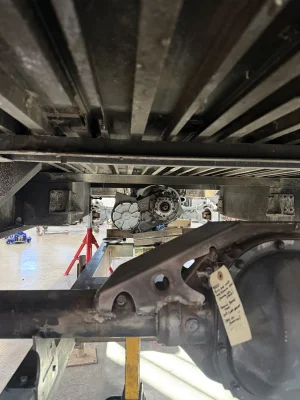

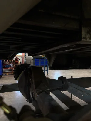

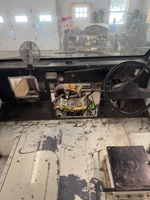

Topside view from in cab. Motor is centered relative to the body in this photo.
Looking at the first underside photo; I want to chop out the floor enough to slam the body down over the bellhousing. The drop step/rockers will be low- but the plan is to build and integrate a minimal "slider" off the main chassis rail to protect them. The body itself is 6' tall overall, so any creative ways to keep it low (within reason) will be ideal.
I thought about chopping 10" out of the bottom step area and sliding door - but i think it will lose some of the step van feel.... lots of compromise!
