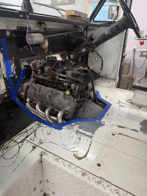

Topside view from in cab. Motor is centered relative to the body in this photo.

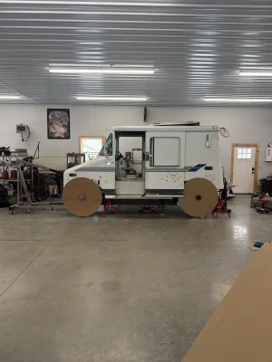

Looking at the first underside photo; I want to chop out the floor enough to slam the body down over the bellhousing. The drop step/rockers will be low- but the plan is to build and integrate a minimal "slider" off the main chassis rail to protect them. The body itself is 6' tall overall, so any creative ways to keep it low (within reason) will be ideal.
I thought about chopping 10" out of the bottom step area and sliding door - but i think it will lose some of the step van feel.... lots of compromise!
Might be a dumb question or you already said it but will you be keeping it right hand drive?
Made some progress on the mail truck this weekend. I set the motor back an additional 5”, so the balancer clears the front axle currently. I pushed the rear axle back 2” and am looking at 27” from pinion flange to T case output.
I’m now playing with body to driveline clearances. Currently the body clears everything I have at full bump (except tires and suspension!), and I have 1” from underside of body to the TCase shift linkage. I have enough room for rear upper link mounts to clear the body, and plan to cut out and rebuild the cross brace that runs over the rear axle to get some more up-travel clearance.
It’s looking like it’s going to be taller than I hoped, but I guess that’s to be expected with wanting to keep the cargo floor flat and a body that’s 6’ tall from rocker to roof!

Made some progress cutting the floor and clearing the motor.
As it sits!
Body in place, 118” WB, 40” tire
Crazy how much time gets eaten up by squaring, leveling, cutting, and repeating!
I also have been playing around with Bend Tech. Should get first run of tube ordered next week.
Plan to do rectangular tube for the main lower rail, atleast 2/3 front to back- and transition to 1.75x.120 DOM for sub assemblies and the cage.
Any opinion on rectangle tube size and pros/cons of something like 2”x4”x.188? (other than weight!)
