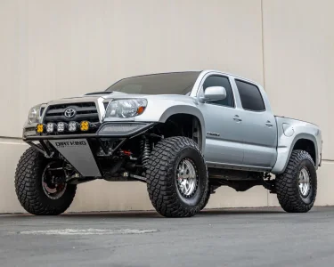

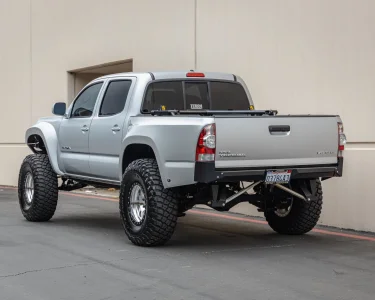

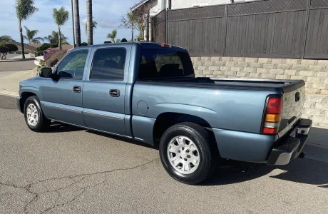

After 3 years of building and enjoying my Tacoma the day came where me and my family had outgrown it. As much as I loved the truck a midsize truck with a 5 foot bed was not practical for us so I decided to sell it and move onto a fullsize. Taking advantage of the outrageous truck prices during covid I posted the truck for well over what it was worth and managed to sell it for my asking price in 2-3 weeks.

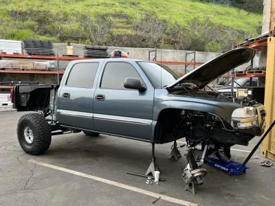

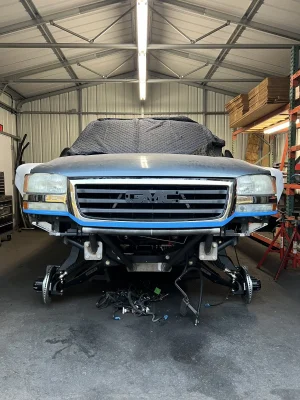

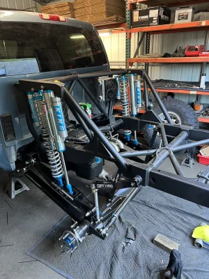

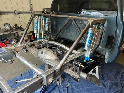

From there I was on the hunt for a ultra clean Silverado, after 3 months of searching I decided to expand my search to a Sierra and was able to find this one owner crew cab exactly like I wanted (minus color but I can live with it) with only 45k miles. I began ordering parts through my work (Dirt King Fabrication), the goal was to keep a bed, at least 4 seats and all the creature comforts I would want.

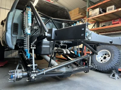

Quick list of parts

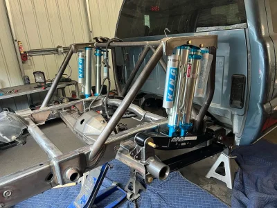

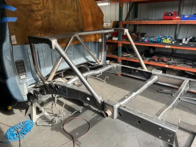

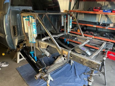

Dirt King Fabrication Race Kit

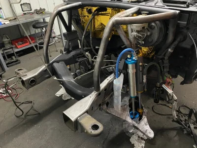

King 2.5 coilover, 3.0 bypass and 2.0 bump stop package front and rear
Mazzulla hubs front
Wilwood brakes front and rear

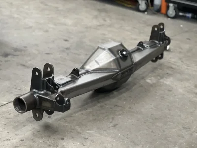

Dirt King Fabrication full float axle with EWR 10" 3rd member
Dirt King Fabrication Ultra 4 link kit

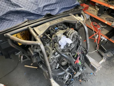

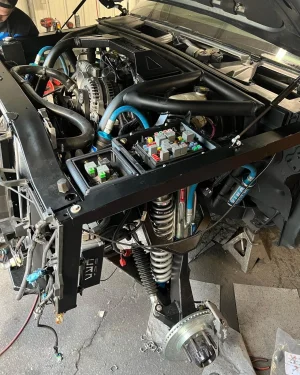

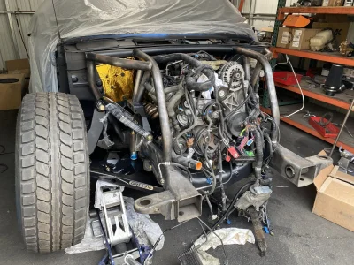

Dirt King Fabrication Engine Cage

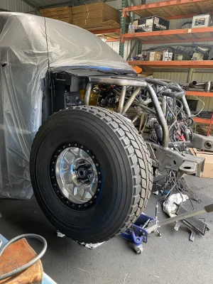

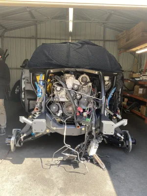

I had a majority of my parts within a few months minus shocks, I had originally ordered the shocks through fox and after 8 months on a 6 month lead time I switched to king and had them in 8 weeks.
From here progress pics were pretty minimal as we were building this truck after work and weekends the main focus was on getting stuff done I should have made more of an effort but here we are.

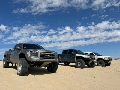

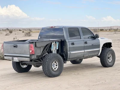

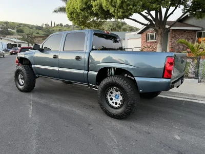

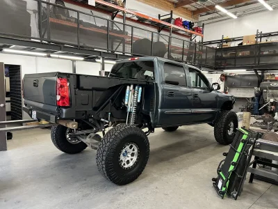

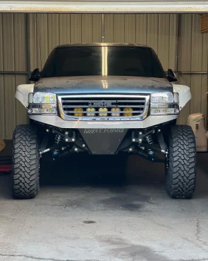

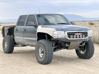

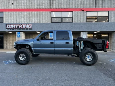

At this point the truck is done and driveable. Finished it on a Friday night and saturday went on my first trip to Ocotillo and made it with no issues, fullsize linked truck was the way to go and Im glad I made the move. Last pics of how the truck sits currently, plan is finish my electronics and have the truck caged and seats this summer
