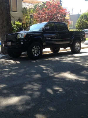

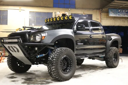

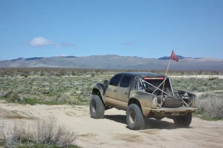

Alright guys I’ve never done a build thread on this truck. I’m going to give it shot here and see if I remember the long process it has been. It’s a 2008 Tacoma trd sport four door 4wd. I was fortunate enough that my parents got me this truck when I was 16 in 2008. I worked all summer that year to buy a 3” spacer lift and 33” tires with some sweet chrome eagle alloy wheels 😂. Other than that the truck was stock and I drove it like that for 6ish years.
2014 is when I decided I wanted to build the truck into a prerunner. It’s a long story but I had a bad injury on a quad that put me out of work for a while. After that I realized I needed to hang up the quad and dirt bike riding and get in a cage. I was making ok money as an electrician so I did a bunch of research and started ordering parts and just stacked them up in my garage. The truck was still my daily driver, so I would work on it on the weekends but have to have it buttoned up Sunday night so I can get to work the next morning.

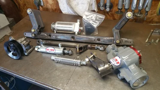

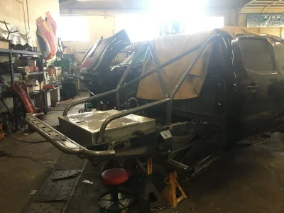

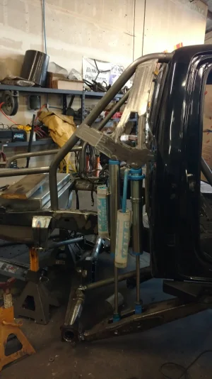

Two years later in 2016, still continuing to stack parts and save money. I got the point where I took the truck as far as could with my skill level. I got in touch with Steve at Dirt Designs, where he was going to cage the truck and set up a spring under rear suspension. I dropped the truck off and he got after it. Well things snow balled a little 🤷‍♂️. Steve convinced me to do a 3 link with a pan hard. We kept the stock fuel tank and trussed/tabbed the stock axle. We also decided to do a swing set steering because it’s pretty well known the tacoma rack’s can’t hang. He also did a bunch of miscellaneous fab work that I was not capable of.
Maybe like a year later like late 2017 I started having transmission issues. The stock trans did like the power from the supercharger and the jump/smashing whoops probably didn’t help either 😂

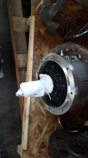

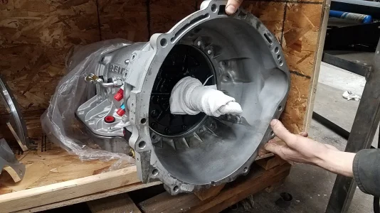

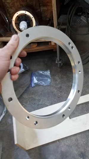

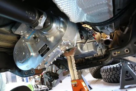

Well I went through this transmission issue for a year. I had the stock trans “built” but it would only last a trip or two. I brought the trans back twice to the guy for warranty repairs. You can guess it, the trans didn’t last. I was so fed up with it, I said screw it buy once cry once. I got a built th400 from maximum transmission and an atlas transfer case. I brought it to Steve at Dirt Designs and said let’s try to figure out how to make this work. Steve designed an adapter to adapt the stock bell housing to the reid case of the th400. We then had a torque converter built by tcs out of havasu. We put it all it and sure enough it worked.
After getting this all sorted out the truck has been solid with minimal issues over the years. I have done little changes here and there. I’m sure there’s stuff that I’m missing. The truck needs a good prep right now. There’s a couple upgrades that I would also like to do. I’ll post up on this thread as I work on the truck. My wife and I just moved into a new house and I’m just finishing setting up the garage. As long as life doesn’t get in the way, I can start getting the truck ready for this next desert season.

What did you do to make the computer happy with the new trans? Just set it so when it is in drive, the ecu thinks its neutral?
Sean
Sean
We left all the electronics unplugged that went to the stock transmission. When we turned the key everything worked except the starter wouldn’t spin. We tried plugging in the stock shift thinking it was a safety, but that didn’t work either. We ended up wiring the starter on a push button. Turn the key and push to start. It works and runs good. Idk what the computer thinks 😂. I do have a piggyback ecu to tune for the supercharger, idk if that has any effect.
Id bet it is still looking for the resistance of the shift/lockup solenoids, the speed sensor input on the trans, and the neutral safety switch. If running the "bypass" starter button works though, I wouldn't screw with it.

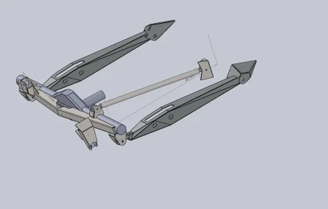

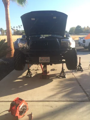

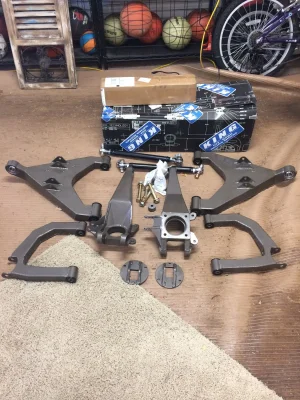

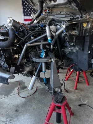

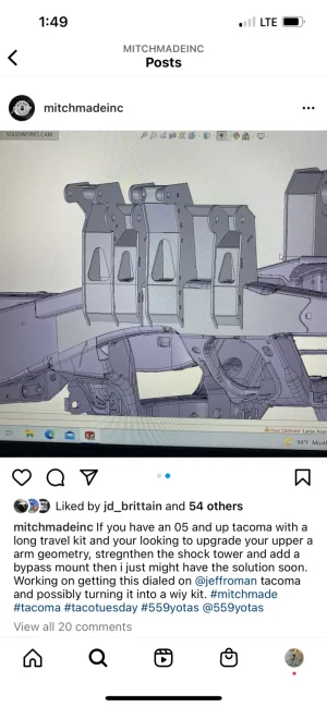

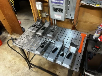

Finally getting around to working on this thing. Since the front suspension is a bolt on LT kit, I’ve been having a problem with the coil buckets starting to crack. I bought this setup from mitchmade like 2 years ago and this is the year I’m finally going to put it on the truck 😂. It deletes the coil buckets and gets rid of a bunch on the anti dive the upper arm has on these Tacomas. Got it all prepped and tacked together this last weekend. Hopefully I don’t booger weld them together to badly 😂
Not being a Fabricator I won't to pretend to know shit, but at $600, this kit seems like a steal.
Hope it goes well for you.

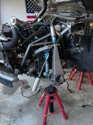

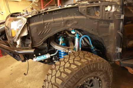

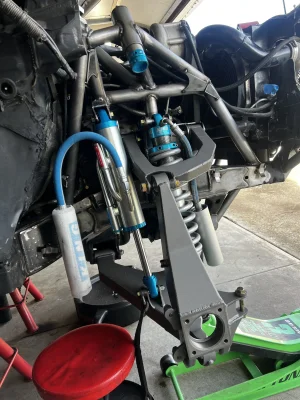

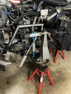

I haven’t been doing a good job keeping up on this thread. Here’s a little update of the past few months working on and off on this thing.

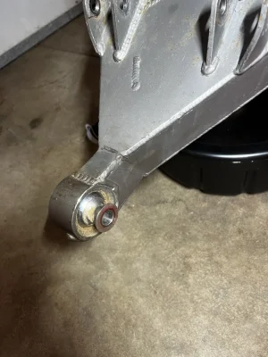

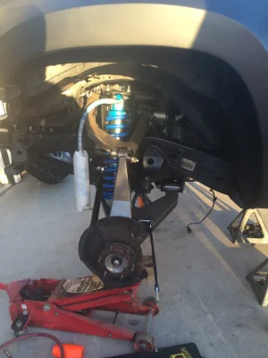

First thing is this truck was definitely due for a good tear down and prep. There were a few bent bolts, blown out heims and uni balls. Also check out the cracks on the LCAs

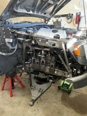

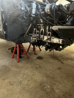

So added that to the prep list. Once I finished disassembling the front end, I started to cut off the coil buckets from the frame and cut back the cage tie ins. Cutting and grinding sucks so bad 😂

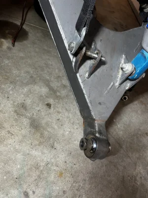

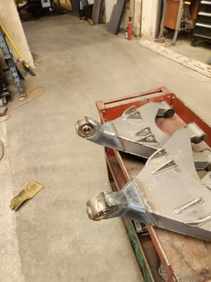

Also got the lca fixed up. Nice and beefy now.
Not a fab guy by any means, so I’m just winging it with an angle grinder, chop saw and a cheap mig welder. I’ve accepted my fab work and welds aren’t going to be as nice as the professionals I follow on instagram. As long as it’s strong and gets me out in the desert then I’m happy 😂

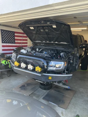

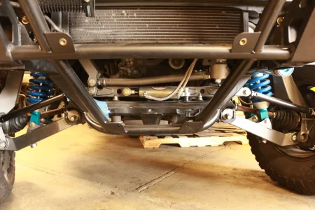

Truck is so close to being ready. I have all the major fab work done, all that’s left is the little time consuming work.
I have all new properly shanked hardware. Rebuilt c/o with new springs and new 3.0 bypasses. All fresh uniball/heims and paint. Rebuilt the cv axles.
All I have is to make brake lines, finish paint, alignment, and a lot of wiring 🤦‍♂️. I wanted to clean up all the factory wires under the hood, so I have everything de-loomed. That’s going to take some time to re-work. At that same time I decided to rip out all my accessory wiring to put in a switch pros.
I have my work cut out for me because I was trying to push to make it to KOH. I’m still going to do what I can to finish but if I don’t, I’ll probably still roll down there. I’ll just take my camper and ride passenger in my buddies truck. At least that would still keep the motivation high to get this thing done.

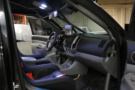

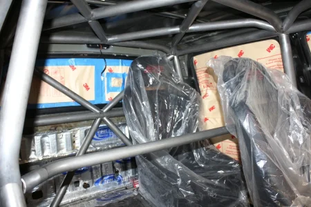

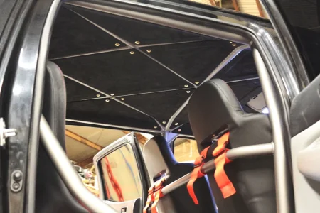

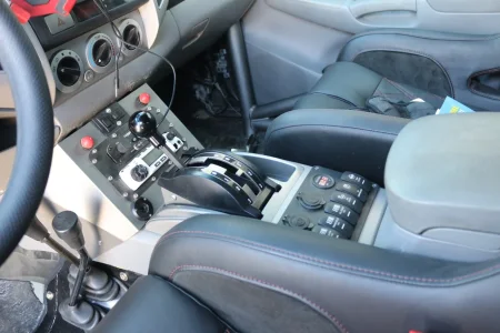

man your headliner situation is pimpin'
do you have any details on how that's done? is it a couple of tabs off the frame pulling a section of upholstered foam up?
