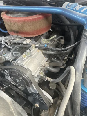

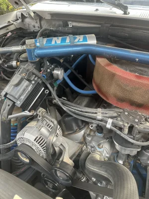

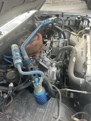

Yea I opted for the Holley HyperSpark distributor and ignition so I can control the timing through the same computer.
Fuel pump is basically stock. Stock type, maybe slightly higher GPM.
