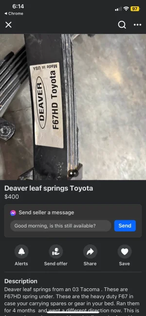

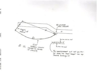

I just did the inserts, I’m just 20 minutes from deaver so I was gonna head there FridayDid you get the leaf springs coated or just adding the inserts between them? I’ve been DM’ing Mike about buying the inserts from him. I have a regular H70 set with 0 miles in them on my truck I need to swap for H70HD’s. How much time are you looking at before getting the HD’s rearched?

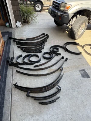

When you do the rearch are you going to be adding the 2 leaves you removed? This kind of stuff interests me because I need about another 1.5 inches of ride height in my truck and I have a few options with H70’s and H70HD’s waiting to go on.I just did the inserts, I’m just 20 minutes from deaver so I was gonna head there Friday
I don’t think I will but hang on to the last 2 for when I get more weight on it.When you do the rearch are you going to be adding the 2 leaves you removed? This kind of stuff interests me because I need about another 1.5 inches of ride height in my truck and I have a few options with H70’s and H70HD’s waiting to go on.

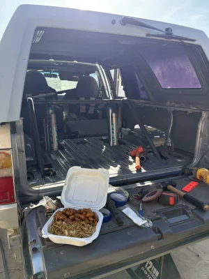

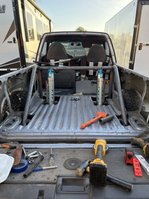

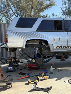

It rode pretty stiff this weekend, didn’t bottom out. Had about 4” of unused shaft
Yea probably right around 4, almost debating just getting an f67 packI’d imagine it would because most trucks are 5-6k lbs for HD’s and I’d imagine your 4runner is 4-4.5kish at max?
That’s what I’m thinking, add some weight and run it. I did weld my front hangers about an 1” too far forward so that could contribute a little but I don’t think it’s worth cutting them out and redoing it. I’m using 12” shackles above the frameId stick with the H70 at the very least. Ive got a 1st gen 4runner built similarly to yours with whats essentially an H70HD pack, and when Im fully loaded for a trip I could use a couple more inches of ride height out of it/them. The only difference between our 4runners is that Ive got a 1.5" cage (and w/o going back and looking at the pics of how you did the rear of yours, Im running TC 9" shackles under the frame).

Trying to track down f67s right now cause I don’t want to pay full price, but I’ll for sure let you knowIove these 1st gen 4runners!!!
If you decide to sell the HDs down the road I’m planning to move up to them at some point, hit me upRunning an old re-arched 50T pack currently
