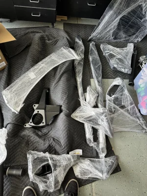

Little update. Got a bunch of stuff back from powder coat. Getting closer to assembly. Currently in the double checking hardware phase. Made a big order a while back at Allen’s and never checked it on the truck. Almost everything I ordered isn't the correct shank and the threads are sitting where they shouldn’t be. So trying to get everything properly shanked before I go to put everything on. Spent all this time trying to get it right, not gonna half ass it now.

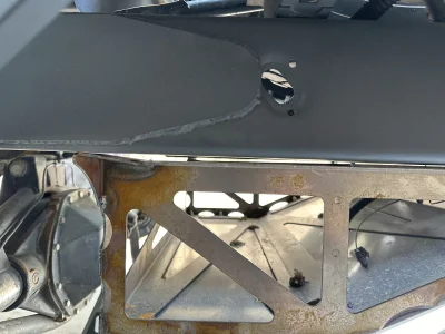

Also ran into an issue with the Izzy fab fuel cell cradle. Website shows his cradles being flat across the entire portion where it mates to the frame. Mine is kicked and I have a fat ass gap between the frame and the cradle. So currently trying to figure out what to do with that at the moment. IMG_3658.webp
