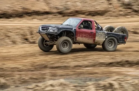

Some shots from the last race we were at. Got first in class!
We had 4 trucks from our Southeast Pre-Runners crew out there! Hopefully have a few more in the coming events

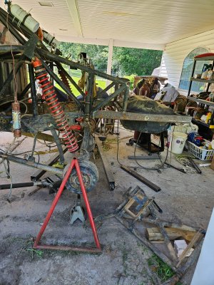

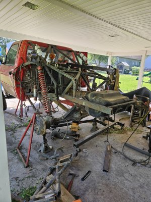

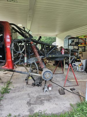

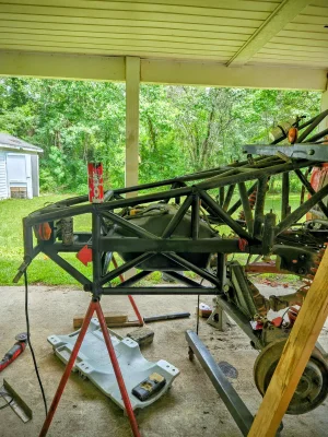

What year Chevy?
I can't remember the date range but it was from the 80's or early 90's.

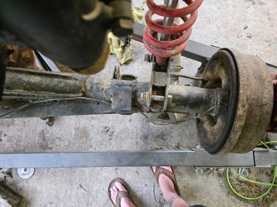

If you use the main leaf from those trucks, you can get it from a junkyard or maybe even a replacement main leaf off of one of the off-road websites. And then find one of those old SUV style Jeeps. I think they're XJ or something. They have the same width leafs as the main leaf on the Chevy. But there are way thinner. And there's more of them. And so you can kind of mix match on with the ranger leaves and figure out what's going to give you the best ride height and everything like that.
When you put those leaves on you have to move the front leaf hanger forward. And highly recommend flipping the rear shackle
Yeah sounds like you got 63" chevy leafs that are 2-1/2" wide. I ran same leafs on my first toyota i build in high school. Added a bunch of random leafs I had to the mail leaf and it worked decent for the low cost of free I had into them.
