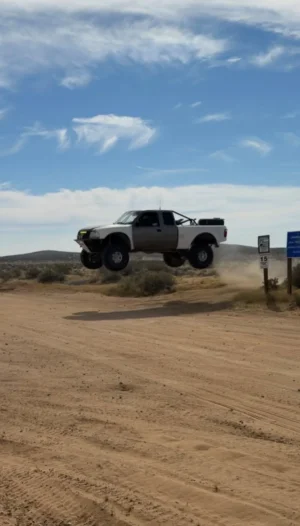

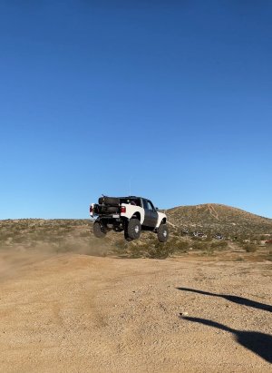

I understand this is a pre runner and not a race truck but it still seems like a bad idea imo
Wouldn’t it be a lot easier to just find a spot (like filling the rear bumper with/ ) and or just adding some tabs to the rear carrier and welding / securing 1-to a few ammo can boxes and filling them with the lead bead balls used for interior tire balancing… used or for adding weight in specific areas to a vehicle? A 30lb bag is like $100 on amazon.
I always preferred to attach and secure multiple locations using this method that way you can play with the locations while working on shock tuning. The .50cal ammo boxes is what I always used and would just weld them shut. Just big heavy bricks you can adjust as needed. .
Shit even just weighing the two tires before and after filling with tire slime might get you close enough lol… unless the weight plates are just conversation starters.
Dealing with plates on a spare sounds like a nightmare and or an accident waiting to happen, especially for the buddy trailing behind you in dust when next thing you know a 35lb plate comes smashing into your truck lol.

Yeah. Still toying with the idea. I like the weight further out back. But the falling out part is what scares me the most. There was someone that posted this in the spare tire on Facebook. But their tire was laying flat in the bed. So if it came loose. It had no where to go. Might scrap it for safety reasons.

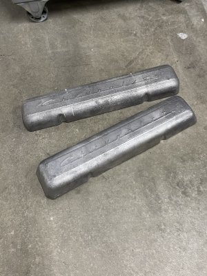

I do have these lead valve covers that are the exact size and replica Chevy valve covers. They weigh 48 lbs a piece. But they are super rare. Speedway motors made them many moons ago for ballast in drag cars or circle track cars. They would work perfect down the frame rails. But way too rare to use them. Still haven’t seen another set come up.
Yea, there are way cheaper options than using those valve covers, which are like fine art!
Figure out the furthest spot to weld in or bolt on some square tubing. Fill it with sand, or lead, or the heaviest material you can.. then cap it shut. Don’t see why you couldn’t do a heavy square cross bar spanning the frame rail just like your dimple died piece. Solves your support and weight issue in one. Lowers your COG weight too which will help. It looks high off the back. Just dropping those spares down into a caged “bucket” would help a lot,
Don’t kill someone with aluminum and a weight plate floating off the rear and coming loose lol.
I think you’re overthinking how much weight you need. Yes, more is better, but load up the bed with camping gear, loaded ice chest, tools… and you’re doing pretty solid to get those springs working well.

Yeah. This was mainly for the day trips he does. Something he can slap on with one bolt when there is no camping gear or the coolers are empty. Thought that something back there would help some. Especially since these are new springs still.
But I agree with everyone else. First it seems to dangerous if it were to fall off. If the tire laid flat in the bed. Different story. And second there are better ways to achieve some weight back there when needed.
We can file this one in the trash can.
If it were me, I would get corner weights first. Then move weight from front to rear where needed. Fuel tank/cell behind axle and run one spare.
Rare parts are old parts that are used still it won’t do any good not being used.(Dick way of saying it but I just mean why hold on to something if it is worth money and not use it or sell it I grew up seeing the same thing and never understood it)
I take it you’ve never been a collector of something. It’s no different than the people that collect Hot Wheels. Which by the way I have about 1500 of those. Those lead valve covers are on display in my garage and I see them every day. Which makes me happy. I collect a lot of various antique stuff. To the point Im starting to flip some of the stuff I find and don’t care about. And it’s about the hunt and getting that super rare item that’s very hard to find.

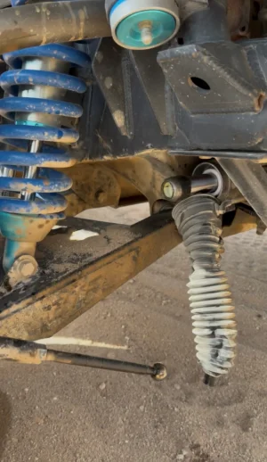

Too many of these the first day this past weekend. Plus a rain rut at 45-50mph that he came up on too fast and couldn't avoid.
Pretty much lead to the steering rack to leave the party the first night. Some days you win, some days you lose.

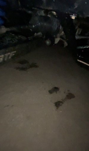

Screen grab from a video when he stopped and said he lost all power steering out in the desert. Hmm with all those puddles under the truck. I wonder why.

Yeah. I need to talk to Tyler to see how these mount. I think the front bumper might get in the way.
Also my kid is going to buy the Camburg inner tie rod clevis kit. Since on the the last prep we noticed a little play developing in the ball cup area of it.
Between the rack saver and the clevis kit, I think its about all you can do to save the racks. I did see that someone braced the back of the lower arm mount with a 45 degree bar. They said the arm mount flexes on hard hits and can cause steering rack issues.
Just to add to this, a few of my buddies that have/had A arm rangers with the factory racks still noticed a pretty significant increase in life once they strapped the front ends a bit shorter. We concluded that the racks break from the tie rods having more extreme angles at droop applying upwards loads to them. Strapping them an inch or two shorter seems to have helped them last longer. And there was not really any noticeable performance difference from 16” of travel to 14”

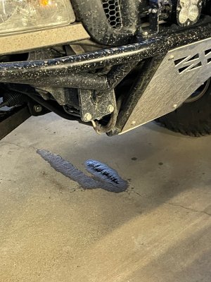

Got the new steering rack in along with a new pump, and all new lines. Might as well replace it all just to be good.
Kid had his truck out at Spangler Hills or new years.
10 miles into the first day of a 5 day trip. He was running some whoops and some pretty heavily washed out ruts on the trail.
Gets back to camp. Noticed fluid all over the passenger lower a arm. Crawl under to see what it is. Fluid is leaking out of the boot on the passenger side steering rack. Seams like the seal is gone. Not sure if the new rack flexed and cracked or just tweaked the seal. Cool. Told him to just keep topping off the fluid and run it. Nothing we can do about it now.
