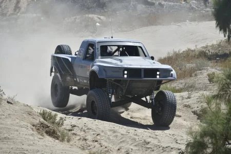

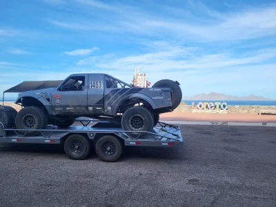

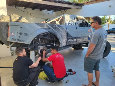

Day 4- San Ignacio to Loreto, a total of 210 miles. This was a straight shot and limited access to pit services for the day. Knowing that we wanted to take a more conservative approach, 10 miles into the race, everyone is stacked up in the dust on a fast road; as we approach to pass, a huge rock appears, and we hit it on the passenger side, blowing the front wheel apart and putting a dent in the rear, we immediately veer off course and think we are done for the week. We both jump out and assess the damage. We get to work changing both passenger tires and cap off the front brake line due to the bleeder screw breaking off on the caliper. As we assessed the damage, we noticed the beam took a good hit and followed the destruction into the driveshaft, and the 3rd member skid plate was wasted. We replace the driveshaft and check the rear end, and off we go in 30 minutes of downtime. Knowing we had no spares and brakes on three corners, we took it easy for the rest of the race. That night, we found a driveshaft shop to repair the drive shaft and replace the rear hub, as both needed to be tightened from the impact.

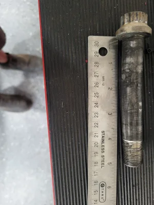

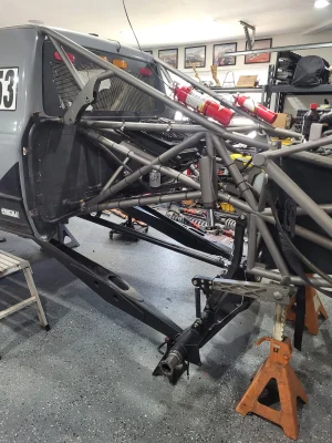

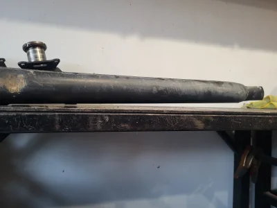

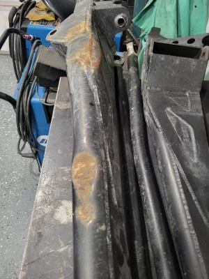

After taking a few months off, we got back into getting the Ranger torn down and assessed the damage. On day 4, we hit a massive rock in the dust, grenade the front wheel, and blew the tire. The rear wheel had a huge dent, but the tire was still good. Bent the front I beam, and the 3/4" radius arm bolt, 9" skid plate is toast, 3rd member is ok had it inspected. The drive shaft looked like a twizler, East county dive shafts is building a new one.
Complete tear down on the rear, all new uniballs and rod ends. New sway bar: A couple of the splines were missing, new fluids and filters for fuel, transmission, and gear oil. Shock rebuild. Last thing, complete rebuild of the hubs, bearings, races, and seals. The rear is almost together and then prep the front. The goal is to have it together in January.
