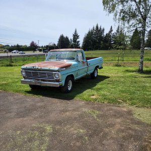

here is my 67 f100 2wd, have been looking but not well for an up to 79 F series frame... or go wild and find like a 2005-2008 F250 or F350 frame with the front coils.

I have a 70 F350 frame I'd sell you. The f350 is same frame as the 4x4 high boys so easy to SAS and do steering box in front of the axle.
My friend in Bend just bought a 6.4L diesel truck to part out. He found quite a few of those on marketplace for cheap. You'd have to shorten the frame to use them on your truck but wouldn't be too much work to get the axles/steering etc for the truck. You can also swap in some 5.4L gas front springs or synergy leveling springs for a good ride too.
