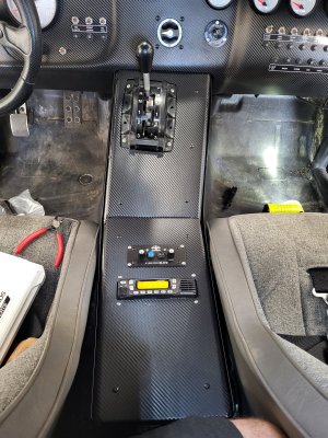

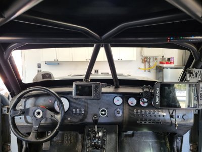

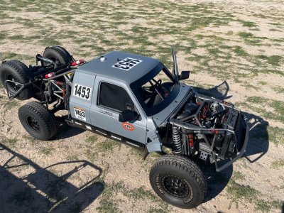

A couple of updates installed Lowrance Elite 9" for the Co-driver and Lowrance Hook for the driver. New PCI intercom and Leadnav setup. The plan is to race the NORRA 500 this October.

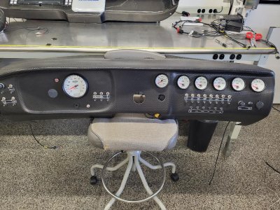

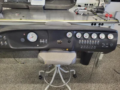

I Really like how simple your dash is! all the right stuff and nothing extra!
Thanks, when we first built the truck, no LCD screens or Switch Pros were available. I dig the analog gauges with the switch/breaker setup. Kinda nostalgic now! It's a Fiberwerx OEM dash we had rewrapped.

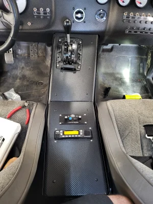

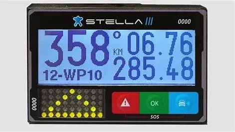

What’s the Stella system with the blue/green/red buttons on the roof tube?
The Stella system is used for tracking per NORRA, it has the capability to request a push to pass and the competitor will see it to pull over. It identifies speed zones, hazards, and vehicles that are broken down or in need of medical help. The sticker is a quick reference to activate any such scenario.

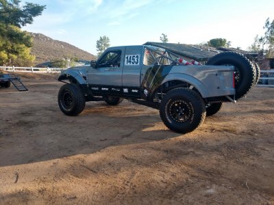

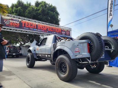

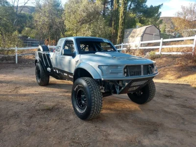

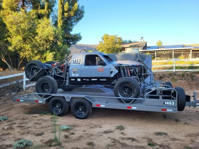

Quick shakedown at Placter City, no issues. Just button up a few small ends and be ready to race the NORRA 500 in 25 days.

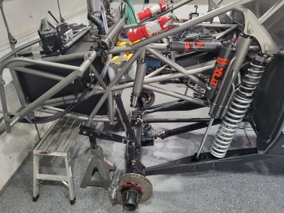

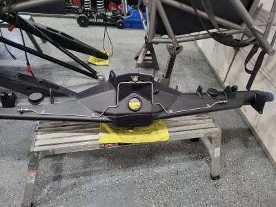

Breaking the prep into 3rds and starting in the rear section, all new uniballs and rod ends for the 4 link, upgrading the rear brakes to 14" rotors and Wilwood 6 piston Aero calipers. New fuel filter, stainless steel brake lines.

were you having issues at NORRA with the rear brakes?
Wally, no, not at all; initially, the truck had 12" rotors to fit 15" wheels. When we upgraded to 37s, we did the front brakes to 14" rotors and six-piston calipers and left the rear how it was. Now, we have time and money to upgrade the back to match the front.

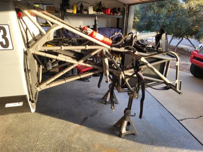

The rear end is almost 100%, all new rod ends and uniballs for the 4 link, upgraded the rear brakes with bigger rotors and calipers, inspected the 3rd member and axles, no issues, new drive shaft from East County. Fresh Maxima gear oil, fuel filter, and transmission filter. Just need to bleed the brakes and put the tires on. Only 86 days until NORRA!

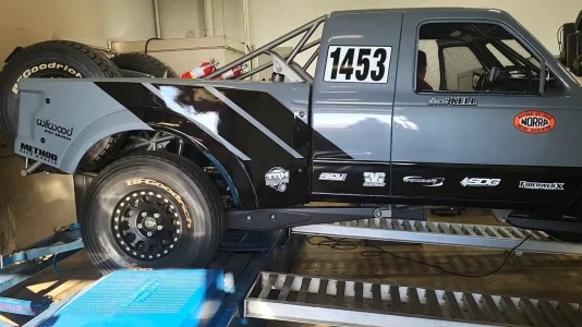

Successful day testing out in Placter City, truck ran and operates flawless. Adjusted the brake bias, no other issues needed to be addressed. 19 days until NORRA 1000
