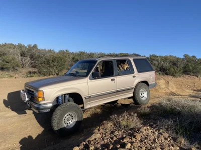

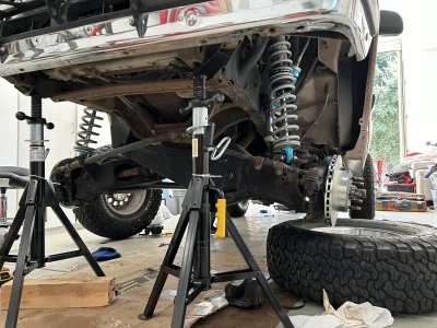

Now onto the suspension: I took the truck to Tanner at Sacc Fabrication and he absolutely crushed it on everything.
Front end is stock width C/T with overlay plates from Threat motorsports, as well as Threats radius arms.
Running king 2.5x12 coilovers and locked offroad 2.0x2" bumps with a custom engine cage built by Tanner.

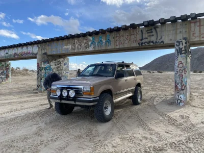

Went with 33/10.5/15 BFG's on American racing outlaw II wheels. Doing my best to keep this thing sleeper--ish and some what era correct.
230774

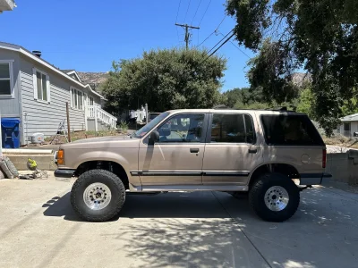

Here is how it sits now. I need to go up on the spring rate upfront to get a little more ride height. The rear should drop slightly once the leafs get broken in, but for now it has a bit of the stink bug stance.

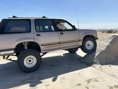

So far I'm super happy with how everything has turned out. It drives pretty well on the road, and planning on taking it out for the first time on Halloween weekend at Ocotillo Wells.
quick recap from the first trip out. 307 miles door step to doorstep. Loaded it up with everything I normally put in my truck for a full weekend and headed out. Was pretty sluggish up all the steep hills and I was definitely nervous about driving it to and from, but made it there and back with no problems. Roughly 100-115 dirt miles.

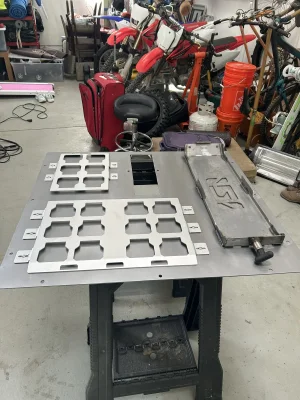

also attempted to make a panel to mount my switch panel to and added some 12v outlets. Clearly misjudged the mounting holes. works good though, version 2.0 will be cleaner haha. Mounts right up to where the factory ashtray/cigarette lighter goes.

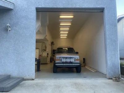

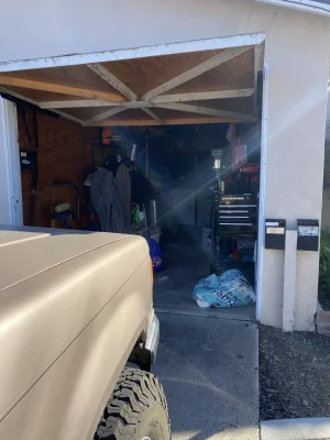

Not much has happened since the last update. In the beginning of 22' I was able to go from working on the explorer in this:
To this:
Being able to actually work on this thing in a garage has been huge and I'm stoked to start doing more things myself.

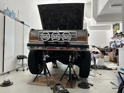

Just finished prepping the front end for this season, and finally put the new springs on upfront that have been sitting in my garage for the past 2 years.
Other than that just been slowly stacking parts. I have a set of D44 beams sitting in the garage that will be going on next summer along with a full size 8.8.

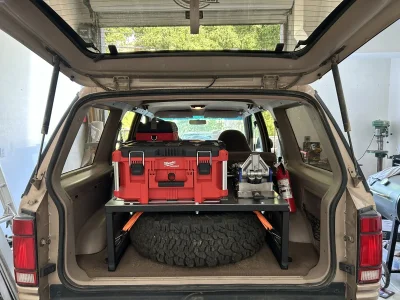

I love clean setups like this! looks great. Do you have any pictures of the clearance between inner rear tires and bypass?
