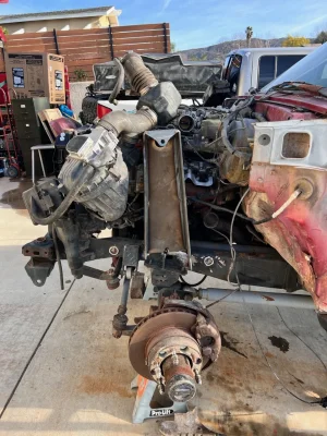

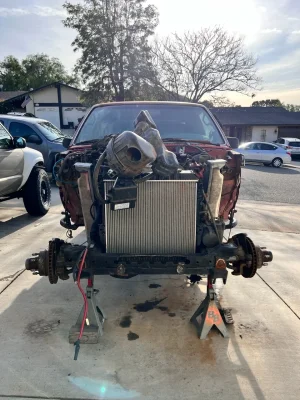

I was able to spend Saturday morning messing with it. Started right up, but runs rough. I think it's vacuum related since everything else is new (plugs, wires, cap, rotor, fuel pump, filter, injectors, heads+gaskets), and timing is right at 10*. It Idles right around 750-800rpm, just not smoothly. Going to pick up new lengths of vacuum hose after work today and remake them all, and then look at the vacuum diagram again to make sure I got them all plugged in correctly. Hopefully I can get it running well before the rain comes later this week.

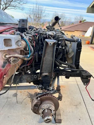

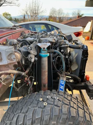

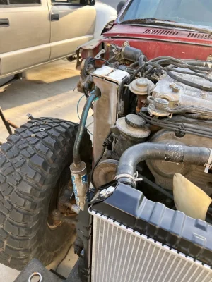

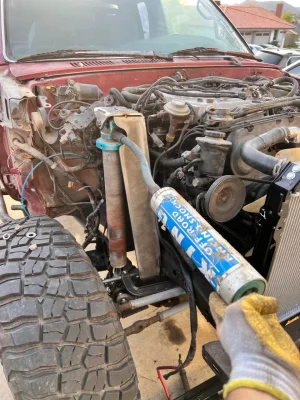

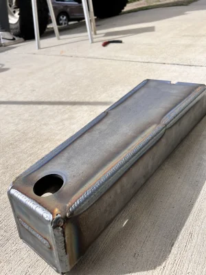

So the new distributor cap I installed when I first got the truck ended up being faulty. Picked up another one yesterday and it's idling nice and smooth! Has a stumble when you get on the gas to rev it up, but I'm stoked with progress. Gonna build shock towers for it this weekend and hopefully mount the core support, new headlights, corner lights, and grill. We'll see how it goes!
Had to angle the shocks forward to clear the master cylinder. Lame, but I’m not in the mood to make a MC cantilever. For a rock donkey I’m sure it’ll be fine. Go fast? Not a chance lol. Ran out of mig wire so I’ll get the rest finished up this week. Also found a nice rip in the bottom of a rubber intake tube, which explains the hanging idle I’ve been having. It’ll get fixed anyways, since I need to figure out how to squeeze the intake by the tower…
