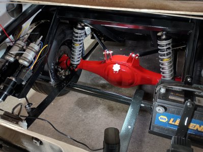

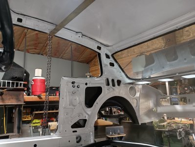

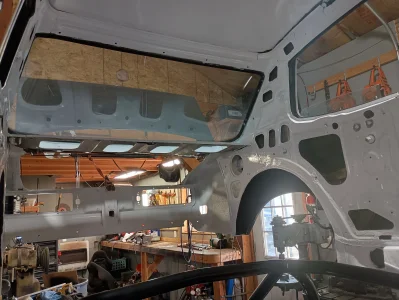

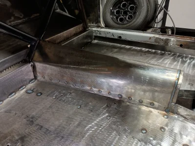

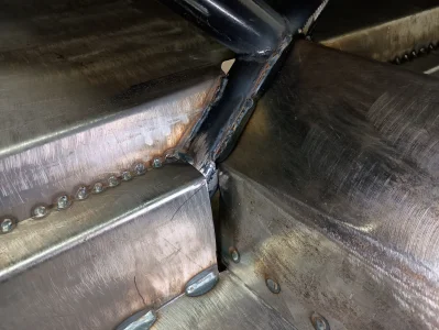

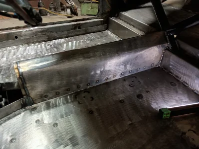

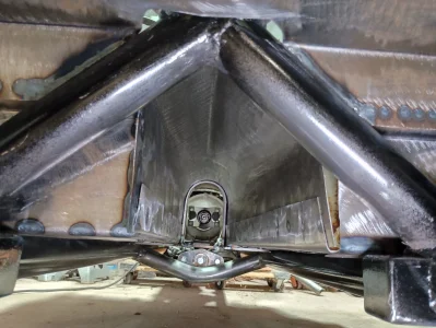

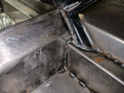

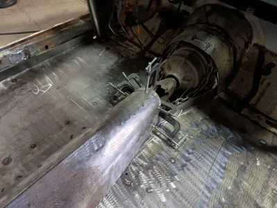

drivers side rear of the tunnel came out real clean. im going to sizzle in a little piece of sheet on the passenger side to seal it up.

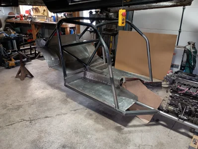

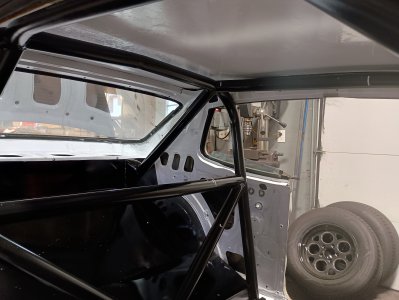

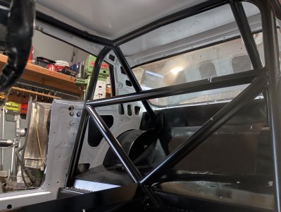

Finally close enough to paint all of the hard to reach spots. I am sure I will be welding more right through some of this in the future

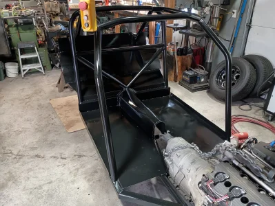

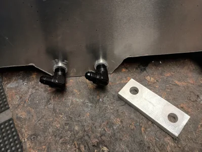

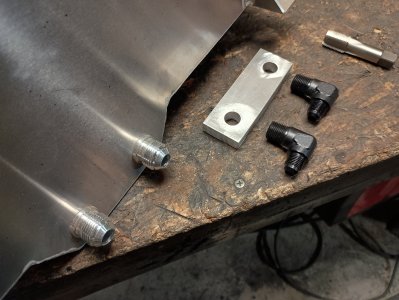

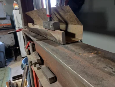

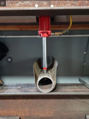

Sliced off the 1/2" AN and there was enough meat to run the razor sharp 3/8 pipe tap in there for my -6 feed lines
i was going to weld on the plate and thread that but the existing parts worked great

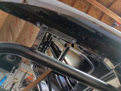

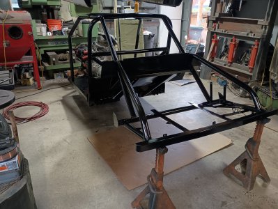

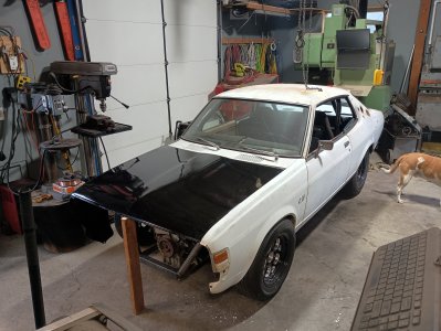

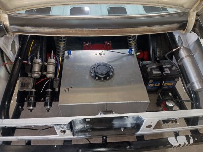

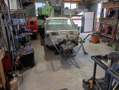

Fuck it, the rear is roughed in good enough to spin this bitch around now.

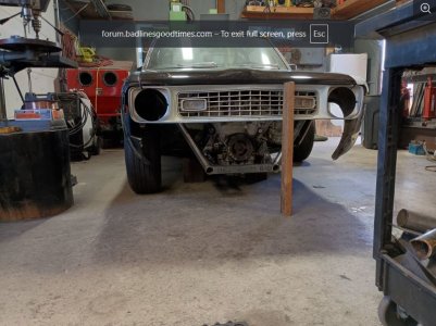

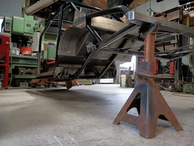

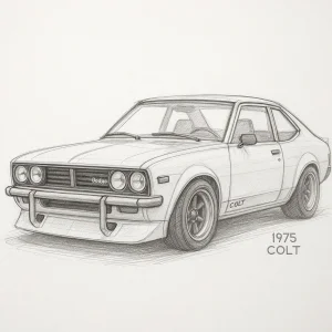

Interesting, what if I built some cute little beams for up front suspension?
I was thinking double wishbone but with some beams I don't need any upper like a strut set up.
Just some double adjustable coil overs and beams
This would have more room for the headers too

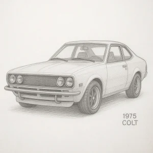

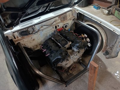

The old plastic grille is about 10 minutes of drive time to exploding into dust! It has cracks and larges chips missing. I am really wanting to go dual headlights because I fuking love to see shit at night!

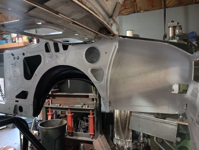

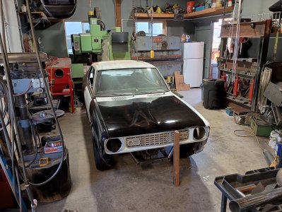

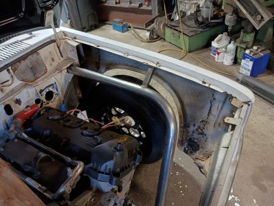

Got some mid fender mounts
I'll put one more front mount when the radiator and intercooler are in place with some kinda sub assembly
