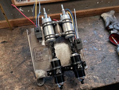

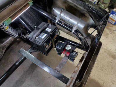

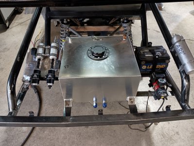

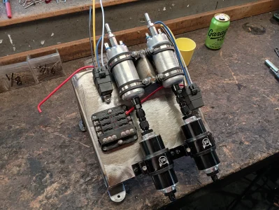

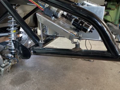

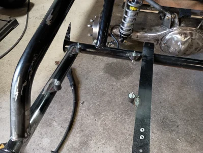

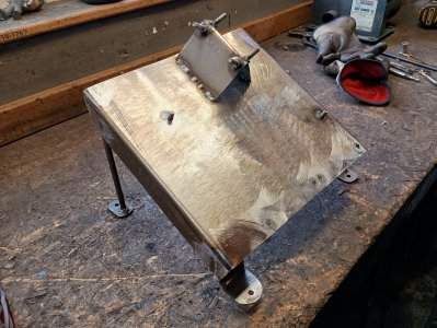

Got my rubber isolators fuel system tray done
in case no body looks at the first page any more

Low dollar rocket system is complete
Time to paint it and wire
Why the dual setup? Need the fuel for the horse torques? Redundant setup? 2 stage for when the boost hits?
Just my car nerd curiosity, I love this build. Simple, unique parts/car and you are moving really fast!
you guessed it
1 cheap pumps 25$
2 good for v8 each
3 redundant
4 secondary kicks on at what ever boost i want
5 have pump switch the rotate through which is primary
6 small pump = quite pump

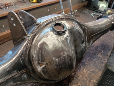

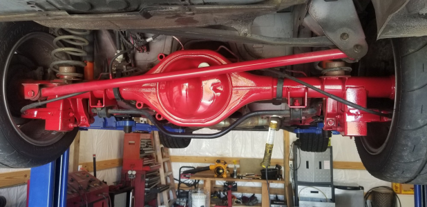

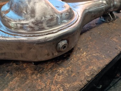

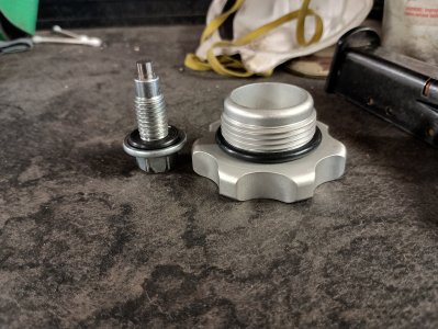

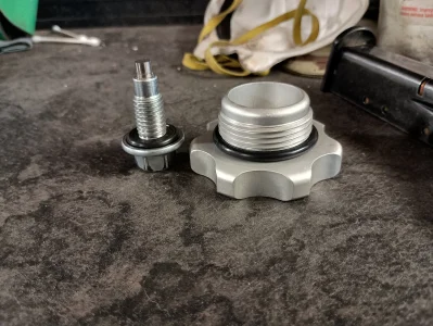

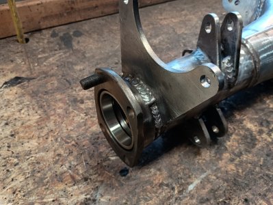

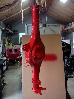

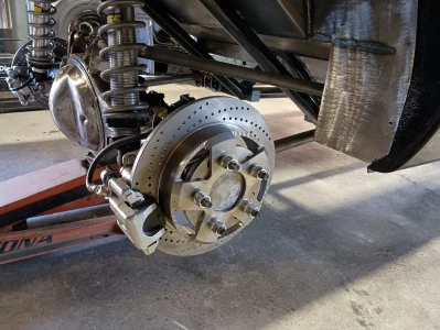

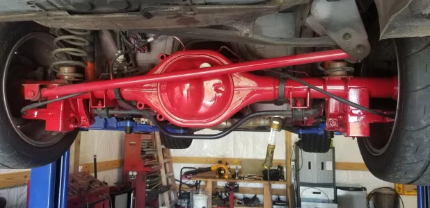

So I did a thing. Finished welding up the last bits on the axle.
Fill bung
Drain bung
Caliper brackets...... Then I was like shit I trapped on an axle bearing retainer bolt! Oh shit I still need one more trapped in there too!!!!!
bonus info. the housing weights in @47.5 pounds
going to paint it red in the morning

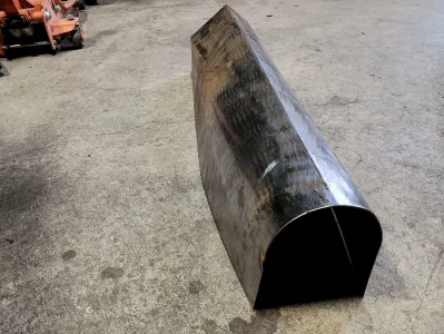

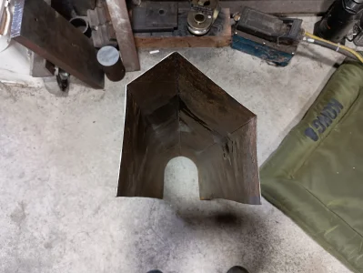

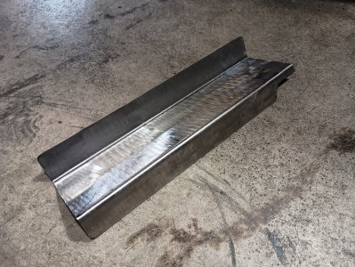

the task at hand
the basic bitch Z bend with tube notch
passenger install
rinse and repeat for drivers side

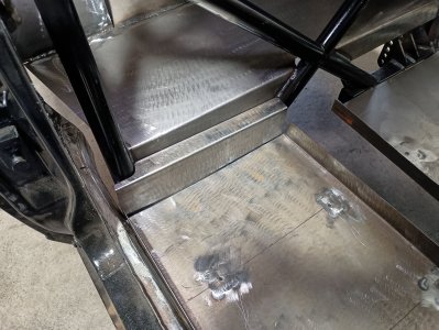

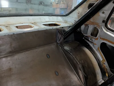

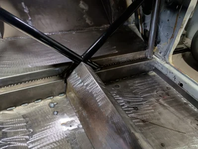

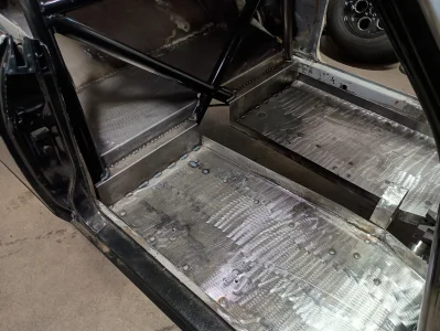

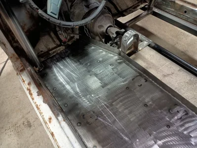

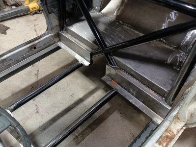

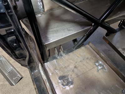

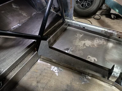

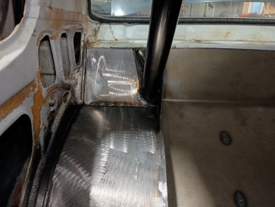

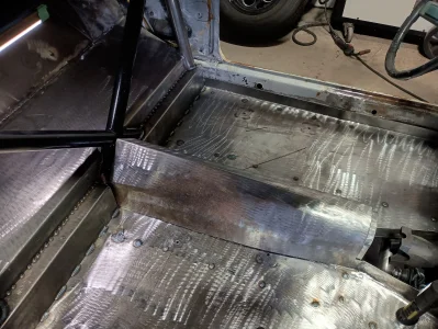

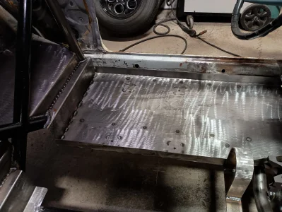

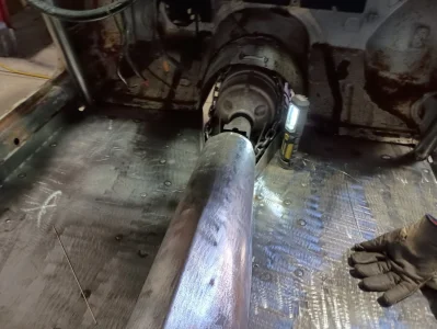

So I waited a week to see if I could come up with ANY reason to not weld the floor pans down.....
Oil canning was about the only one and she welded down flat with none!

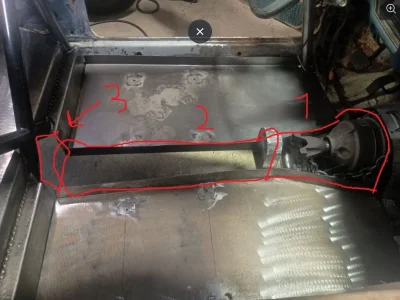

Holy shit!
i didnt think this was going to work for shit
