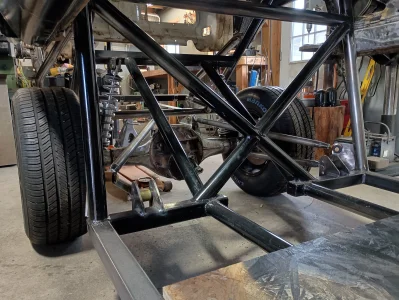

Pretty fuking happy with my hack job

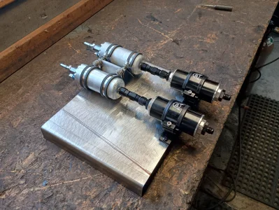

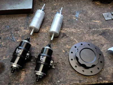

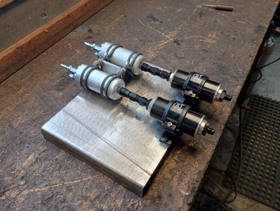

Got a pair of old mid 80's Ford pumps off Amazon with some awesome cheap china filters and sick billet better not leak and should be better than shit plastic quick fill cap!

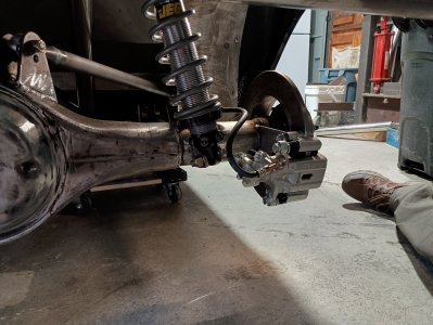

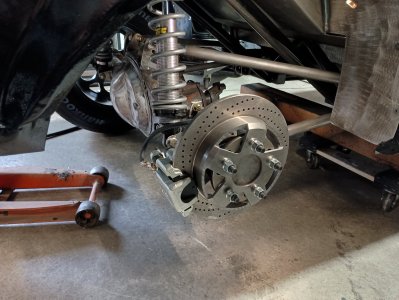

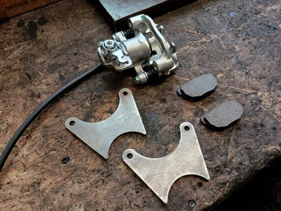

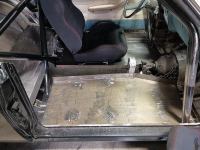

also used sendslutsend for the the first time for the Nissan mid 90 240sx caliper brackets for the rear

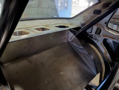

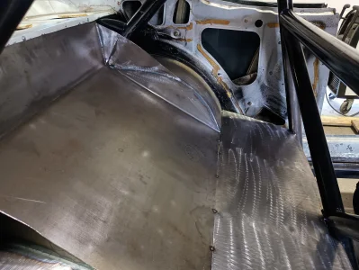

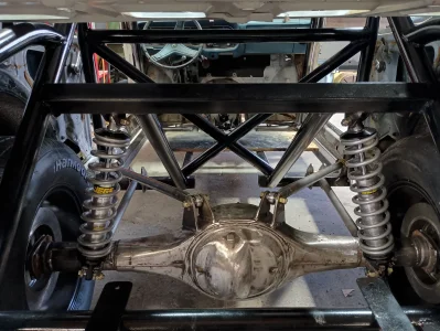

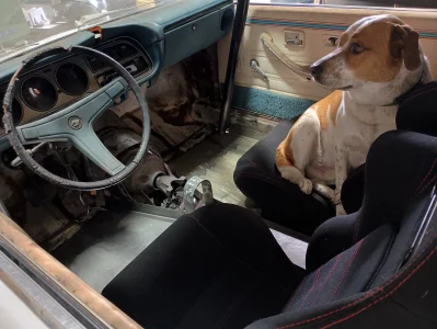

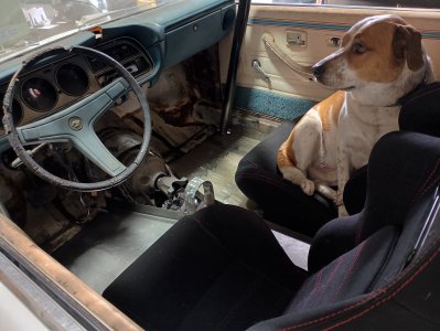

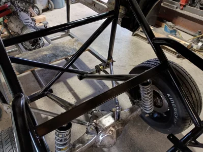

GOOD morning

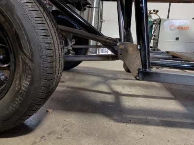

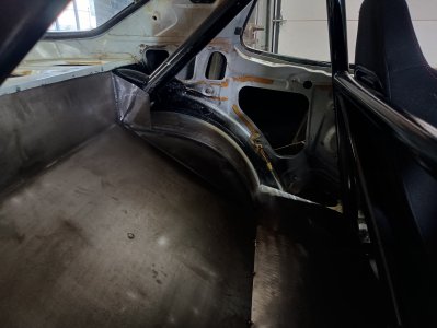

almost as much room as the factory had in the back!

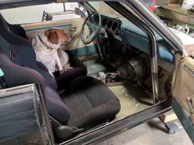

fat shit wont come out. he thinks i will drive off with out him. lol

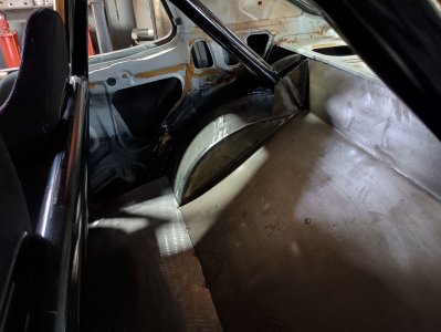

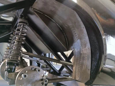

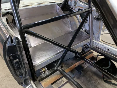

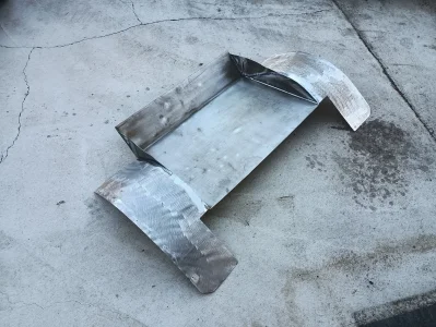

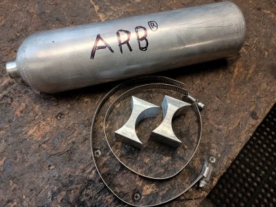

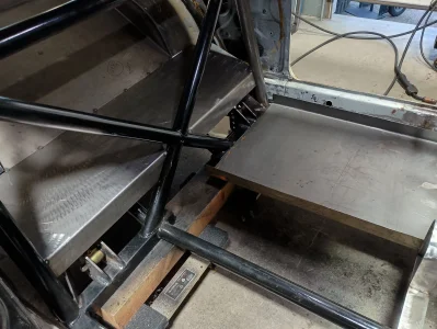

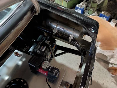

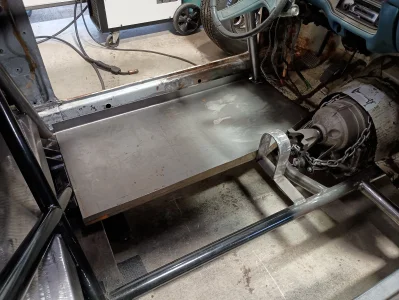

Relays and rubber isolators will be here tomorrow for the fuel system in the back

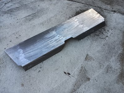

i got 33" x 5' left of my 5x10' sheet to finish off the trans tunnel and fill in the small lady bits in the back

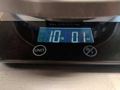

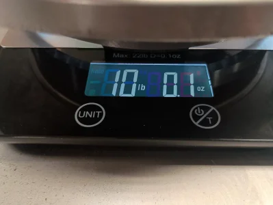

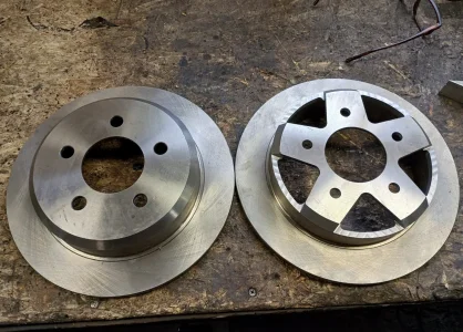

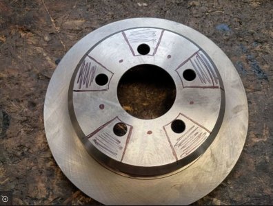

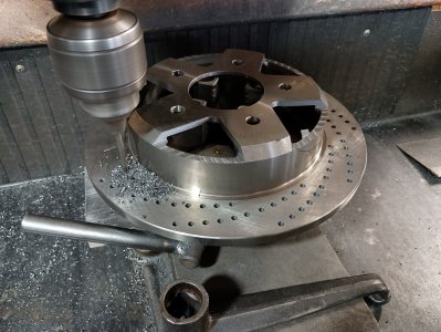

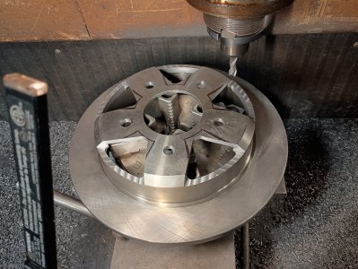

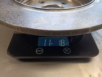

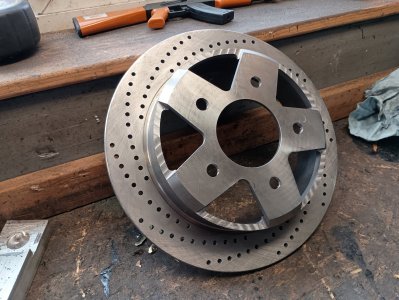

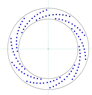

I need to re drill the jeep rotors so the wheel studs center up better than the .625" holes from China.
Thinking while I'm there, to make these a little more high speed with some extra weight removal! Think they will shatter at speed if I use the brakes????

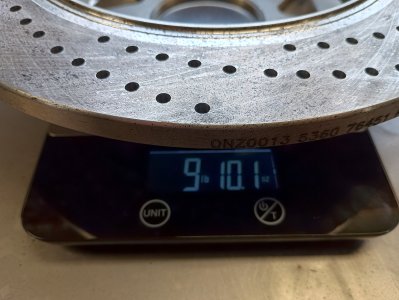

factory weight_________________________ 11 pound 1.8 ounce
stage one ______________________________10 pound 0.1 ounce
final kill mode jegs/summit want-a-bee 9 pound 10.1 ounce
pretty much worth all the time to weaken the shit out of it!

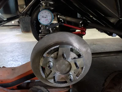

TIR on the rotors are about .025"
i think most of that is in the pressed in studs
the axle flange was about .003"
