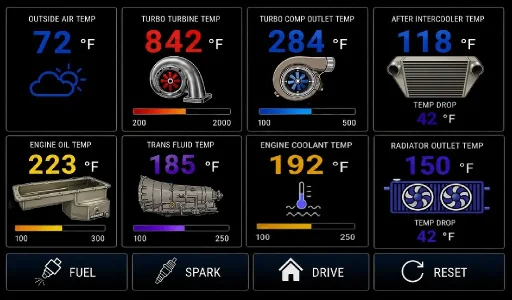

I found these combo temp/pressure sensors the other day and am trying them out for coolant temp/pressure and oil temp/pressure. Not sure when I will get them fully done but they are pretty slick and the curve is way better than the lowdoller-motorsports ones I tried before.

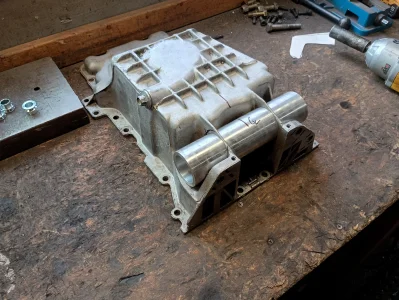

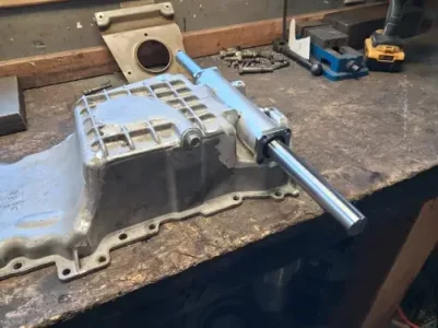

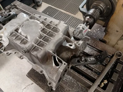

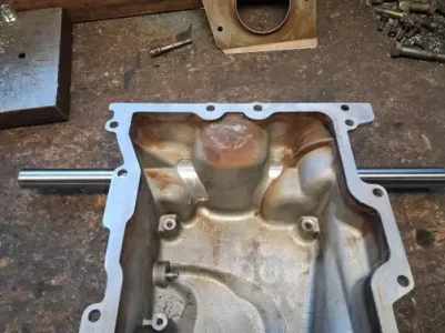

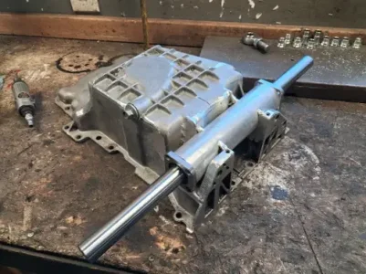

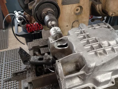

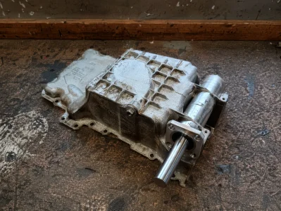

ok, so the front steer did not function due to extreme reverse Ackerman.
rear steer will work great for the tie rod placement on the knuckles this time.
i just need the center link to go right through the motor, or in this case just the pan.

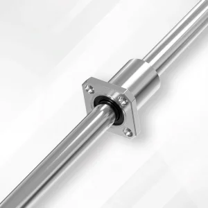

i got some linear ball bearing ends coming and a 25mm hardened shaft. i plan on welding a machined flange to the tube on both sides and then the tube to the pan. the ends will bolt on and the shaft will have threaded ends for heim joints.

Bad ass! I’m always blown away at people in general with their ingenuity on oddball projects. Car is going to be one of a kind that’s for sure!

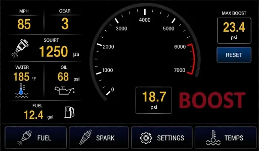

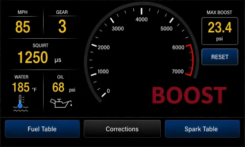

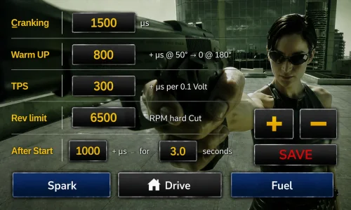

i was not looking to add another key to my ring so it dawned on me that i could have a passcode/pin screen on start up.
so just a toggle switch to power the ecu, then if pin is true the code goes live. then a basic push button start.
i can also have different pin numbers for levels of performance unlocking. rev limit, shift limit ect
this deletes some hardware in space, cost and weight.
