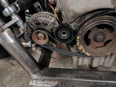

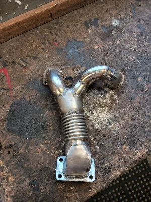

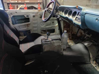

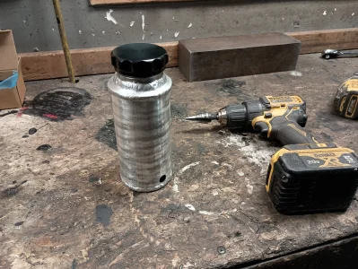

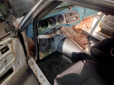

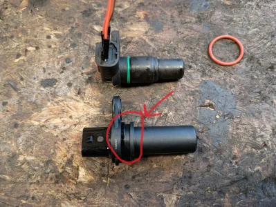

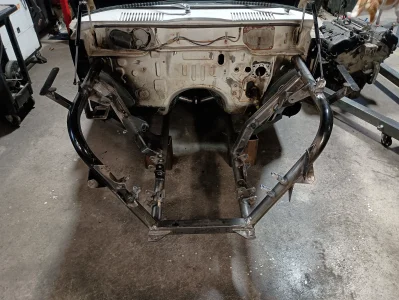

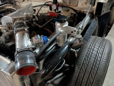

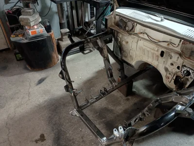

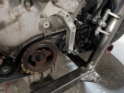

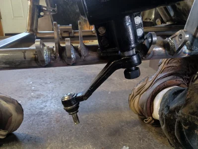

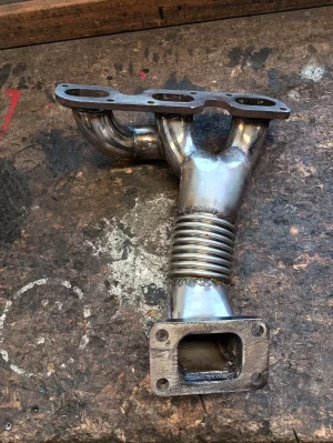

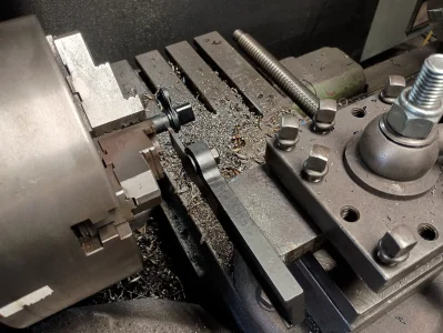

Dimples the power steering resi with some stuff laying about

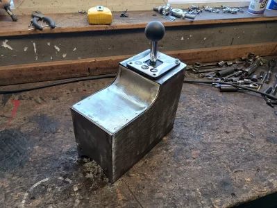

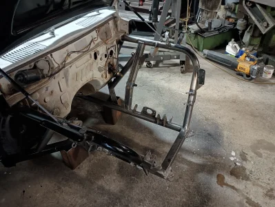

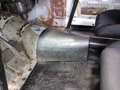

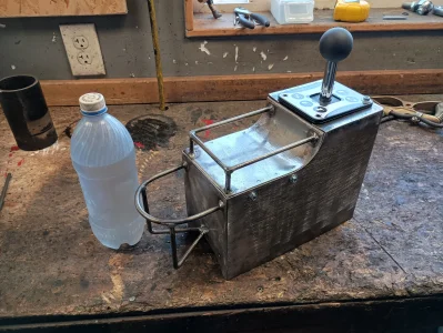

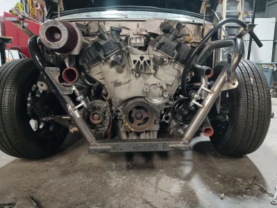

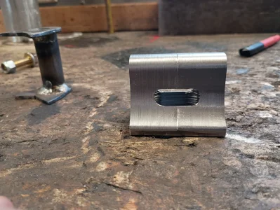

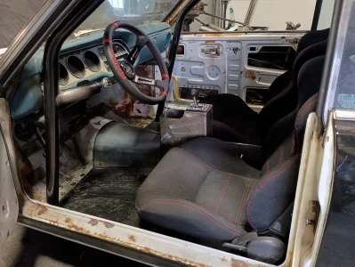

Bent up the last piece of sheet
wraps tight on the drive shaft loop on the rear
a couple 1/4" screws hold the bottom of both sides down on the floor flange
the front will get stitched up and the whole thing glued once it is time

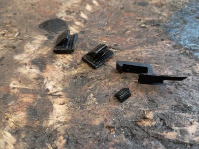

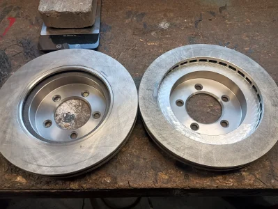

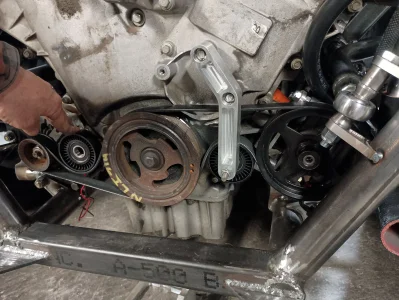

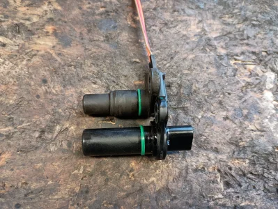

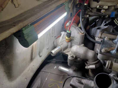

When I swapped oil pans a while back these bits where in the bottom of the couriers old motor. Might need new belt tensioners

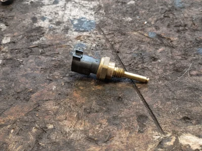

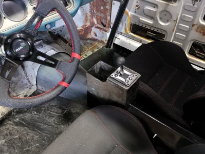

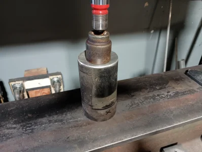

looks like these motors dont come with a typical coolant temp sensor but a fancy cylinder head temp probe. huh..
anyways back to the usefull sensors
