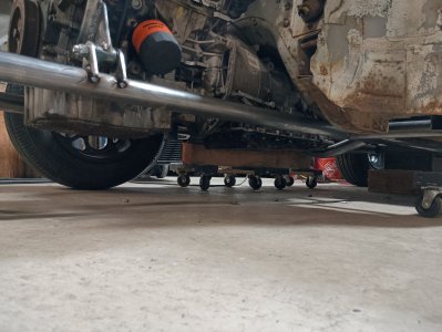

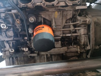

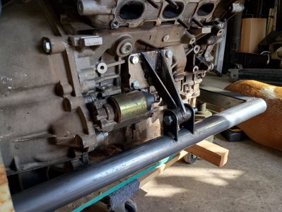

I might have to get weird on the driver's side motor mount. There ain't shit for easy mounting. Only two 10mm on each side of the filter

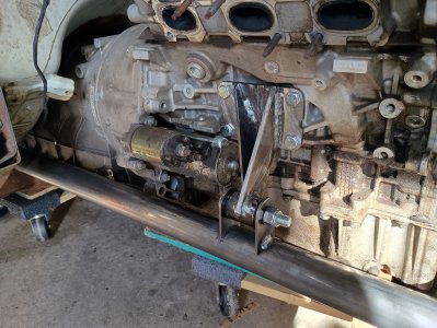

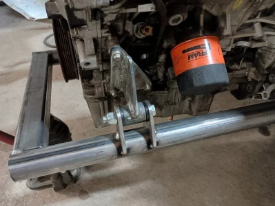

Drivers side motor mount done.
Soft side has 4x 10mm bolts into the block and the wheelie side has 3x 8mm bolts into the block
Perfect :cautious:

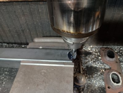

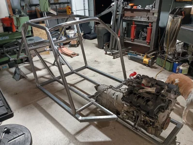

with the semi rigid mounts, i am going to mount the alternator and possible the power steering pump to the frame and run the belt all over the fucking place
