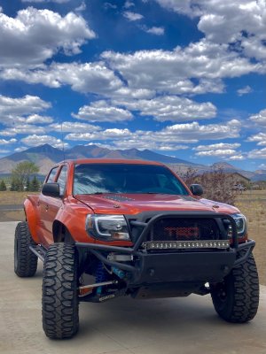

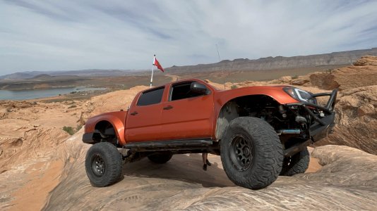

I guess I should post some specs on the truck while we are at it.
Started out as a 2011 Tacoma
Engine: Stock 4.0L v6 with the trd supercharger, one size smaller pulley, custom intake, and custom engine and trans tune using HP Tuners. Also have DMZ solid motor and trans mounts.
Front Suspension: Dirt King +3.5” long travel kit, king 2.5x8” coil overs, RCV axles, with everything gusseted. Pulls 15” of travel
Rear Suspension: Started as a DMZ 62” spring under kit with their bolt in bed cage and 2.5x16” king triple bypasses. Was dragging and bending the shackle hangers in the rocks and eventually flipped the shackle and did a custom 14.5” shackle setup. New setup pulls 19.5” of travel
Other: Tundra rear axle with 10.5” ring gear, front and rear Harrop E Lockers, engine and cab cage and custom armor front to back.
Wheels/Tires: SCS ray 10’s wrapped in some 37x12.5x17 Milestar Patagonia’s.
I’m sure I’m missing a lot of little things in this list, but that should cover most of what people ask me about the truck.

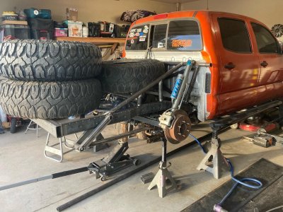

Been on a bit of a hiatus here lately. Had some good fun progress on the truck, got to drive it for about 50 miles and then chopped it in half for a back half.

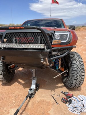

Just before Memorial Day weekend I made time to get some ADS 2.5x8” triple bypasses mounted up front and revalve the coil overs to accommodate the addition of the bypasses.
Was super stoked on finally getting front bypasses. Did a quick test drive on some local little trails the weekend before Memorial Day and what a difference it made. Straight out of the box with no tuning it was soaking up small chatter 100 times better than before. And where before I ran the coil over compression adjusters almost fully closed all the time, now I was hitting medium-ish terrain with them fully open. So there is definitely a ton of room for dialing things in to handle small stuff way better than before and push the truck through bigger stuff faster and smoother than before. So stoked on the first drive of the truck.
Then Memorial Day weekend was upon us and the wife and I loaded up the truck for a usual camping spot of ours with her family. Nothing too crazy out there but I was still so excited about continuing to test and start tuning the bypasses.
We made it about 5 miles away from camp on the day that we arrived and disaster struck. After a bad afternoon of trying to set up our big tent and it having issues (luckily we always bring our smaller old tent with us), the weekend got a lot worse (at least for taco sauce).

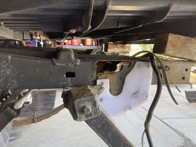

A loud bang and the truck taking a heavy lean and I knew something was wrong.
The shackle hangar had ripped off the frame, taking the frame overlay and frame with it, shoving the shackle up into the bed which was now supporting the weight of the truck.

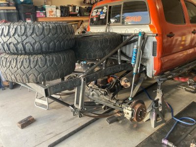

The camp spot was local-ish to our house so we hitched a ride home to grab the tow rig and trailer after limping the truck back to camp. After getting home and inspecting things it appeared that the cracking had been there for a while and the passenger side was starting to crack as well. I figured it was due to the extra long shackles and notoriously weak toyota frames which I had mediocrely reinforced years ago and since learned a lot about fabrication. Further investigation after deciding to take the extra few hours to pull the bed off to better complete the repairs led to bigger issues being found. The entire rear portion of the frame had been bent at some point likely over the year or so and was kicked to the passenger side a decent amount.
So, decisions were made and I chopped the frame off at the back of the cab.
Been slowly making progress rebuilding the back half of the frame over the last 5-6weeks. Biggest issue has been lack of motivation to work on it when I get home from work and in the afternoon/evening on weekends due to heat/humidity. But here’s how she sits as of yesterday.
New frame rails are 2x4”x1/4” wall square tubing with 3/16” overlays. I also switched up the frame layout to go with a more traditional style shackle that goes through the frame and straddles it. Frame height is a little taller so I should be able to bump the axle a bit higher as well as raising the pivot point height just a smidge to try and get the truck to sit a touch more level when all said and done. Also tied the rear firewall section there through the cab and into the cab cage which it was not before and I feel is a huge contributor to bending the frame right in that section in the first place.
Next 2 big things are getting the fuel tank mounted and cycling suspension to figure out upper shock mounts. After that and a ton of welding, realistically the truck can be driven and tested out while I sort out the final little details like storage, mounting the bedsides, air compressors and all the little detail work that honestly will probably barely get done by winter and snow season lol.
Haters will say I should have just linked it if I was going through all the work to back half it. But so far none of the haters have been willing to donate new coil overs and bypasses and links. Truth is the truck works so damn good and is so balanced with this leaf geometry paired with the front that linking the rear probably wouldn’t do a ton of benefit because there isn’t much more to do to the front to help it keep up. And all said and done I think I’ll finish it up at about $1500 in materials with todays shitty material prices. Linking would be similar cost in materials plus shocks plus shock lead times.
Goal when I chopped the frame was to have the truck driving again by my bday in a few weeks. I probably have a solid 40-60hrs of work left before that happens so we’ll see. Like I said previously, biggest issue currently has been motivation and the weather keeping my motivation down. But if not then, Labor Day is the backup goal and the truck should be ripping through some whoops and jumps soon enough.
