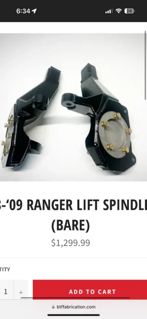

Hey guys, 16 years old and building my own long travel currently. I have done uppers and lowers, im working on a spindle right now. I have a 2005 4wd ranger. Would a 95’ 4wd ranger spindle fit on a 2005? BTF makes some spindles for a 98-09, but in the description says “Required parts to complete these are from a ‘95 ranger 4x4 as follows: spindle, spindle nuts, inner and outer wheel bearings, rotors, inner wheel seal, and a dust cover.” So please help, i dont know what to do
With a steering knuckle, commonly referred to as a “spindle”. Looks like those BTF ones use a 4wd spindle snout for the hub and bearings, not the steering knuckle.
