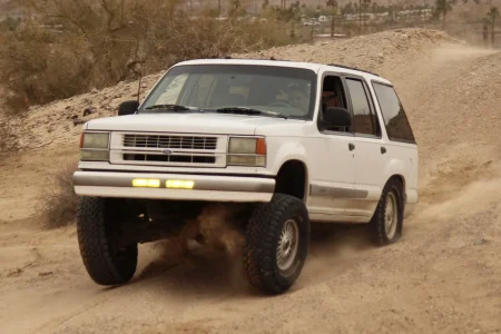

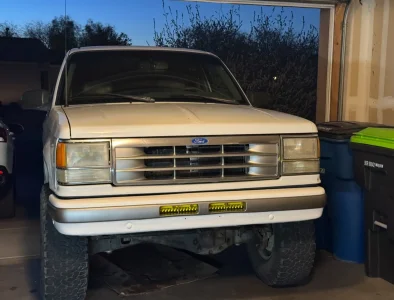

My explorer is a Limited trim but came with an XLT bumper and grill because it was in a front end collision at one point. But I’ve always thought it’d be cool to get it back to Limited spec. Haven’t had much luck finding a bumper, but @gascapkevin had a great idea of just powder coating my XLT bumper to replicate the Limited bumper (white with grey insert). Got it powder coated, sprayed the bumper insert with some alloy armor, and slapped it back on! Turned out great, and looks better than the stock Limited bumper IMO 👌🏼 Still on the lookout for a Limited grill, but they are hard to come by.

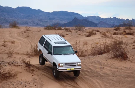

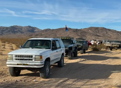

KOH bound! This is the first time I’ve taken the expo to JV and am excited to see how it does in more traditional desert terrain
Last year I brought my XJ and it did better than expected but the rear end couldn’t keep up through most of the whoops. The expo should do a lot better

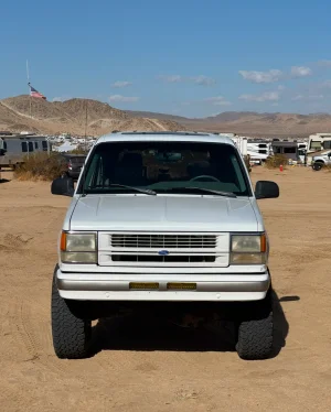

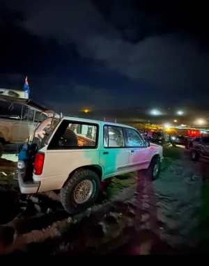

Been searching for a limited grill for a while without any luck… was driving through Landers and spotted a beat up limited 1st gen sitting in some guys yard. The stars aligned and he sold it to me for $40! Got to camp and put it on before unloading a single thing lol. so stokedIMG_4077.webp

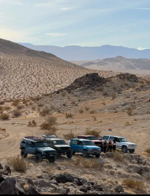

Friday we took off to Giant rock. The whoops around hammertown are no joke but we were able to find an immaculate wash and ride it most of the way.

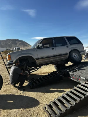

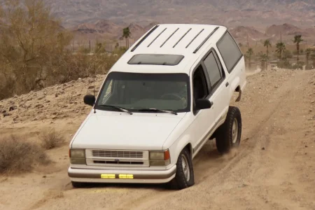

Less than a mile away from camp and my front spring ejected itself. didn’t feel like getting the jack out so 14 of us just pushed the side of my truck and I slid the spring right back in lol. Time for limit straps I guess. Still ripped it all night and made it out to the Sand dune

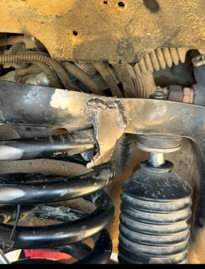

Saturday we booger welded some scrap metal to the coil bucket to hold the spring in.

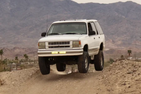

Did some spectating and then shot out to the sand hill. I tried the main jump, but couldn’t even get off the ground haha. The damn 4.0 and stock gearing is gutless. Made my own jump on a different dune and got some airtime

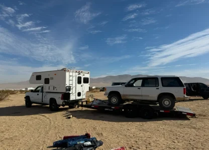

Overall was a perfect trip. Being that I live so far away from JV, I made every minute count. We were out driving until around 3 AM every night. I brought my smudge pot but didn’t even light it once because we were never just sitting around at camp. 130 dirt miles total 🤘🏼

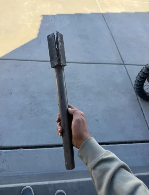

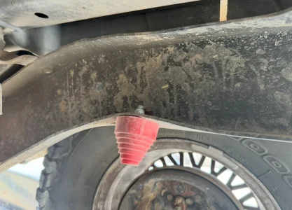

Koh repairs were made a couple weeks ago. The frame where the right rear bump stop mounts to was bending inwards. Had to make my own tool to bend it back. Big PIA but got it done and then welded in some tubing on both sides to prevent it from happening again
Also redid the front spring hold-downs so the coil can no longer pop out. forgot to take any photos of that fix but pretty much widened and reinforced the cup washer that bolts the coils to the beams

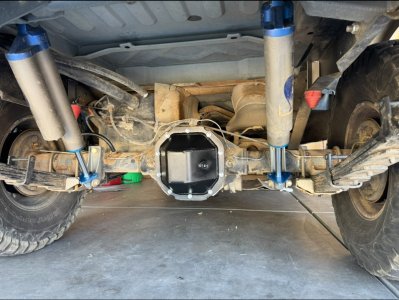

Rebuilt the lsd with carbon clutches and threw on a ruff stuff diff cover 💅🏽

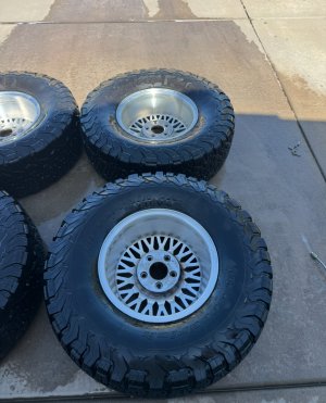

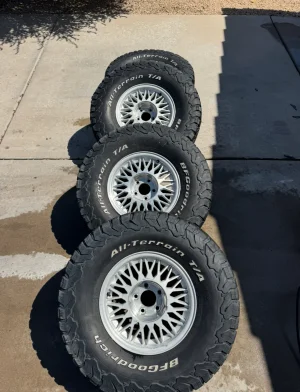

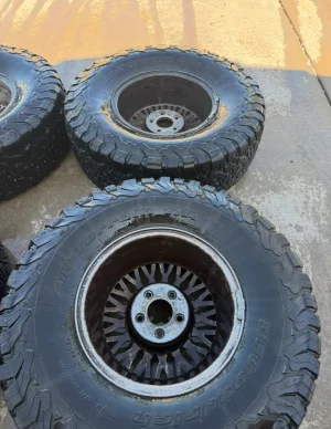

Cleaned up my wheels. Had 30 years of brake dust and grime baked onto them. Took multiple coats of Magbrite and scotchbrite but they are squeaky clean now
These snowflake wheels are so rad for being a stock wheel

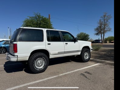

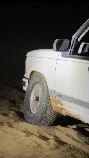

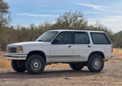

Also got some new 33x10.5 KO2’s to replace the 32’s. Cookie cutter 33’s on a stock width expo fit so damn well and shouldn’t rub too bad, if at all

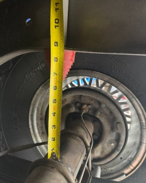

Do you know the axle to bottom of frame measurement on your expo? I think mine sits really tall. Trying to compare

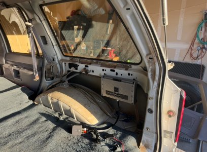

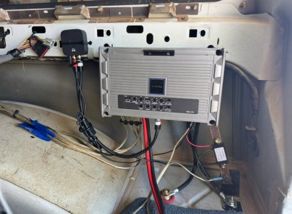

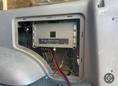

New alpine amp, Jl 10W3 sub, and JL 6x9 front speakers. Gutted everything stereo related including the head unit, stock amps and sub. Ran new speaker wire to each door. Decided to mount the new amp where the old subwoofer was behind the plastic panel since there is so much extra space now.
Added a battery bulkhead to power the amp but also make it easy to relocate the battery when I’m ready. That small black box on the left is the bluetooth receiver. No head unit with this setup
Not sure about other models but the Limited has this cutout for the oem sub so I still have easy access to everything inside. Plus it has a mesh cover to keep air flowing around the amp

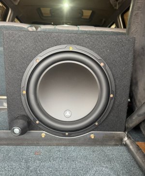

JL 10w3v3-2 sub goes crazy

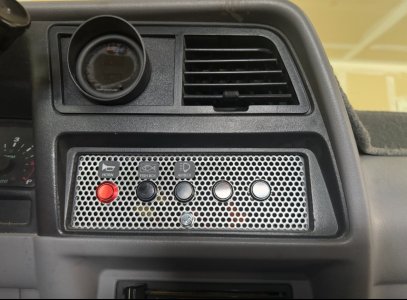

No head unit now so I made a little switch panel to put in its place. The left one is a momentary switch for the horn and the rest are latching switches. The “fish box” is actually for the stereo lol
