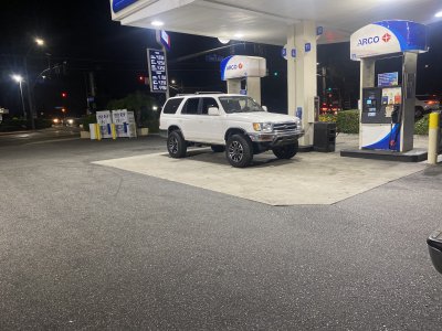

Old SUV’s had like nothing for crash protection. Someone turned in front of my wife’s 4runner and I built a frame behind another stock bumper with a removeable / bolt on push bar out in front. There’s a tube structure behind it that an eBay sheet metal bumper can bolt to directly after drilling a couple holes in it rather than fiddle with the OEM mounts if it happens again. Prefer the stock look for a mellow ride over a trail purposed rig.

That looks great. May have to do something like that!

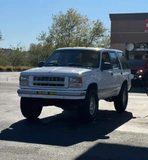

A good 30+ cars did Elvis after dinner. Took 6 hours to make it through but the explorer was a champ. Of course I bent my front bumper too but its not bad enough to care. The only little ford in a sea of toyotas and jeeps 💃🏽

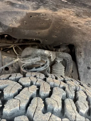

Quick truck check before driving away today and saw my spring just chillin like this. Wonder how long it was like that 🤣

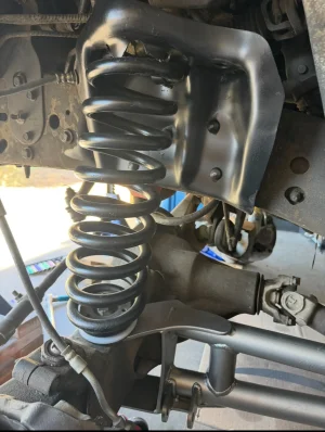

Some front end TLC after noticing my radius arms / diff guard were getting rusty from all the gouges
Grind down and fresh coat of AA
Coil springs fucking suck but I refuse to let them die on this thing. The isolator kept shredding itself because it didn’t sit well on top of the radius arm mount, which led to spring movement and rubbing. But i came up with a solution to keep the spring in place and the isolator for exploding. IMS has these fence-post beveled plates that are literally perfect fitment into the spring isolators. I’m using Desolate brand isolators but i’m sure they're all the same
Slapped everything back together and everything is super tight and shouldn't move at all.
