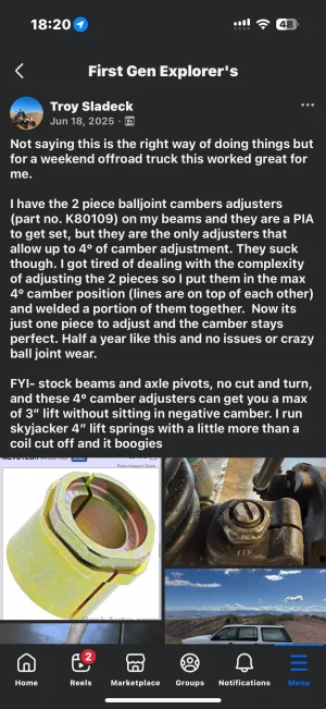

What cams do you have in this thing for the camber? The ones I put in mine still aren’t enough to correct it without c&t beams, yours seems way better
What cams do you have in this thing for the camber? The ones I put in mine still aren’t enough to correct it without c&t beams, yours seems way better View attachment 47945
Damn these are the same ones I got, maybe mine sits higher than yours and that’s my issue. I can’t drop the ride height in the front anymore cause of the coilovers
