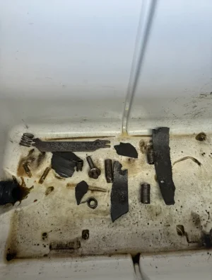

Within 10 mins of offroading I’m hearing something super loose underneath or rear end of my truck. Sounded like a bags of bolts. I had just done a ton of custom work to my transfer case so I thought maybe all the linkage just rattled a ton. We get to the trailhead for the gnarly trail and immediately a terrible ear piercing screech starts. It felt like the whole drivetrain was binding. I pulled over and looked for anything obvious and didnt see anything. I had a guy walk beside me when I drove and we pinpointed it to the rear right wheel. Took off the wheel and the drum and the whole shoe assembly just about fell on the ground. Threw all the parts in the cooler and confirmed my other brakes still worked and kept going!

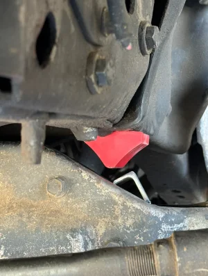

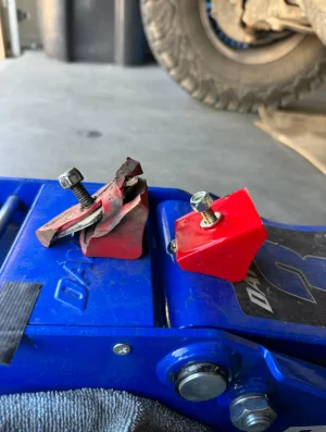

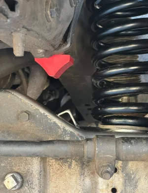

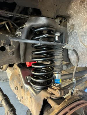

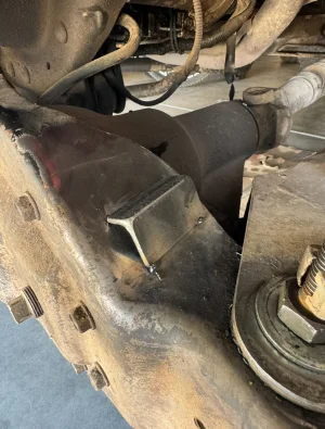

Quick morning project checked off. Front left bump stop kept blowing out becauce the beam surface is so off camber where the bump makes contact.
Added a little piece of angle iron to give the bump a place to fall in to.
Hopefully this prevents the bump stop from getting a ton of side load on compression. Time to test it out this weekend
