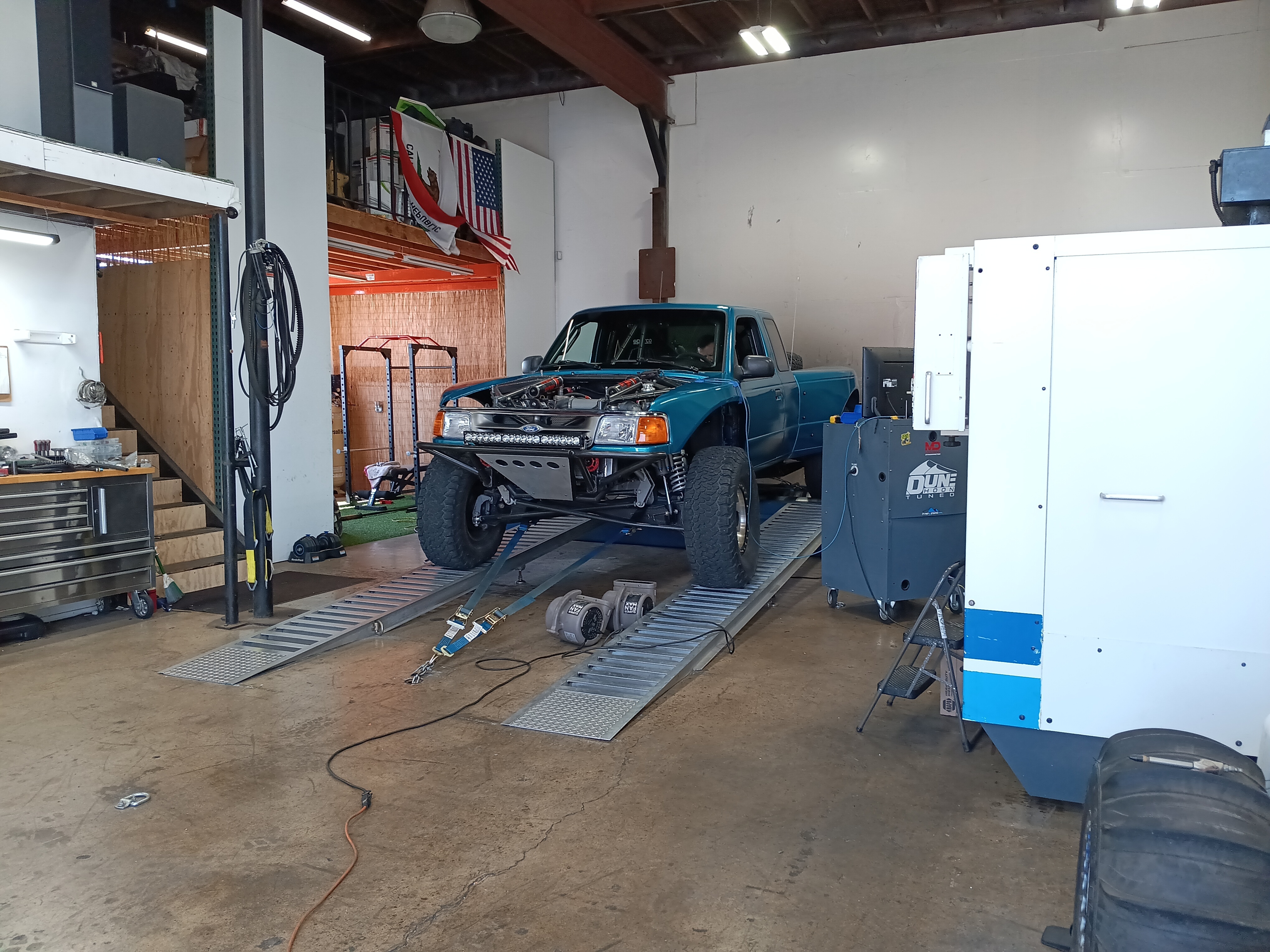

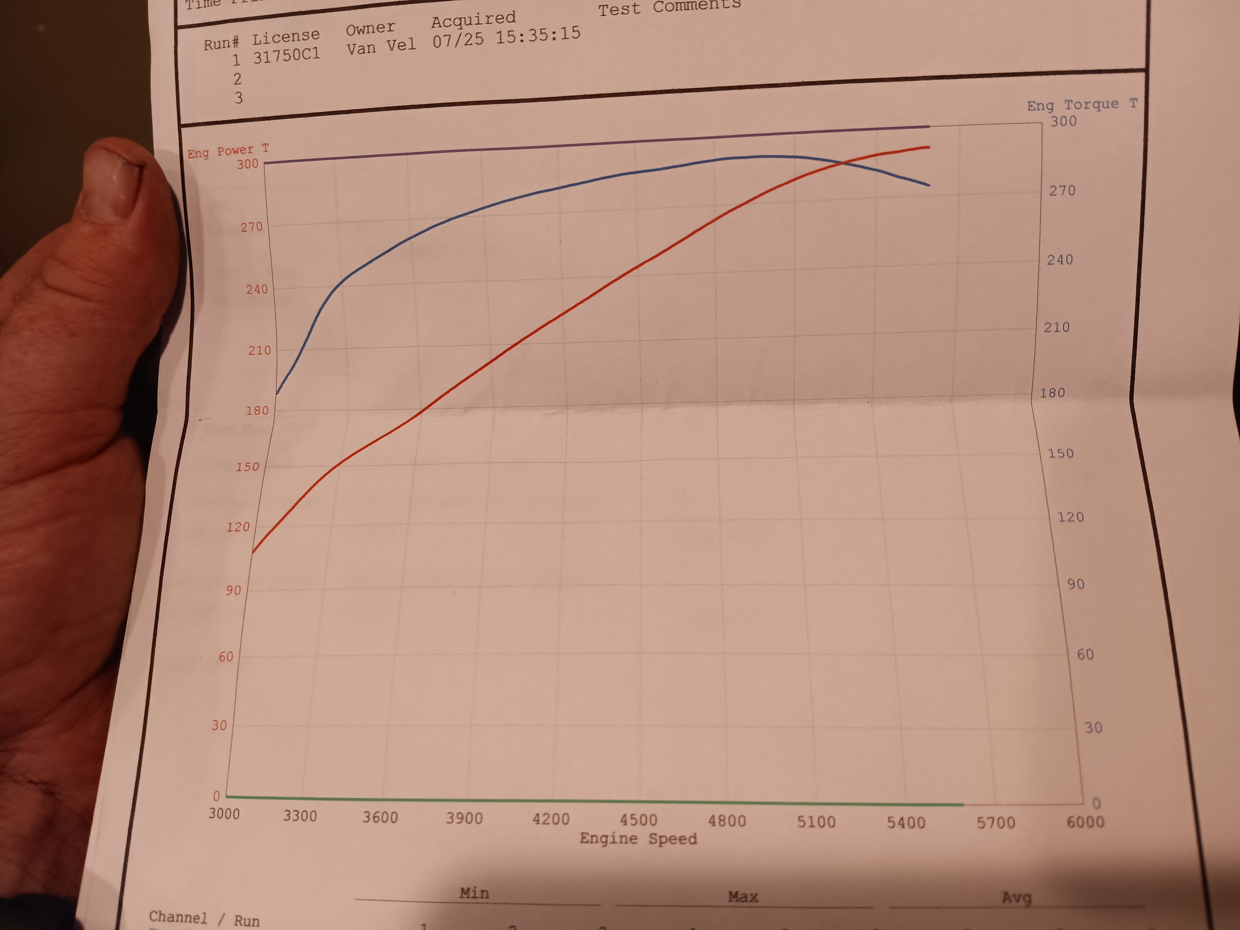

Was cool to watch and learn from Lance aka dunehoon. It's also a bit un-nerving being by a 37" tire spinning at almost 100mph. hahah.

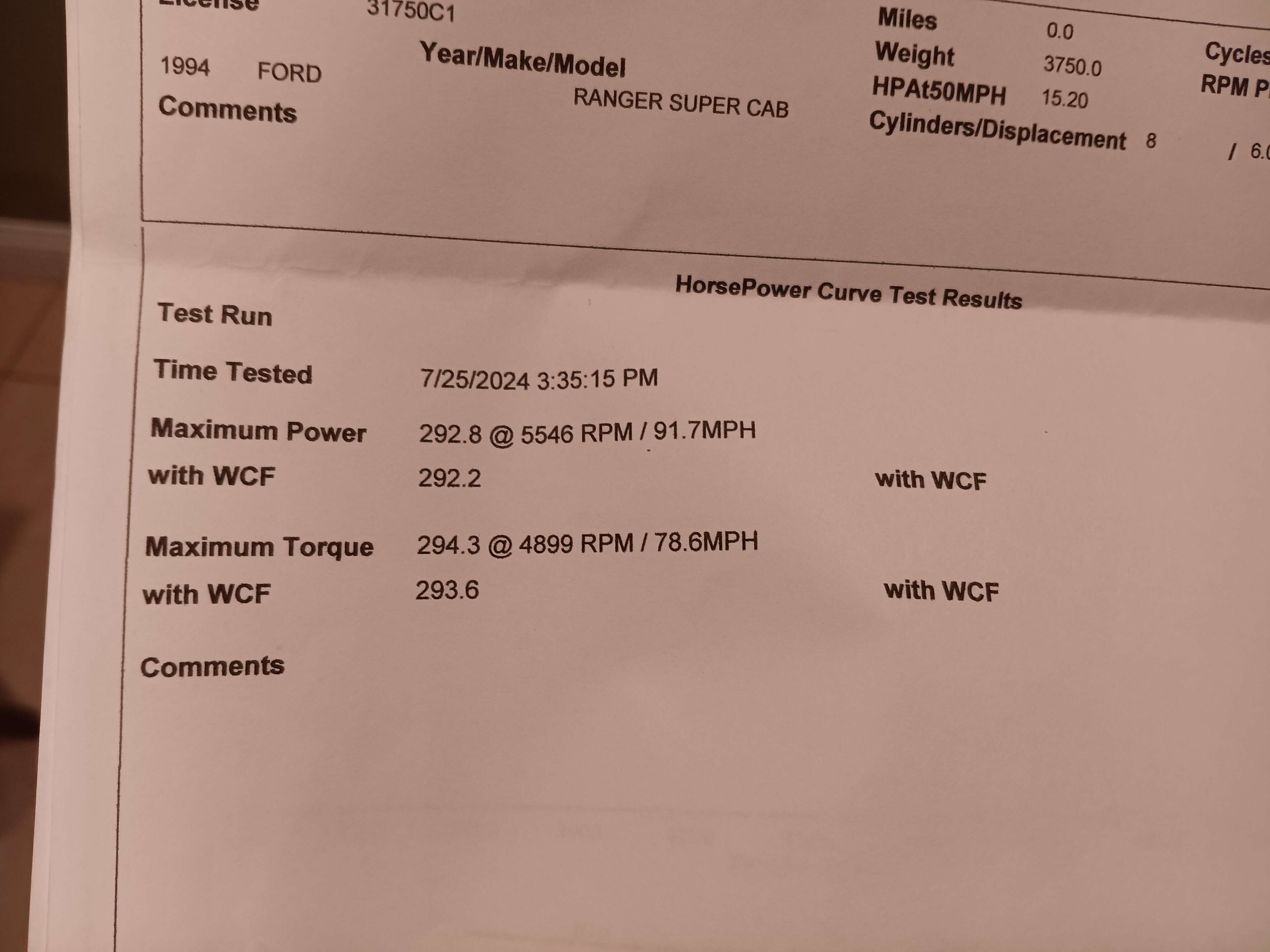

put down 292/294. I suppose that isnt bad considering all the loss.
Should feel pretty peppy in the truck!
Did you ever have a crank hp number? Would be interesting to see how much drivetrain loss there is. I'm also interested to see what mine would be going from a 416/4l80 to a 10" and 40s lol

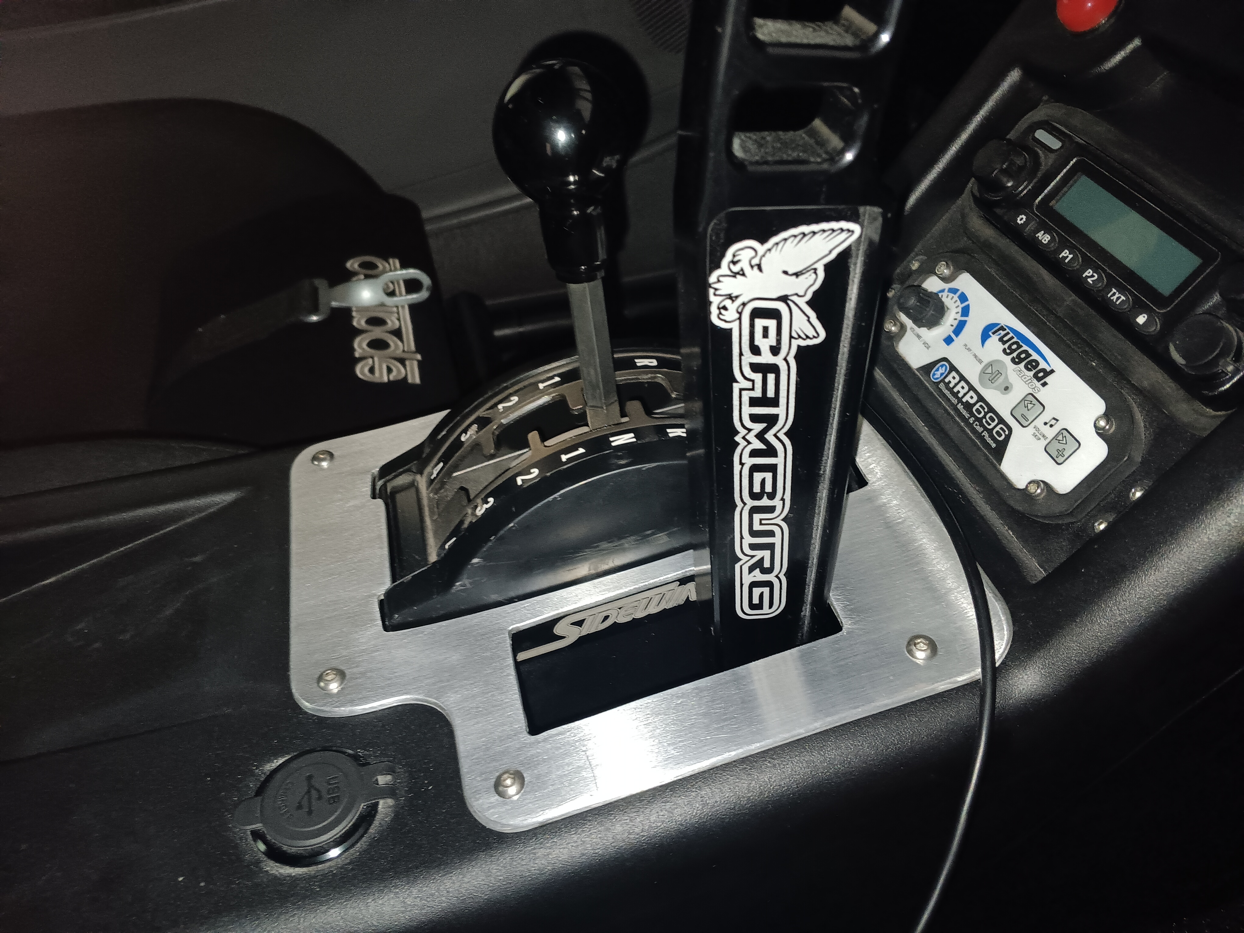

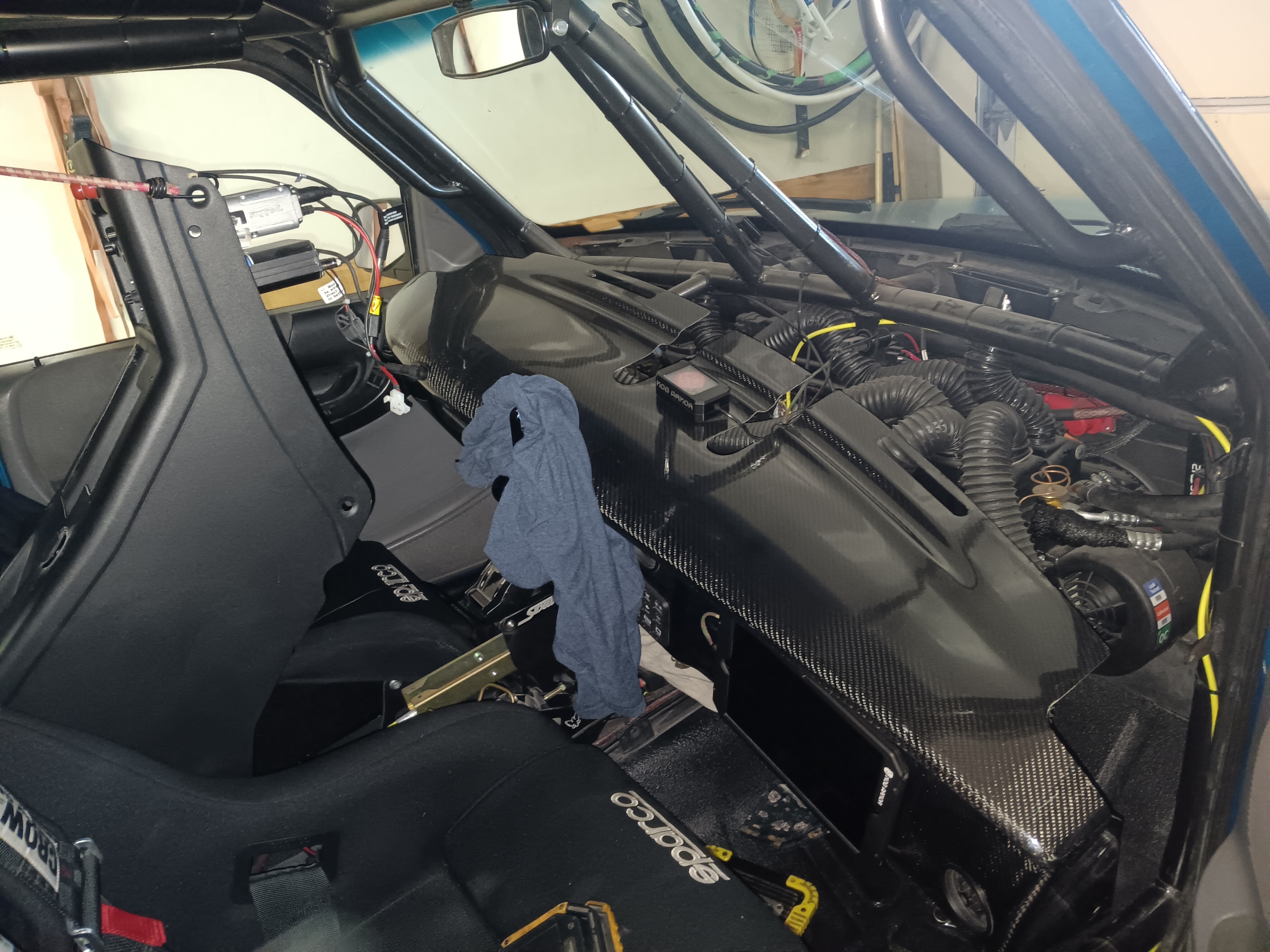

made relief cut longer for hoon handle in center console, because if you really cranked hard on it before, you could get it to hit. I might try to sandwich a piece of leather with slit in it to finish it off and hide that big hole...
SHIT>> this pic just made me realize truck is still in neutral from tighening pinion nut! doh!

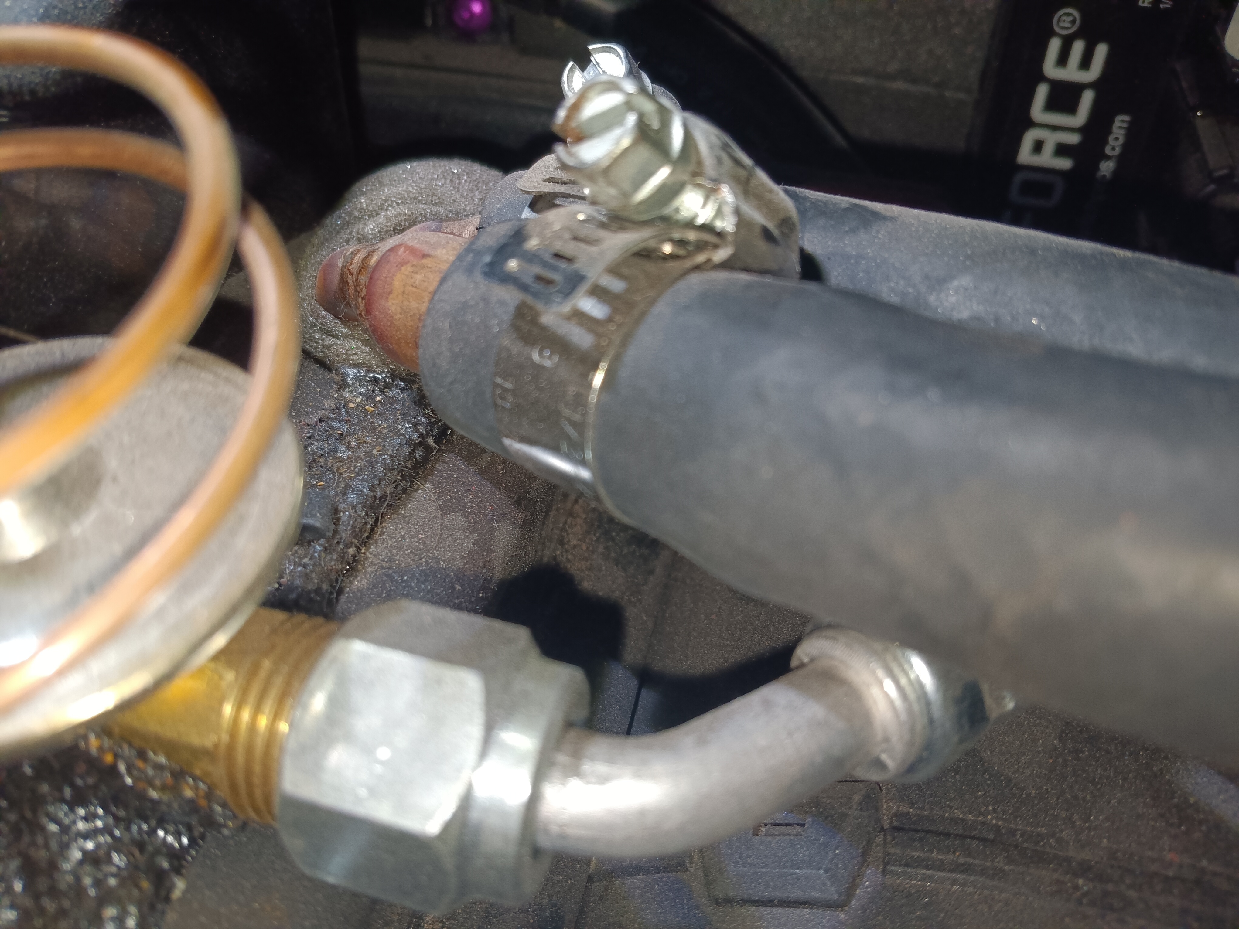

Wasn't looking forward to fixing the heater core leak issue.... because I had to pull console and dash to get access.
Think I fixed it by just tightening hose clamps more. (face palm) So, heater and everything is hooked back up. Gonna recharge AC and see if it works.
pretty sure it was this juan...

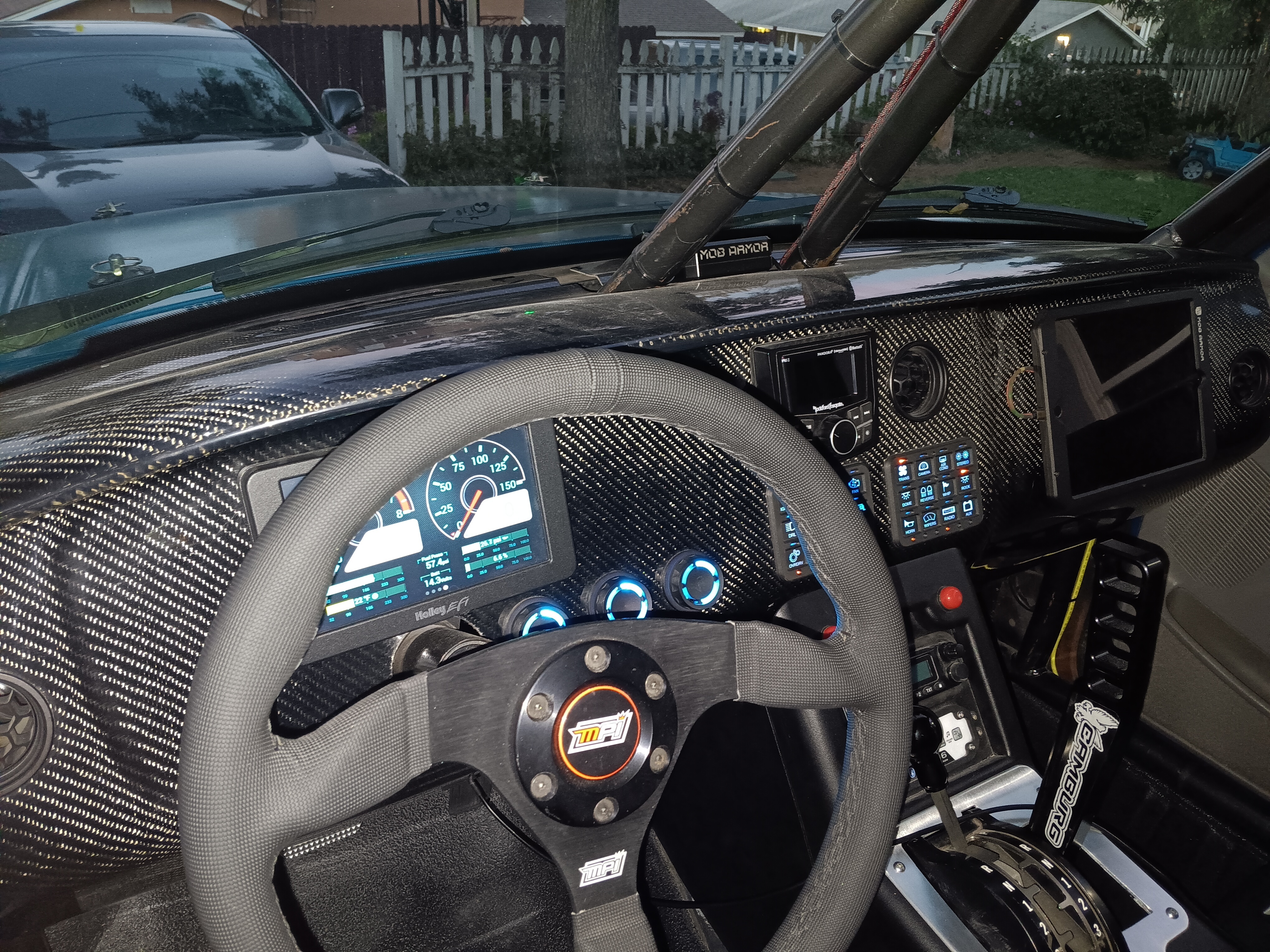

then after re-install and opening SwitchPro app ... somehow the color background got lost on switch A. And now the color selector in app was different... so had to recalibrate the stupid colors on both switches again. I try my best to match the AC control color..

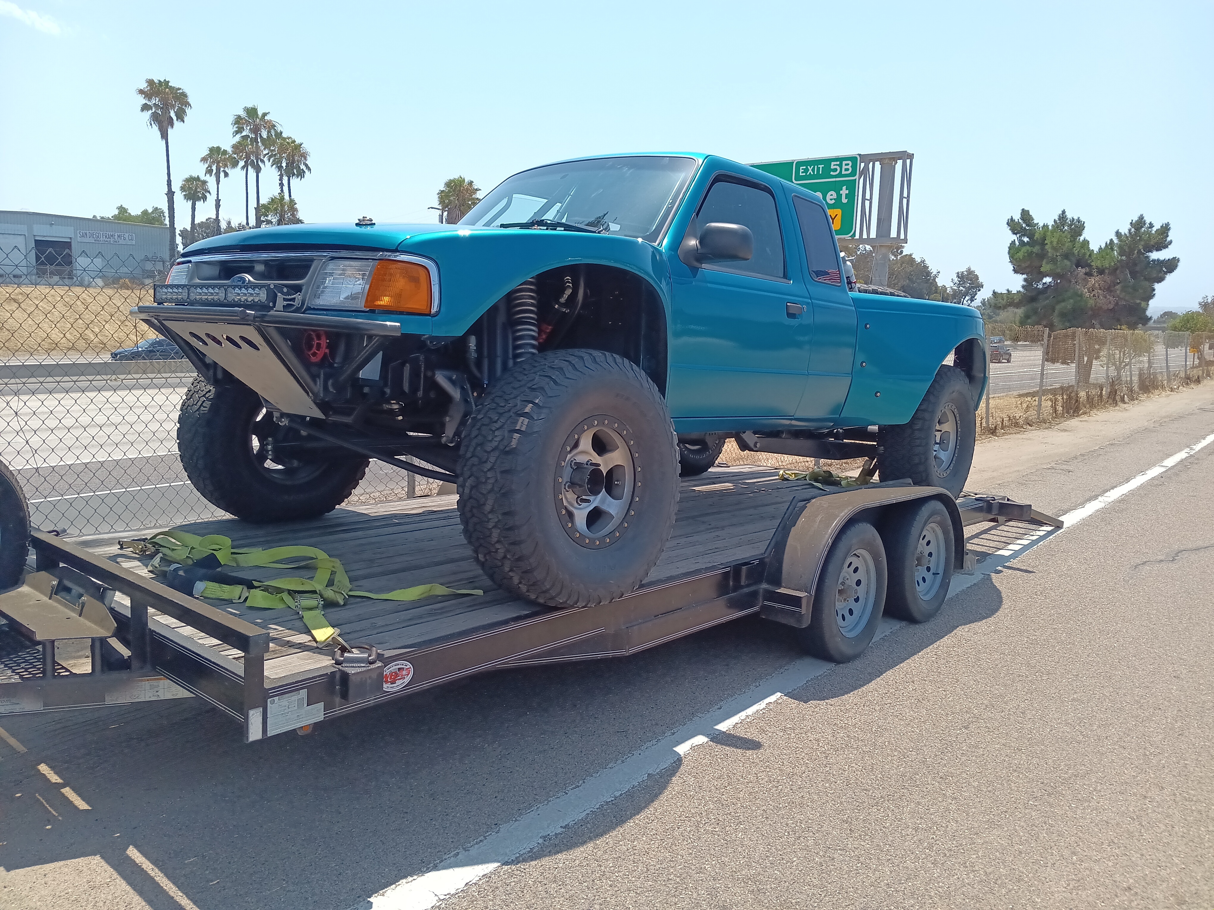

And, Ranger is gonna have to work! Thing barely fits on trailer and in garage as it is.
