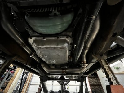

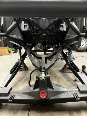

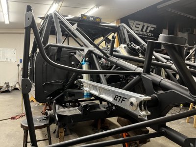

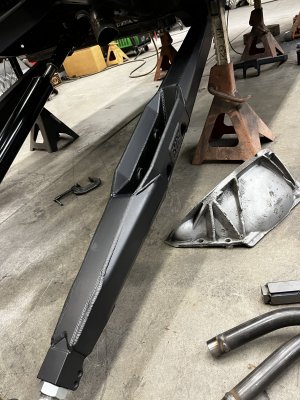

This is the first pair of this style trailing arm for us, I’m pretty happy with these ones. We’ve done a few versions and never was really happy with any of them aesthetically. These ones I like. The upper link Travis made and Dane welded. That took way too many hours, but it’s cool. And here’s the exhaust, all stainless tube, tig welded, y piped to one muffler since dual would’ve been almost impossible with the transfer case in the way. Trying to keep up with all the cool guy builds with his truck. Lord knows I can’t afford one like this. Haha

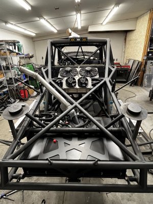

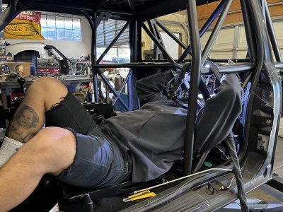

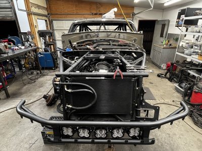

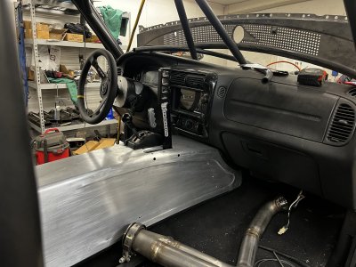

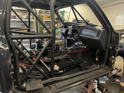

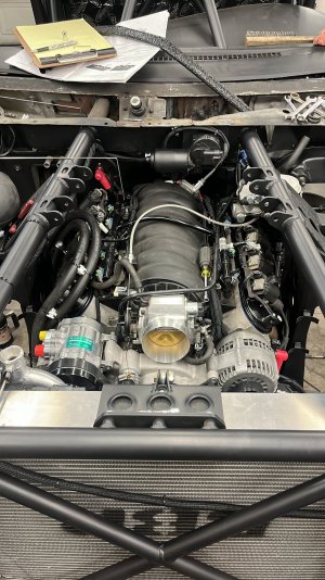

Custom evaporator core box done along with custom lines etc. hopefully we put enough fan in there to make it work. It’s all kind of an experiment! Fuel cell powdercoated and in, most of the plumbing is done, manual “conversion” done on the transfer case, it’s a bit crowded since he wanted a hoon handle too. Travis did a great job on the console though.
Yes, that’s his exhaust sitting on the floor. Lol.
