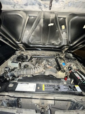

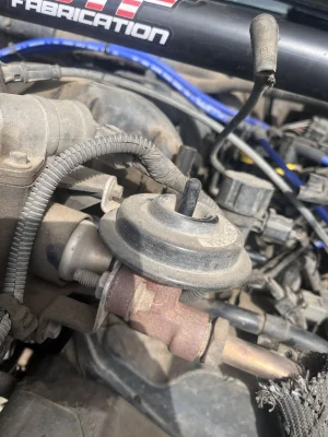

Alright guys I was just mobbin an I took a pretty decent hit on the passenger side took it fine but immediately I noticed it wasn’t runnin right! Almost sounded like there was an exhaust leak but it definitely isn't running right! My reader is saying that Bank 1 an 2 are lean an misfiring!! I also have all emissions deleted egr vapor canister vacuum ETC, Checked everything an it’s all plugged in! I’m trippin on how it would happen from that! Where I live I can take it out right by the house so I’m rippin around all the time never had a problem! Replaced all the plug wires an coil pack just last year! Has anyone ever had this issue!

vacuum line on bottom of throttle body come off. any of the intake nuts and bolts come loose?
