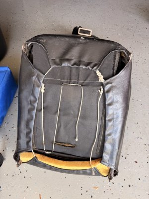

- Cinched down the cords under the PRP seats/replaced broken cords with paracord. Hopefully this keeps me from sagging too low and curving my back on long drives.
- Rebuilt passenger front bumpstop
